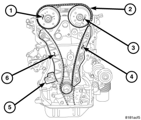

Here are the directions for replacing the timing chain on a 2.4L The attached pictures correlate with the directions.
________________________________-
2007 Dodge Caliber L4-2.4L VIN K
Removal - Timing Chain
Vehicle Engine, Cooling and Exhaust Engine Timing Components Timing Chain Service and Repair Removal and Replacement Timing Chain Removal - Timing Chain
REMOVAL - TIMING CHAIN
TIMING CHAIN

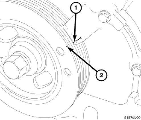

pic 1
1. Set engine to TDC.
2. Remove timing chain cover.

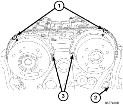

pic 2

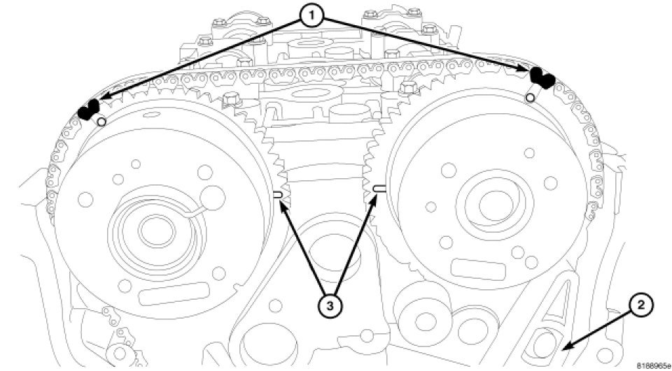

NOTE: If the timing chain plated links can no longer be seen, the timing chain links corresponding to the timing marks must be marked prior to removal if the chain is to be reused.
3. Mark chain link (1) corresponding to camshaft timing mark.

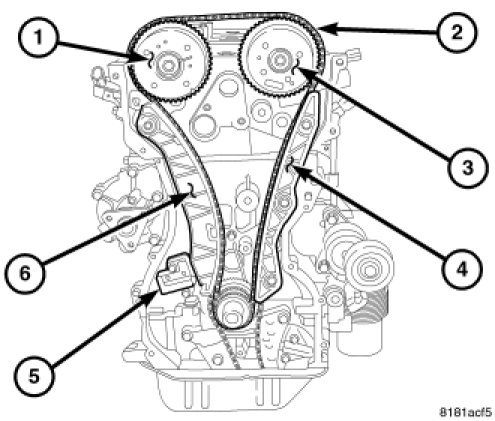

pic 3
4. Mark chain link (3) corresponding to crankshaft timing mark (2).

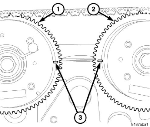

pic 4
5. Remove timing chain tensioner (5).
6. Remove timing chain (2).

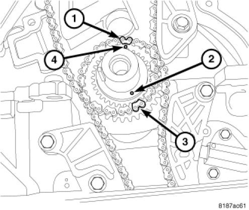

pic 5
1. Verify that the crankshaft sprocket keyway is at the 9 o'clock position.

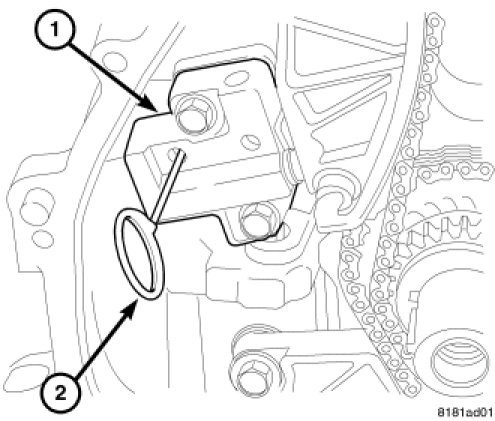

pic 6
2. Align camshaft timing marks (3) so they are parallel to the cylinder head and aligned each other as shown.

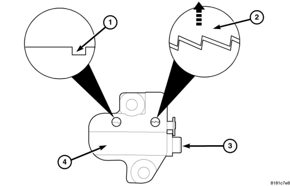

7. Reset timing chain tensioner (4) by lifting up on ratchet (2) and pushing plunger (3) inward towards the tensioner body (4). Insert Tensioner Pin 8514 into slot (1) to hold tensioner plunger in the retracted position.
pic 12
8. Install timing chain tensioner (1) and tighten bolts to 12 Nm (105 in. lbs.).
9. Remove timing Tensioner Pin 8514 (2).
