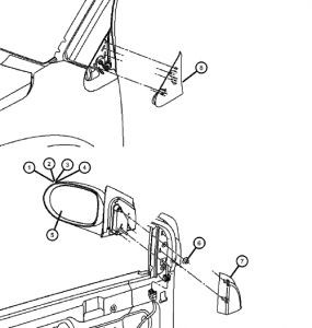

I broke off the drivers side mirror- it is now hanging (by some handy duck tape) but will need replaced- How do I completely remove the old mirror and put the new one on?

remove the door panel and the triangluar plastic trim then remove bolts to replace side mirror assembly.
https://images.2carpros.com/forum/automotive_pictures/261618_1_187.jpg
