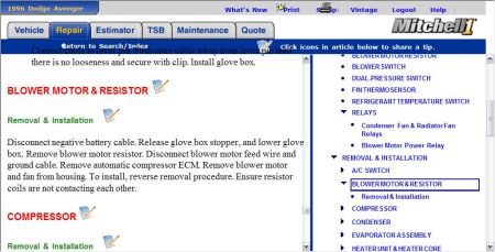

Where exactly is my heater motor located under the dash board, please be real specific, im not a car genius thanx

Follow instructions below its behind the glove box
https://images.2carpros.com/forum/automotive_pictures/12900_blower_motor_1.jpg
