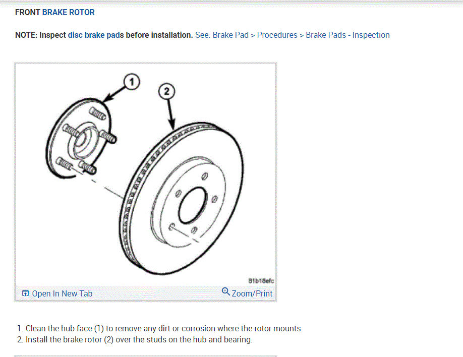

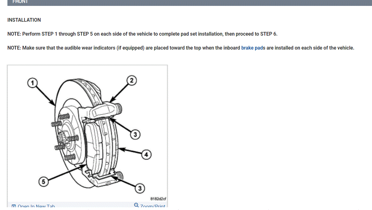

my car grind when coming to stop I need to change the brakes out can you help me please?

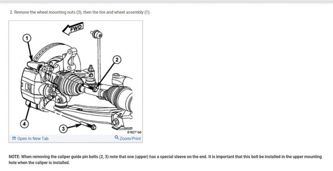

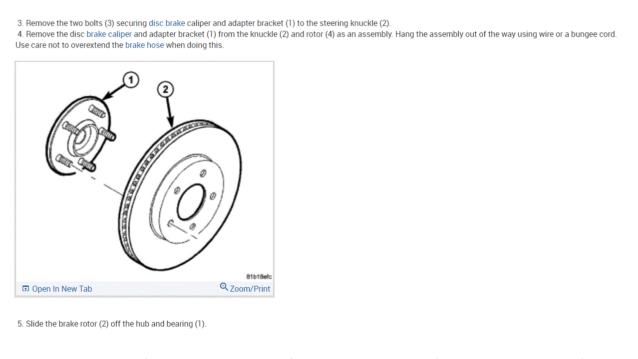

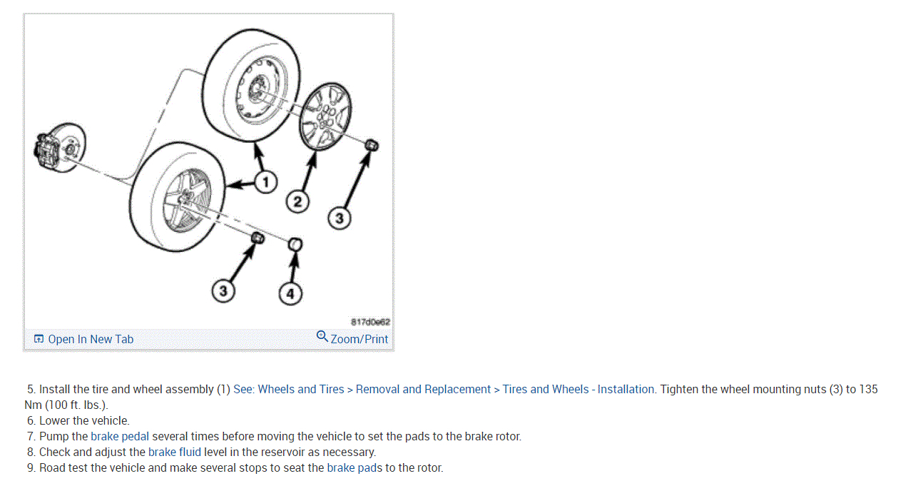

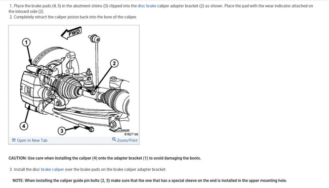

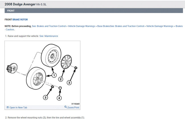

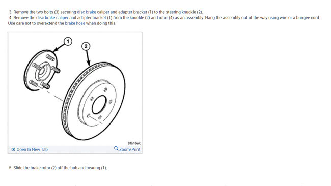

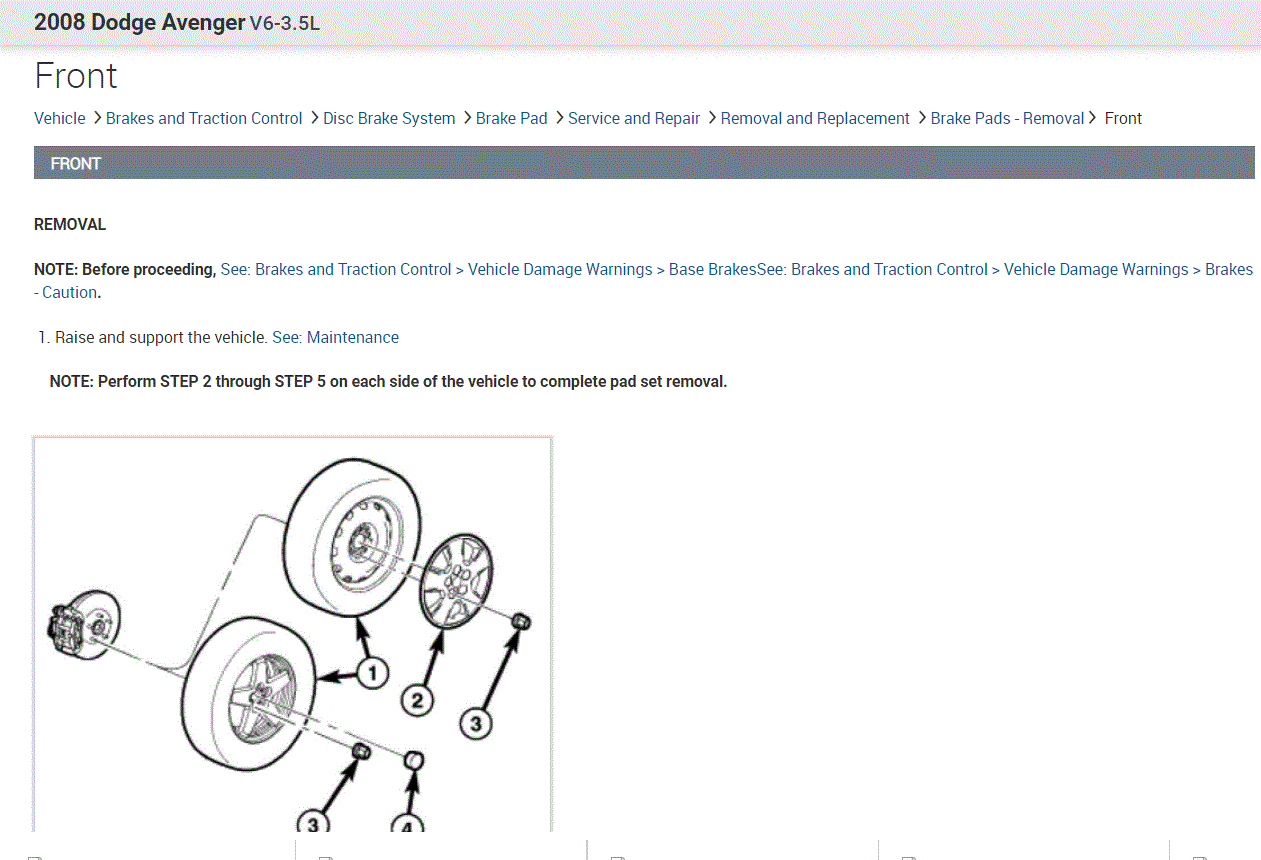

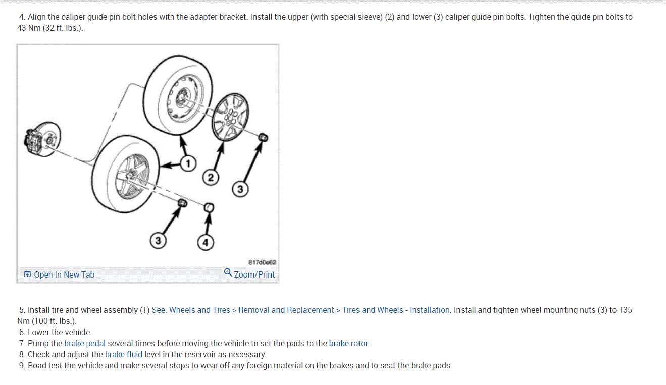

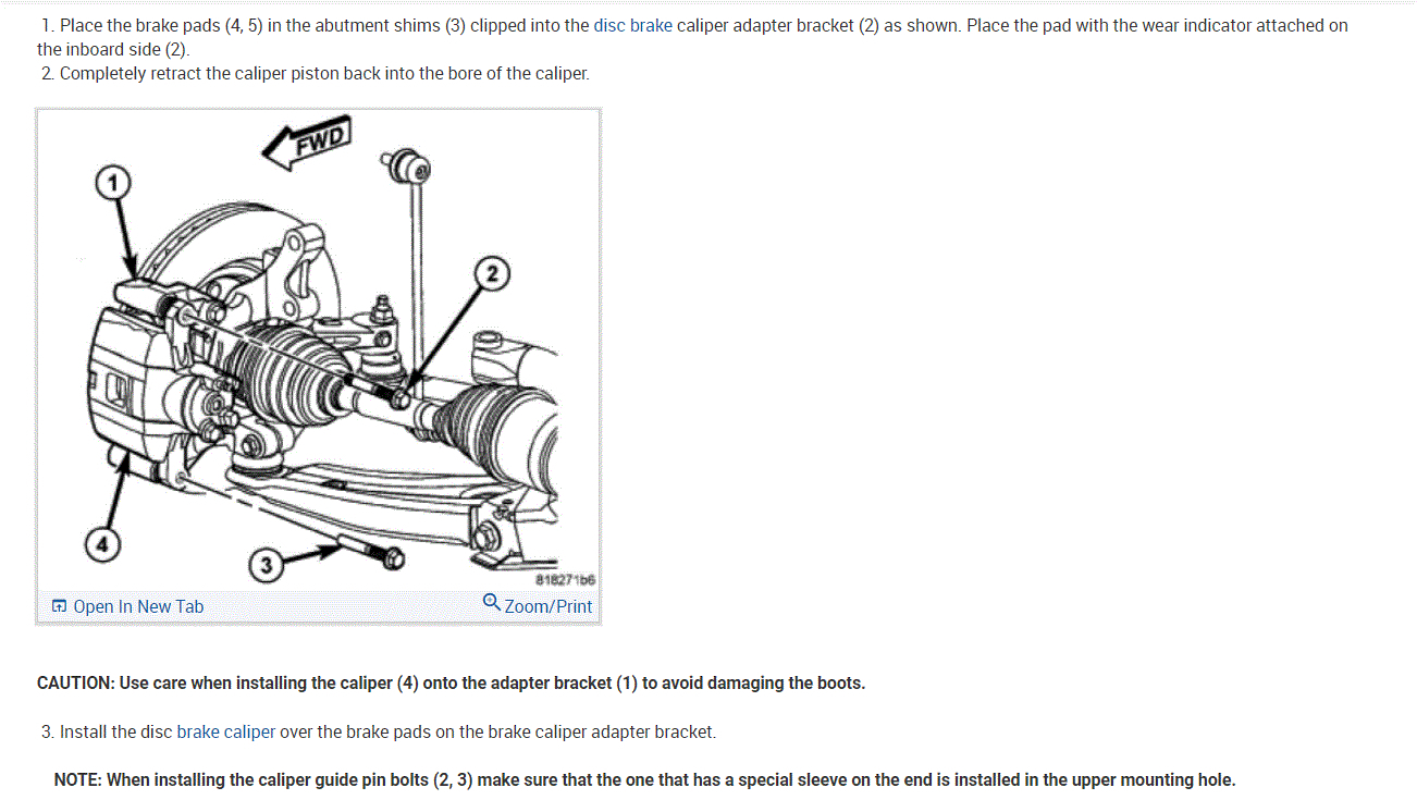

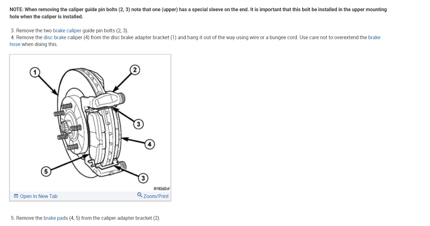

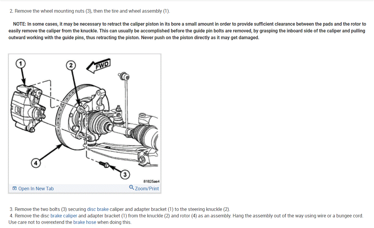

Replacing front brake pads and rotors really isn't too hard to do. If you do it yourself, make sure to get lifetime parts so you never have to pay for them again. Here is a guide to help you step by step with instructions in the diagrams below to show you how on your car.
If you look at the pics below, they include the directions and pictures specific to your vehicle for this job. Also, here is a video of the procedure being done on a Chrysler PT Cruiser. Although it is a different model, the procedure is very similar.
