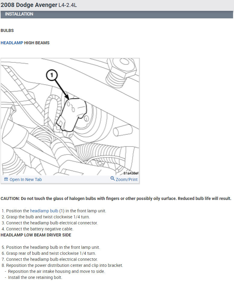

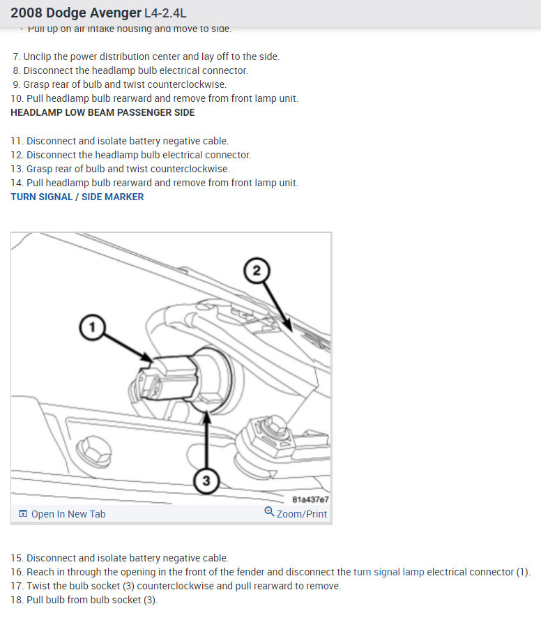

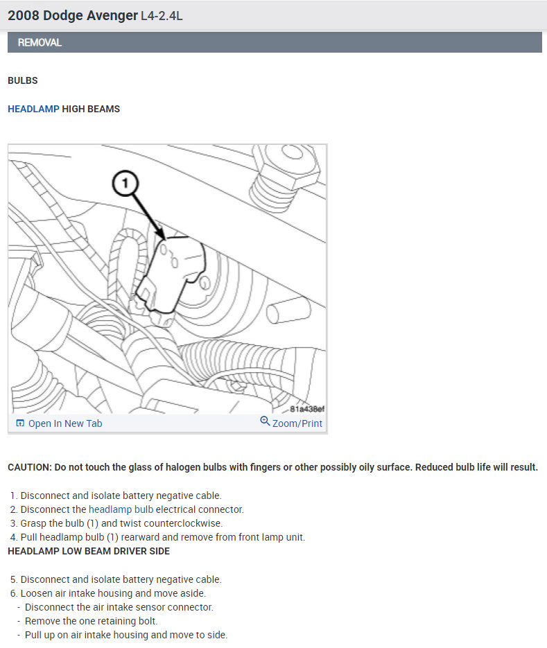

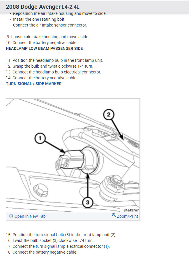

https://www.2carpros.com/articles/how-to-replace-a-headlight-bulb
I have also included the headlight bulb replacement procedure for your vehicle.
