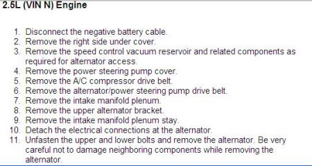

How do I remove the alternator?

https://images.2carpros.com/forum/automotive_pictures/170934_alternator_2.jpg
Notice the vin, sometimes these databases don't give the easiest or best way. You have to use your own initiative.
