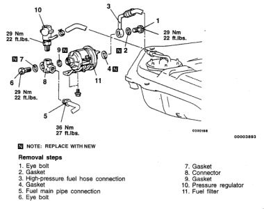

Where our they located on the car?
Sunday, May 23rd, 2010 AT 4:57 PM
10 Replies
  • 75,992 POSTS
https://www.2carpros.com/forum/automotive_pictures/12900_ff_13.jpg
The fuel filter is located on the frame rail, near the fuel tank.

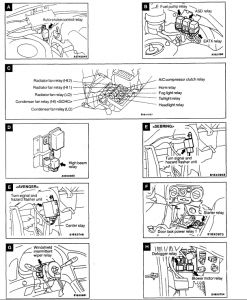

Relay Locations Views A - H
https://www.2carpros.com/forum/automotive_pictures/12900_fpr_13.jpg
Fuel Pump Relay - Picture B

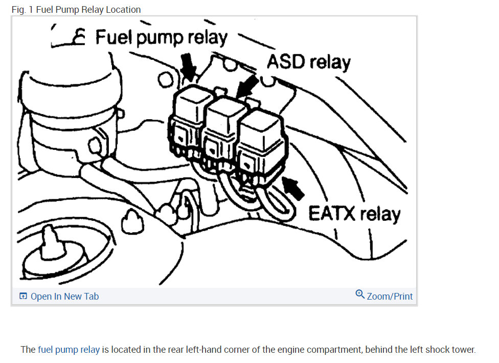

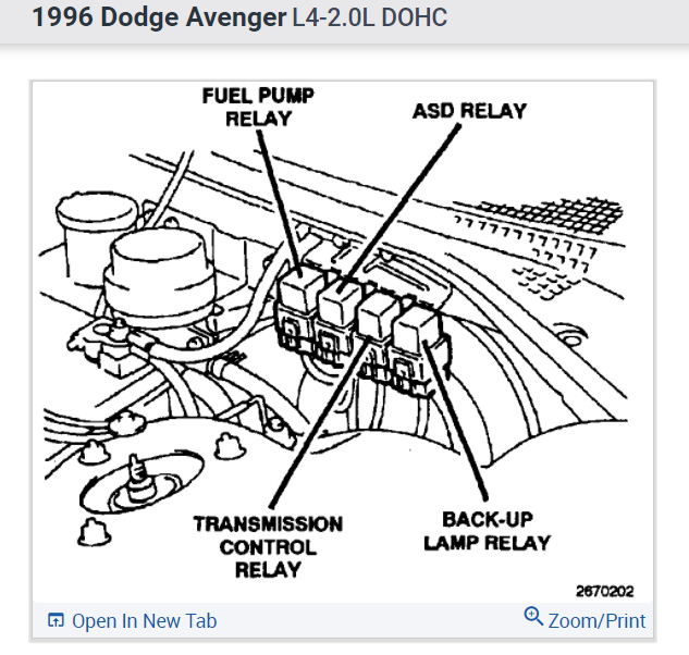

I was wondering where te fuel pump relay switch was on a 1996 Dodge Avenger?
-1
Tuesday, September 29th, 2020 AT 11:15 AM (Merged)
  • 75,992 POSTS
Here is a guide to help you check the relay witht he fuel pump relay in the diagrams below.
+4
BIGTYTY2009
Ok is it on the engine side of the firewall or on the other side
  • 75,992 POSTS
I'll check on the firewall as illustrated in the diagram first
