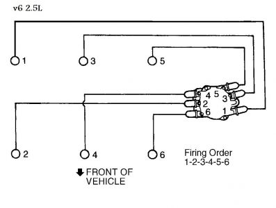

The service engine light showed up after an emissions test. After hooking it up to a computer it says Cylinder #2 misfire. Code # P0302
I just bought this car..can you please number the cylinders for me so that I can troubleshoot?

need engine size this one is for 2.5l let me know
https://images.2carpros.com/forum/automotive_pictures/99387_25_dodge_1.jpg

that's my engine.
