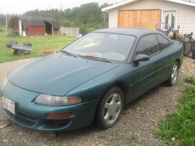

scan and reading misfire misfire all plug 97 dodge avenger 2.4l 4cyl.. change coil ,plugs and wire,clean throttle body same problem all the time please help

nice car, ok, you've covered all that. now you should check a couple of simple things, and all these cause a misfire, check/change air filter, pcv valve, and intake manifold gasket,/vacuum leaks.
