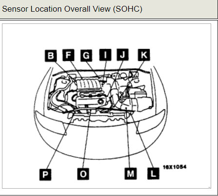

cant figure out the problem, car stalled now wont start.Check engine light doesn't light up during start, cant seem to get spark or fuel, tried changing fuel pump, relay, distributor, cap and rotor, computer, all fuses, not sure where else to look, rolls over fine, just wont start

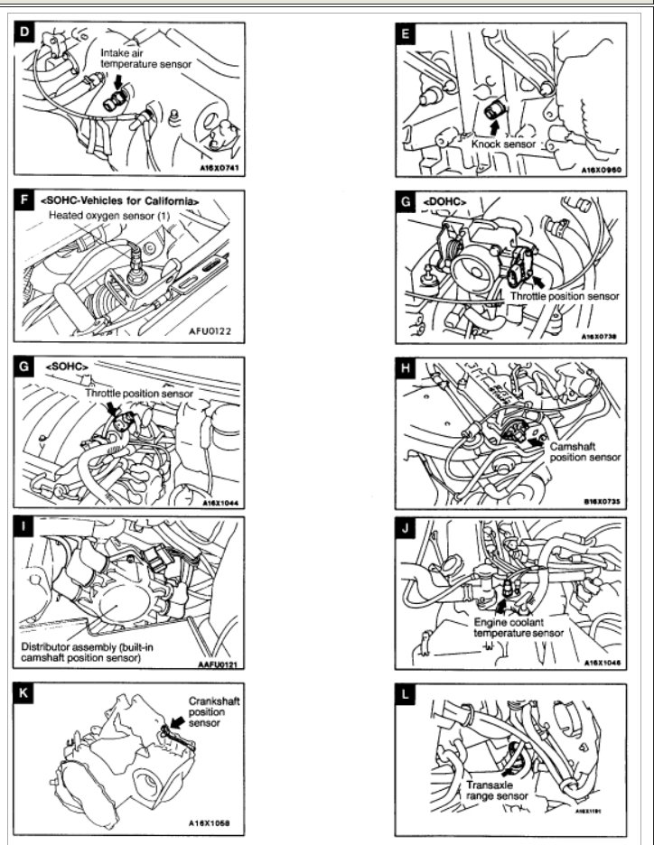

This sounds like you have a crankshaft angle sensor that is out. Here is a guide to who you what you are in for when doing the job.
this guide can help as well.
Please run some tests and get back to us.
