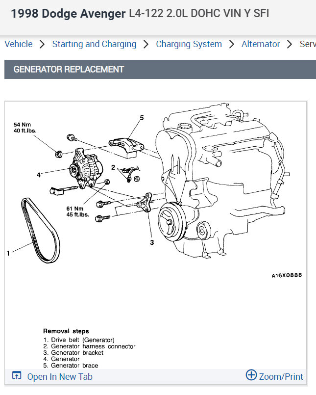

how do you take out the alternator? how do you take a alternator out of a 1998 dodge avenger v6 with 158893 miles?
Dec 2, 2007 at 11:12 AM
Experienced Mechanic
55,628 POSTS

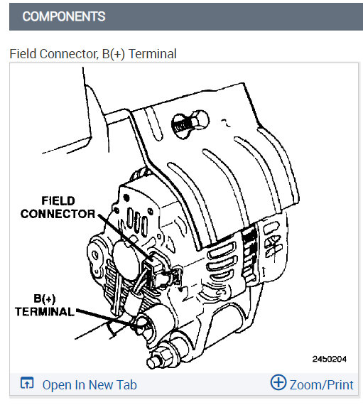

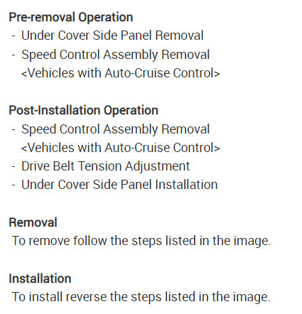

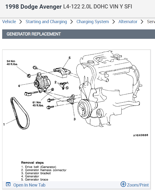

It is best if you can raise the car up which this guide can help you with:
Then disconnect the battery on the negative cable, here is a generic guide to help you step by step with instructions in the diagrams below to show you how on your car.
https://www.2carpros.com/articles/how-to-replace-an-alternator
Check out the images (below). Let us know if you need anything else.
