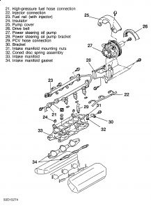

Hi I am just wondering where the fuel pressure regulator is on a 1996 dodge avenger es. I believe i seen one down by the fuel filter but not sure. I looked all over on the fuel rail and fuel lines and cant find one. I have never had to change on before so Im not sure where to look. If anyone can help I would be very grateful. Thank you in advance.

Hello Item number 6 on the pic

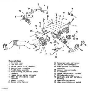

This pic looks like its the 2.0L 4 cylinder. The 2.5 does not have a fuel rail service port for checking fuel pressure you need a special adaptor for it. The way mine is on the car is once the fuel line hits the fuel rail it travels in a "U" shape from the rear to the front and just stops. I can not see anything that resembles something like a regulator at the end. I know where the 3.1 I thinks its 3.1 is and the 2.0 but my manuel says nothing about where it is on the 2.5. But i will recheck it just incase but please reply if it is somewhere else. Thank you for your help and I am sure we will figure it out lol ( If we have not already do to my "ignorance" however its spelt. Thank you again. If i need to post a pic of what my fuel rail looks like I will post one.

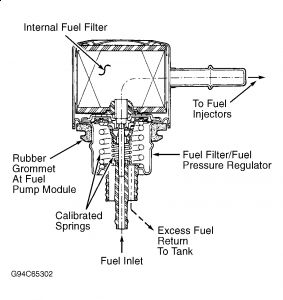

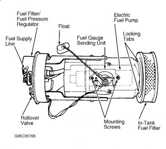

Hello - Thanks for the info............. Okay my friend......it looks like it is in the fuel tank and part of the pump. See below. Is this what your rail looks like
https://images.2carpros.com/forum/automotive_pictures/248015_1_176.jpg
https://images.2carpros.com/forum/automotive_pictures/248015_2_119.jpg
Fuel Pressure Regulator Fuel pressure regulator is a mechanical device, used to maintain a constant pressure across fuel injector tip. Spring and rubber diaphragm will move from an open to closed position keeping fuel pressure constant. Excess fuel is returned to fuel tank. Regulator may be located on fuel injector rail, outside fuel tank (between tank and rear of vehicle), or with in-tank fuel pump module. On regulators located in fuel pump module, regulator includes an internal fuel filter. Excess fuel is routed directly into fuel tank without using a return line. See Fig. 2 . Fig. 2: Cross-Sectional View Of In-Tank Fuel Filter/Fuel Pressure Regulator (Typical) Courtesy of CHRYSLER CORP.

In-Tank Fuel Pump Fuel pump is a positive displacement, immersible pump with a permanent magnet electric motor. Fuel is drawn in through a separate filter/strainer at bottom of fuel pump and pushed through filter to fuel outlet line (to fuel injectors). Voltage to operate pump is supplied from fuel pump relay. On some models, fuel pump relay is activated by ASD relay. On some models, a fuel pump module may include a combination fuel filter/fuel pressure regulator, fuel pump reservoir, a separate in-tank fuel filter, pressure relief/rollover valve, fuel gauge sending unit and fuel supply line. See Fig. 3 . Fig. 3: Identifying Fuel Pump Module Components (Typical) Courtesy of CHRYSLER CORP.

Well this is exactly what my fuel rail looks like. I had called on the recall but they told me there were not any recalls for my vin. But thank you again for the idea to call on that. Also if anyone has read my hesitation question I had a month or two back this is where I am right now on this problem. As far as checking the regulator goes i am almost sure its shot. Once I have figured it out I will post what the problem was. Thank you again and great job ImpalaSS your awsome.
