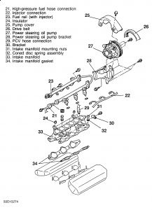

Hi I am just wondering where the fuel pressure regulator is on a 1996 dodge avenger es. I believe i seen one down by the fuel filter but not sure. I looked all over on the fuel rail and fuel lines and cant find one. I have never had to change on before so Im not sure where to look. If anyone can help I would be very grateful. Thank you in advance.
Aug 30, 2009 at 12:25 PM
IMPALASS
  • 3,112 POSTS
Hello Item number 6 on the pic
https://images.2carpros.com/forum/automotive_pictures/248015_1996_Avenger_Fuel_1.jpg
Please let us know if what the final fix was for your car so we can better assist others. Thanks!

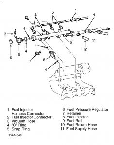

This pic looks like its the 2.0L 4 cylinder. The 2.5 does not have a fuel rail service port for checking fuel pressure you need a special adaptor for it. The way mine is on the car is once the fuel line hits the fuel rail it travels in a "U" shape from the rear to the front and just stops. I can not see anything that resembles something like a regulator at the end. I know where the 3.1 I thinks its 3.1 is and the 2.0 but my manuel says nothing about where it is on the 2.5. But i will recheck it just incase but please reply if it is somewhere else. Thank you for your help and I am sure we will figure it out lol ( If we have not already do to my "ignorance" however its spelt. Thank you again. If i need to post a pic of what my fuel rail looks like I will post one.
Aug 31, 2009 at 3:11 PM
IMPALASS
  • 3,112 POSTS
Hello - Thanks for the info............. Okay my friend......it looks like it is in the fuel tank and part of the pump. See below. Is this what your rail looks like

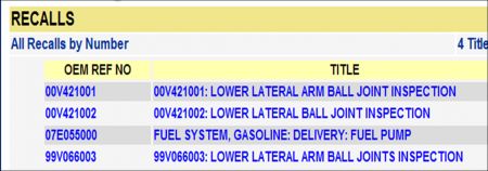

Hello - Also, it looks like you may have some recalls on your vehicle. The dealer may fix these for free. Please contact the dealer service department, give them the VIN number of your car and have them check on these to see if they apply to you.
https://images.2carpros.com/forum/automotive_pictures/248015_Recall_24.jpg
If you notice one is about the fuel pump. I have expanded that and put that below for your review. VEHICLE DESCRIPTION Model(s): 1994 MITSUBISHI GALANT 1995 CHRYSLER SEBRING 1995 DODGE AVENGER 1995 EAGLE TALON 1995 MITSUBISHI ECLIPSE 1995 MITSUBISHI ECLIPSE SPYDER 1995 MITSUBISHI GALANT 1996 CHRYSLER SEBRING 1996 DODGE AVENGER 1996 EAGLE TALON 1996 MITSUBISHI ECLIPSE 1996 MITSUBISHI ECLIPSE SPYDER 1996 MITSUBISHI GALANT 1997 CHRYSLER SEBRING 1997 DODGE AVENGER 1997 EAGLE TALON 1997 MITSUBISHI ECLIPSE 1997 MITSUBISHI ECLIPSE SPYDER 1997 MITSUBISHI GALANT 1998 CHRYSLER SEBRING 1998 DODGE AVENGER 1998 EAGLE TALON 1998 MITSUBISHI ECLIPSE 1998 MITSUBISHI ECLIPSE SPYDER 1998 MITSUBISHI GALANT 1999 CHRYSLER SEBRING 1999 DODGE AVENGER 1999 MITSUBISHI ECLIPSE 1999 MITSUBISHI ECLIPSE SPYDER 2000 CHRYSLER SEBRING 2000 DODGE AVENGER Campaign No: 07E055000 Number of Affected Vehicles: 222 Beginning Date of Manufacture: NO DATE Ending Date of Manufacture: NO DATE SYSTEM FUEL SYSTEM, GASOLINE: DELIVERY: FUEL PUMP DESCRIPTION OF DEFECT CERTAIN AIRTEX FUEL PUMP MODULE ASSEMBLIES, P/N E7081H, SOLD FOR USE AS REPLACEMENT EQUIPMENT FOR THE VEHICLES LISTED ABOVE. THE WALL OF THE FLARED FITTING OF THE FUEL PUMP IS NOT THICK ENOUGH TO PREVENT THE MATING THREADED FITTINGS FROM BOTTOMING OUT BEFORE AN ADEQUATE SEAL IS ACHIEVED. THIS CONDITION MAY RESULT IN LEAKAGE OF FUEL AT THE CONNECTION OF THE VEHICLE FUEL LINE AND THE FUEL PUMP MODULE ASSEMBLY. CONSEQUENCE OF DEFECT IN THE PRESENCE OF AN IGNITION SOURCE, A FUEL LEAK COULD RESULT IN A FIRE. CORRECTIVE ACTION AIRTEX WILL NOTIFY OWNERS AND REPLACE THE FUEL PUMPS FREE OF CHARGE. THE RECALL IS EXPECTED TO BEGIN DURING JULY 2007. OWNERS CAN CONTACT AIRTEX AUTOMOTIVE AT 800-880-3056. ADDITIONAL INFORMATION The National Highway Traffic Safety Administration operates Monday through Friday from 8:00 AM to 4:00 PM, Eastern Time. For more information call (800) 424-9393 or (202) 366-0123. For the hearing impaired, call (800) 424-9153.
Aug 31, 2009 at 10:09 PM
AVENGERWEEZEL77
  • 38 POSTS
Well this is exactly what my fuel rail looks like. I had called on the recall but they told me there were not any recalls for my vin. But thank you again for the idea to call on that. Also if anyone has read my hesitation question I had a month or two back this is where I am right now on this problem. As far as checking the regulator goes i am almost sure its shot. Once I have figured it out I will post what the problem was. Thank you again and great job ImpalaSS your awsome.
