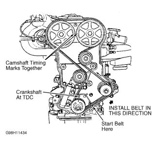

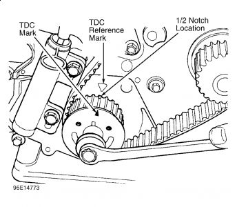

1996 Dodge Avenger timing
GERARD111
Engine Mechanical problem
1996 Dodge Avenger 6 cyl Front Wheel Drive Automatic
well i changed the water pump and when i took the tensioner off the camshaft moved i was wondering is there a way to reposition the camshaft or just reset the whole timing and if there are markings to show me where to position the camshafts
