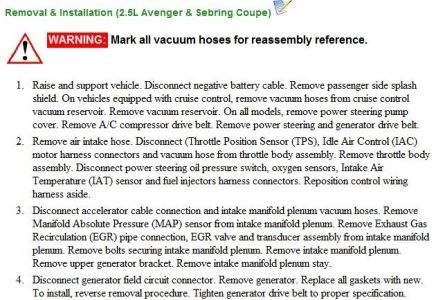

where is the altanator located and what is involved in replacing it.

https://images.2carpros.com/forum/automotive_pictures/261618_Noname_2032.jpg
