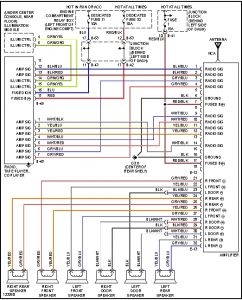

The sound from the stock radio system will cut in and out. We know the car is wired with the infinity system. We are trying to install a new radio. We get power but no sound. All speakers are wired up but cannot figure out why we cannot get sound. We have been trying to get the wiring scamatics with no luck. Can you help and do you have any suggestions?

https://images.2carpros.com/forum/automotive_pictures/261618_Noname_2030.jpg
