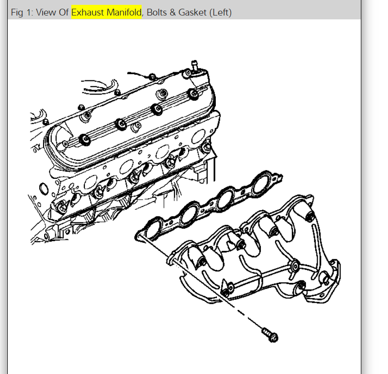

Should I replace manifold gasket or just broken screw?
Jul 13, 2019 at 7:51 AM
  • 55,399 POSTS
Both please, did you see the video? It shows what to do if the stud is broken.

Yes, thank you. I checked today how to remove stud, there is not so much space.
Jul 15, 2019 at 7:56 AM
  • 55,399 POSTS
It can be a little tight lets hope the stud is not broken just missing.

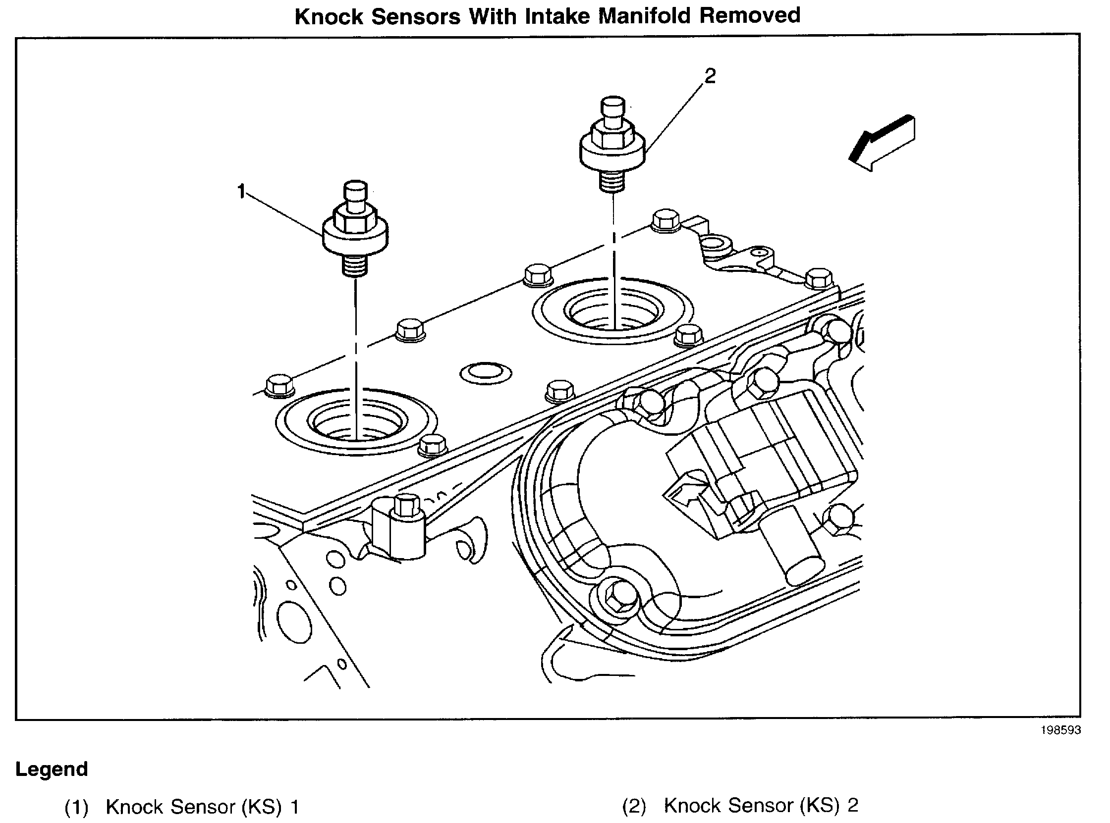

Hi Ken, I fixed manifold but still AFM not working. Have codes P0332-knock sensor 2 signal short, low. P0327- same with sensor 1. P1626-Anti theft system fuel enable circuit. What should I do? Thanks

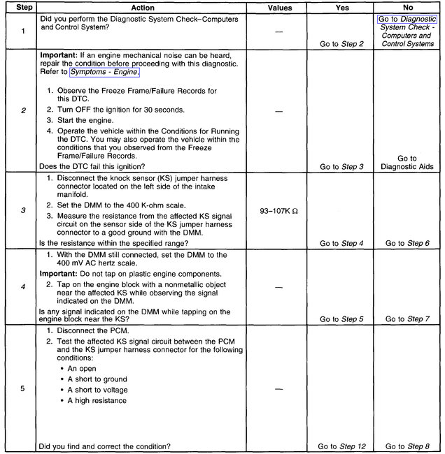

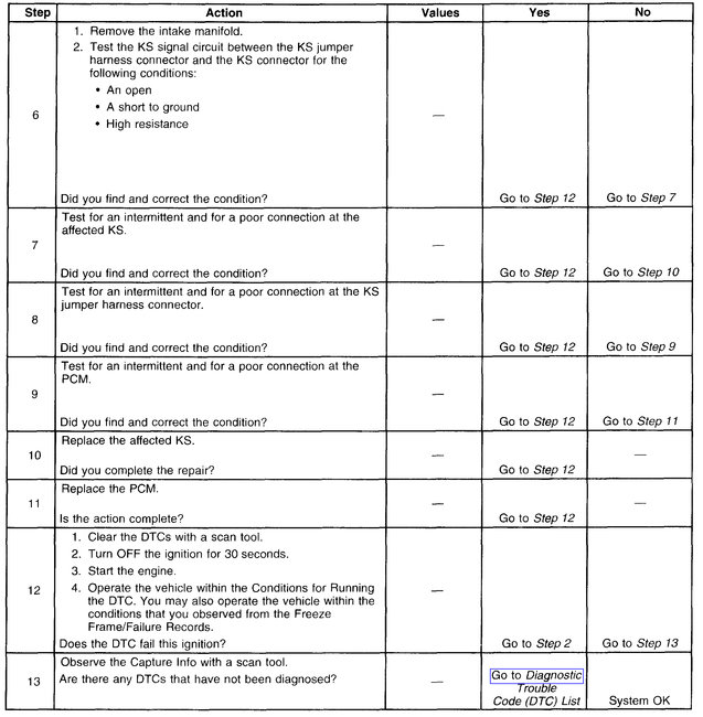

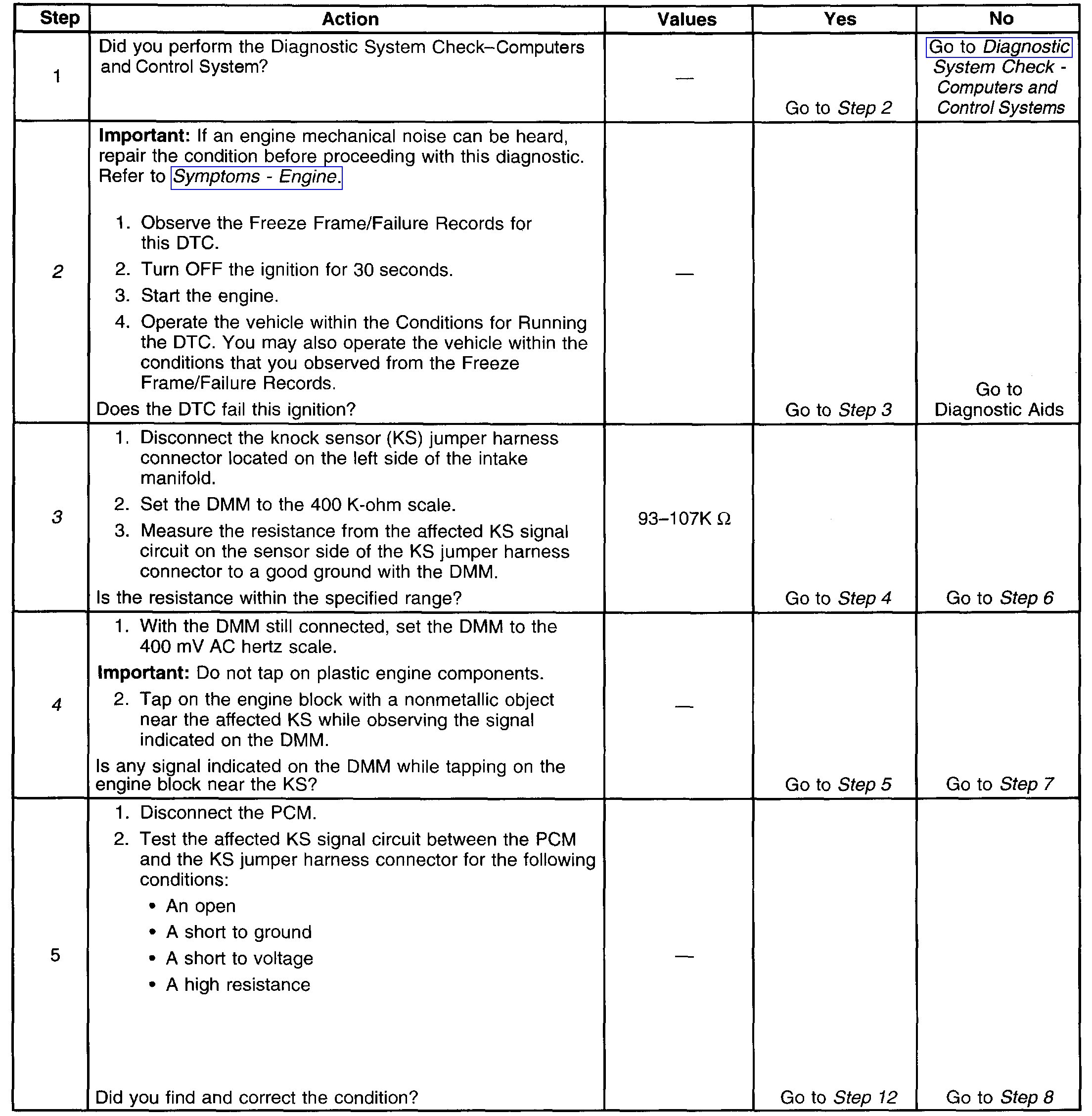

Welcome back. P0332 is the code for the rear knock sensor. I'll attach the test process but GM had a lot of issues with the knock sensors being faulty in those engines. Usually because crud and moisture get into the sensor connectors and around them. Normally if there is an issue with the wiring harness it will set codes for both of the sensors so it is more likely a bad sensor. My SOP is to replace both sensors and the jumper harness and then apply some sealer around the rubber grommets. To get to them you need to remove the intake manifold. The sensors are in the center cover.
This is a good video on the process:
https://www.youtube.com/watch?v=u6dZhKgeCSY

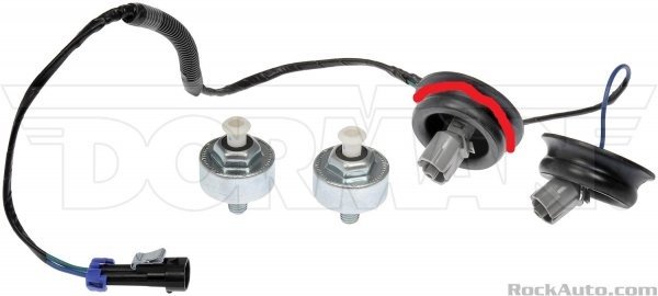

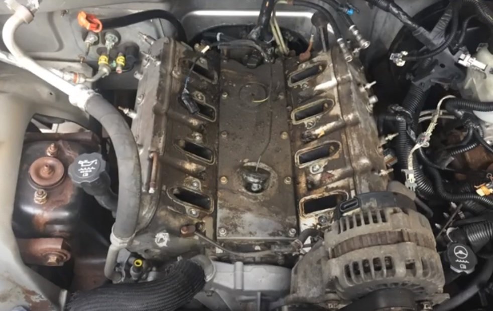

I found on Rrockauto Dorman set, is that company good? Sealer to use on rubber (red mark on picture)? Is there gasket under intake manifold, should I use new one?

I won't comment on whose parts are good or bad because I've had good and bad parts from everyone, both aftermarket and factory. I try to use factory parts whenever possible though.
For the sealer I have used silicone and Permatex. The idea is to keep crud from getting into the well around the sensors. Yes there are seals for the intake manifold that should be replaced when you remove it to prevent having an intake leak.

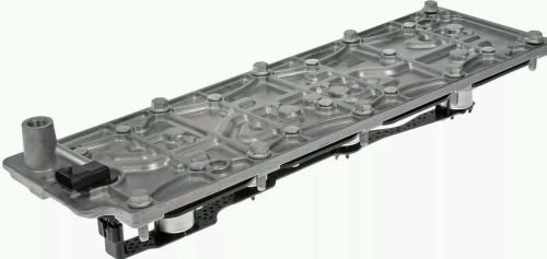

This is a 2004 with the 5.3 correct? What is the engine designation on the sticker under the hood? LM4 or LH6 I ask because GM didn't sell AFM on the 5.3 until late 2005.
Do you have the option under the trip meter to monitor the AFM system?
If you look at the cover under the intake manifold, is it smooth or does it have an electrical connector up next to the oil pressure sender and a lot of cast in oil passages?
If it has the connector it would be the first thing I would check for water intrusion. You can also test the system with a scan tool to see if it has been deactivated for another reason as listed below.

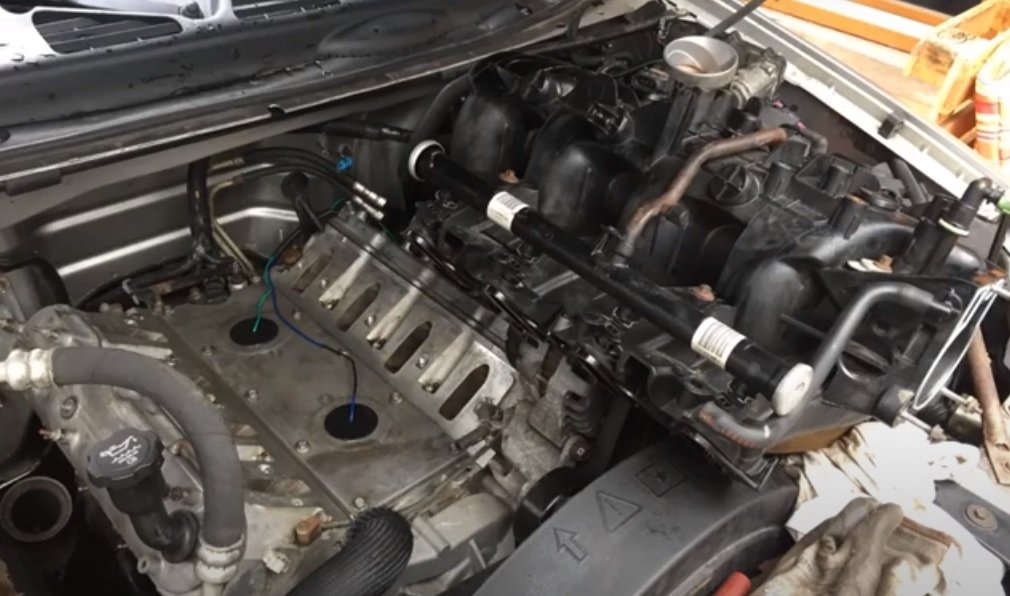

PAUL KREMER
  • 47 POSTS
Hi Ken, happy new year.
Your last question I do not understand? Cluster?
I add pictures maybe on picture you can show me?
If not possible on picture tell me please on video, on what time (seconds)
does it starts.

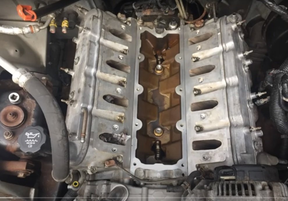

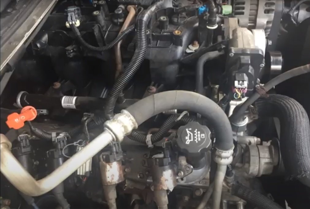

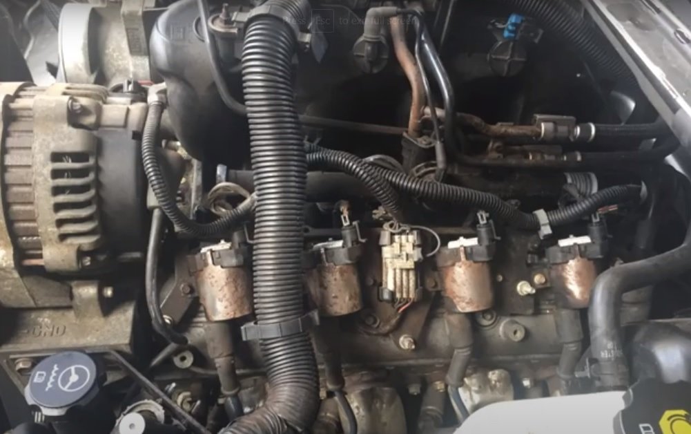

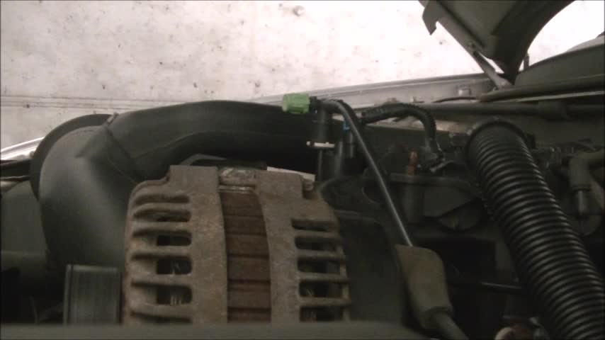

Pictures from last work, replacing knock sensors with wire.
Jan 23, 2021 at 3:30 AM
STEVE W.
  • 15,344 POSTS
I believe Ken was referring to the instrument cluster inside the car. It looks like there is an issue with at least the temperature gauge. If that is due to a short in a sensor it could stop the DOD from working. However the more common issue with those is the stepper motor that moves the needle.
As the DOD stopped working after the wash I would suspect a bad connector that got water in it and now it is sending a bad signal. However those can be difficult to find as it could be almost any sensor or connector on the engine. The P0332 code alone would stop it from working, but if that code isn't being set now that the sensors have been replaced (nice work there) then the next step would be to connect a scan tool and watch the various sensor signals to find the one that isn't reading where it should be. The list I posted earlier are the signals the system uses to operate, any of them could be the reason.

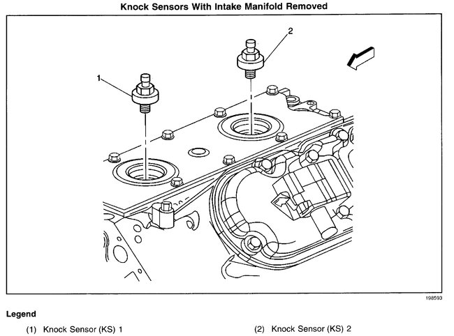

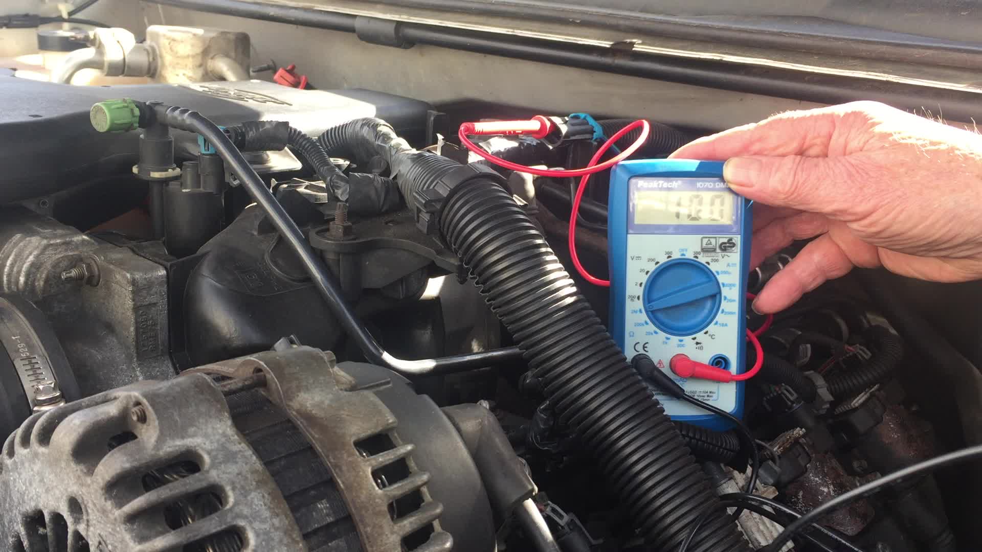

hello, I checked knock sensors, rear is not showing function. I have to remove again all that stuff. Why oil pressure sensor showing maximum? Engine noise?

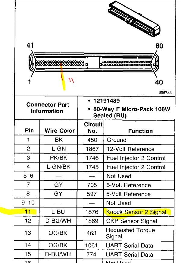

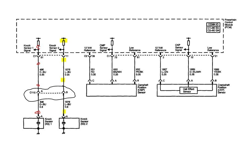

How did you test the sensor? I would test it at the wiring harness outside the engine as it's more likely a wiring issue if you replaced the sensors already. The oil pressure could be a bad sending unit, or a short in the wiring.
Apr 3, 2021 at 11:37 AM
PAUL KREMER
  • 47 POSTS
On video you can see how I did. To find right wire in wiring harness is not easy, especially when I don't know where to look. Should I check at ECM? Or you have wire diagram?
Thanks. Paul
Apr 10, 2021 at 6:16 PM
STEVE W.
  • 15,344 POSTS

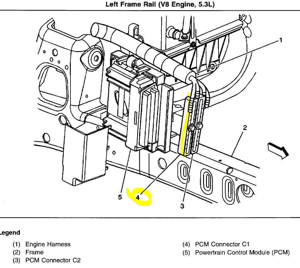

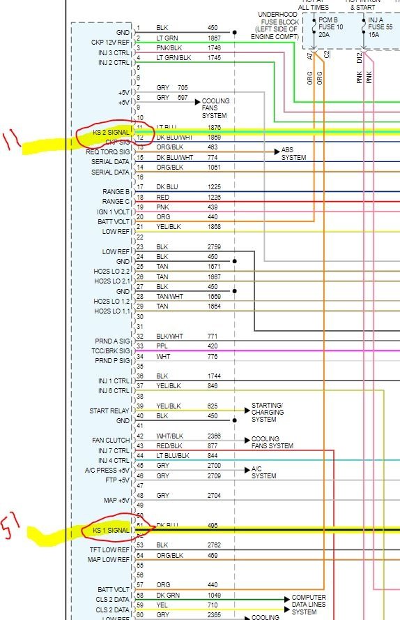

Okay, so you still have the P0332 code then but it seems the sensor itself works from your test. This started after washing the engine and there are a dew places water could get in. I believe you were testing in C115 which is the harness connector. As such you shouldn't need to take it apart again. Instead I would go to the PCM and test there. You should get the same results when you hit the block. Another test just to be sure would be to use a couple jumper wires and reverse the connections at connector C115, so that the rear sensor connects to the front wiring and the front sensor connects to the rear. If you still get the same P0332 then you know it isn't the sensor or from that connector to it.
At the PCM the knock sensors are both in connector 1 at pins 11 (light blue sensor 2) and 51 (dark blue sensor 1) Being you have an issue with sensor 2 I would try to use a needle to back probe that pin on the connector without disconnecting it. Then see if you show the same change there when you tap, if you do then remove the connector and check it for corrosion/bad pins. If you don't have the same change as you did then you will need to inspect that harness to see if it has any damage between the knock sensor harness where you were testing and the PCM. If you have the same numbers at the PCM connector and removing the connector doesn't show any corrosion and testing right there still shows the changing data then something happened internal to the PCM.

Hi, I did all above but still light is on. I bought new knock sensors and build it in, now with right torque and light is off now. After replacing Knock Sensors Bordcomputer shows me crazy fuel mileage (opposite, Video). What cause that problem? Thanks. Wbw.

Sounds like at least one of the sensors was a bit out of spec then, but the light is off and codes are gone so great.

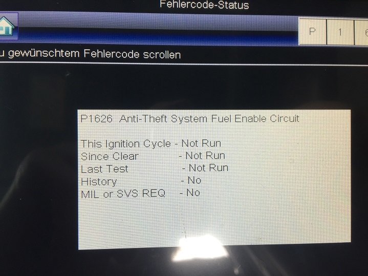

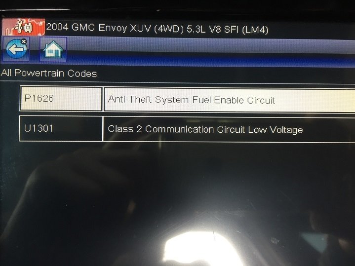

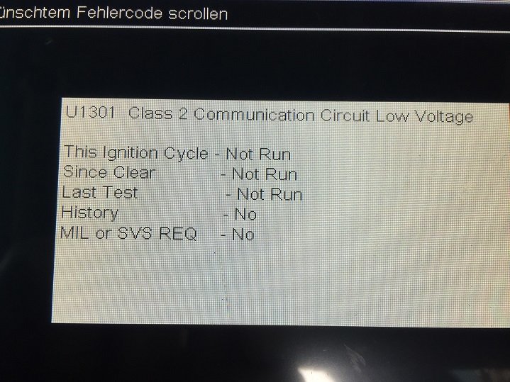

Today I checked with scan tool and have 2 codes.
Nov 5, 2021 at 3:53 AM
STEVE W.
  • 15,344 POSTS
The way those read they are not active codes. Note how they say the tests have not been run yet. I would clear the codes it shows and see if they return.
Nov 5, 2021 at 10:46 AM

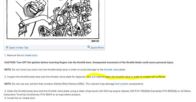

Hi guys, after washing the engine space scan tool showed code for Mass Air Flow (MAF) Sensor, I bought a new one and replaced. Same time I cleaned throttle body and moved butterfly; mechanic told me I shouldn't move it because now I have to adjust it somehow? Now engine light is off, no code.
Nov 5, 2021 at 4:45 PM
  • 110,241 POSTS
If you moved the throttle actuator, that shouldn't be an issue. It is recommended not to insert anything in it to move it because it can damage it. Also, if your fingers are in it and it actuates, that could cause personal issues.
However, the directions specifically indicate that you must move it to access the entire throttle plate. See pic below.
I hope this helps. Let me know if you are still having trouble.

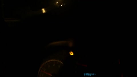

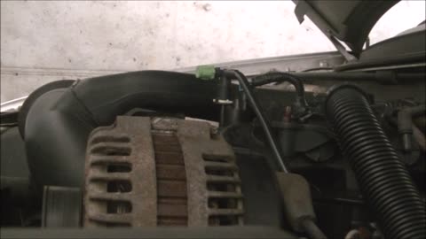

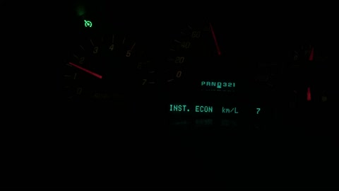

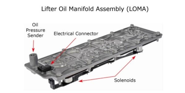

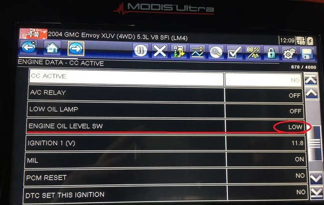

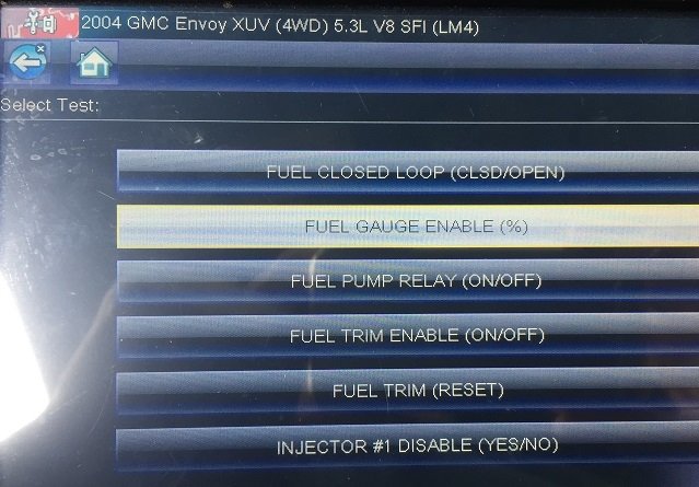

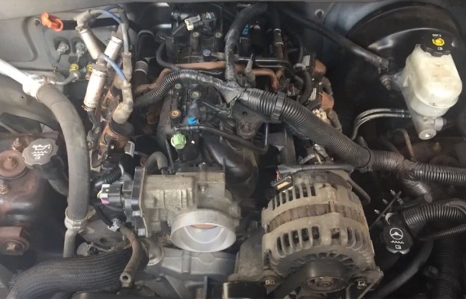

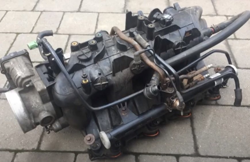

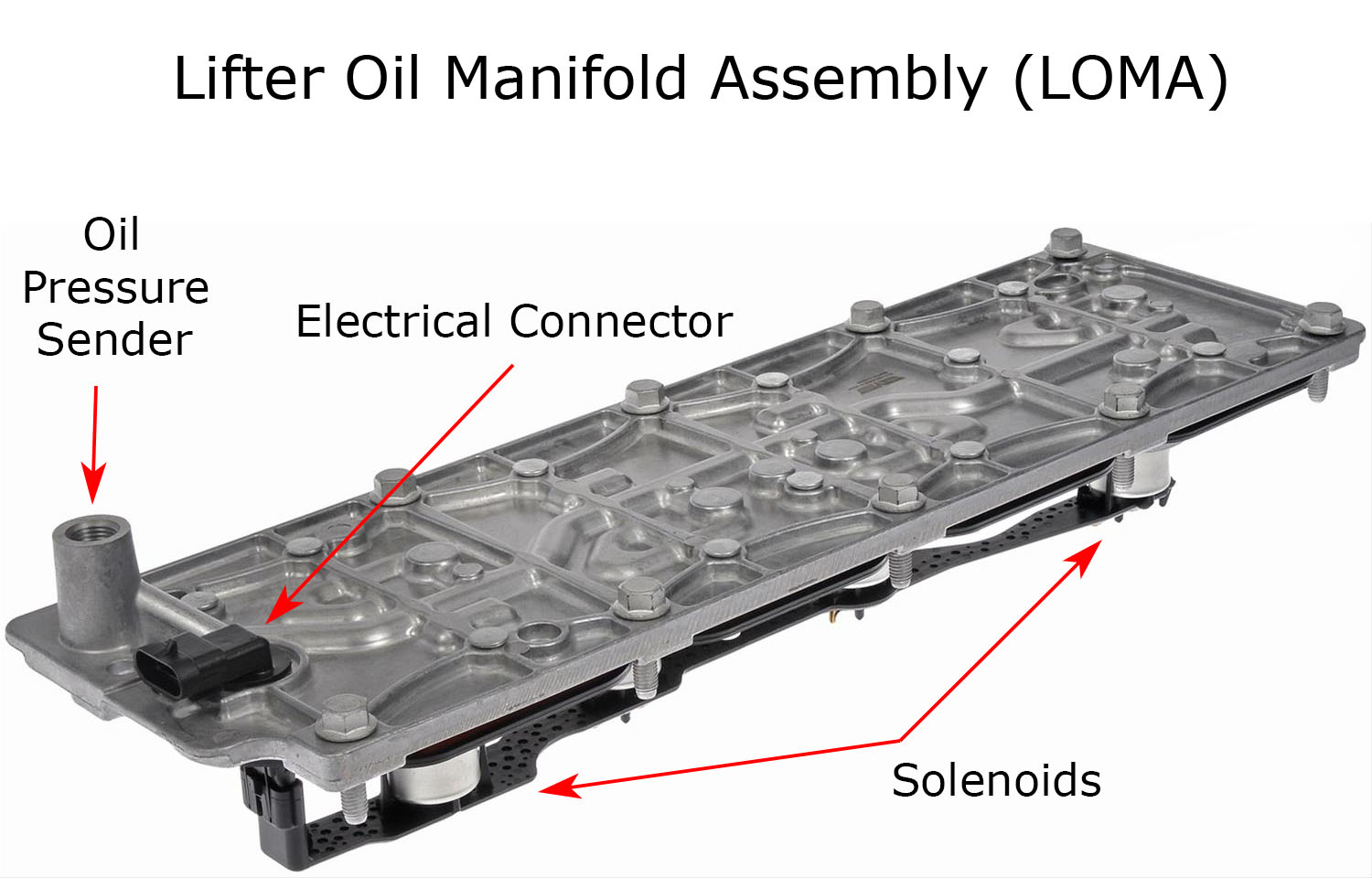

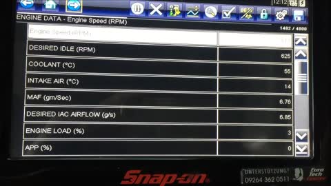

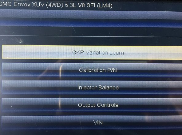

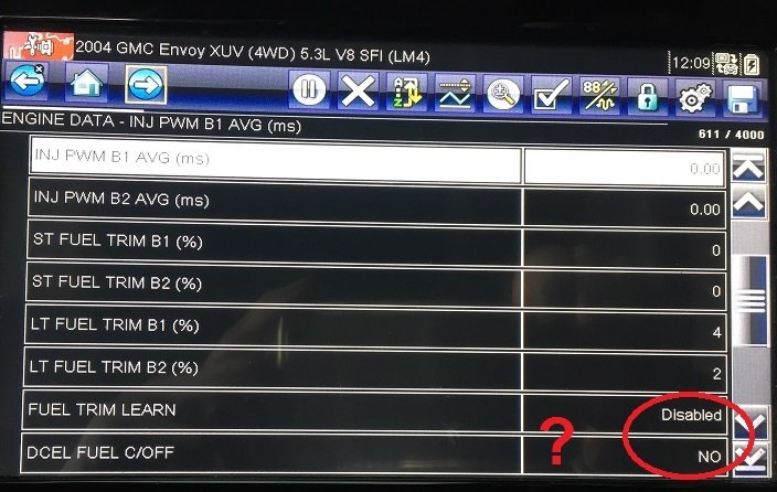

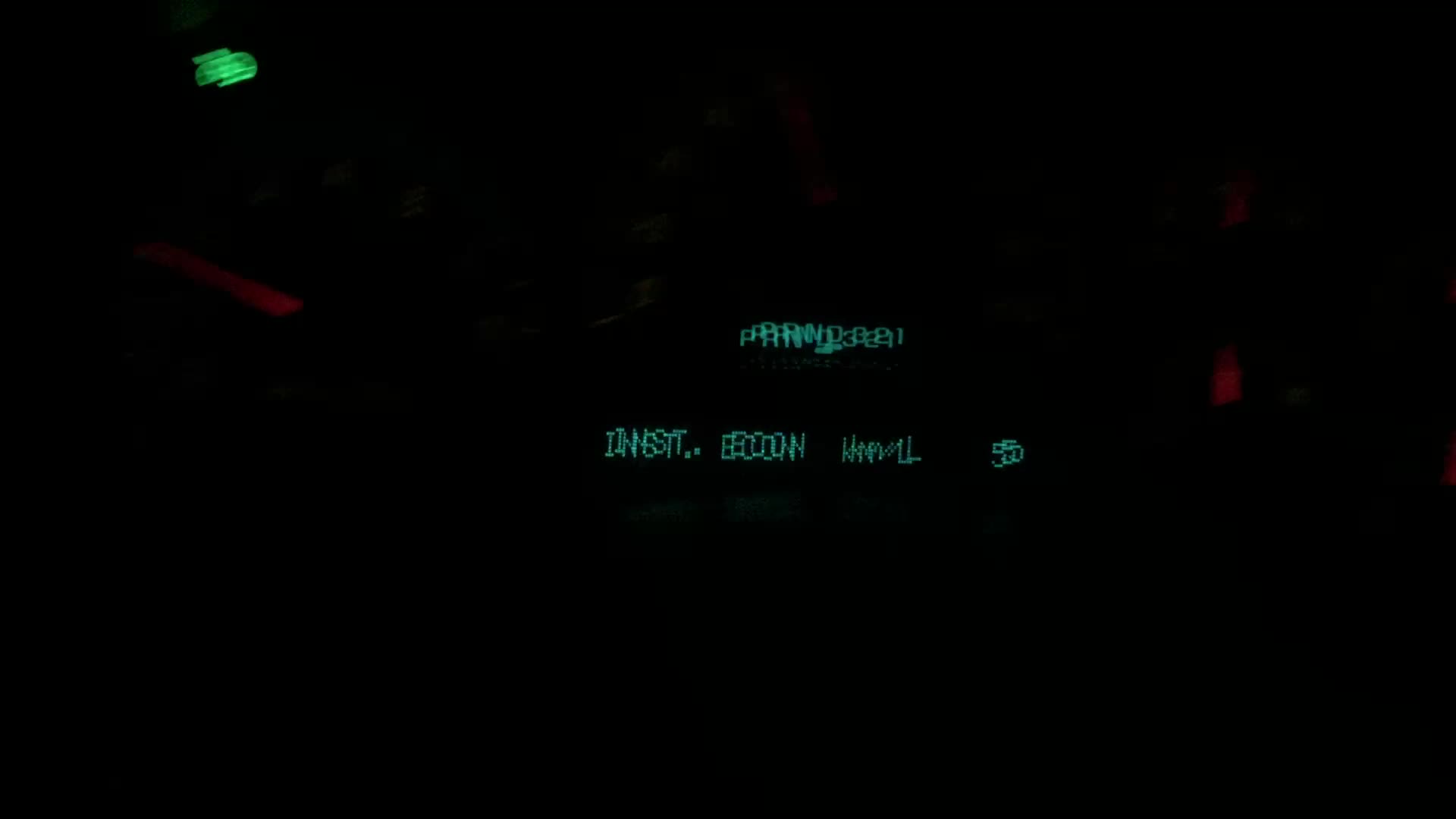

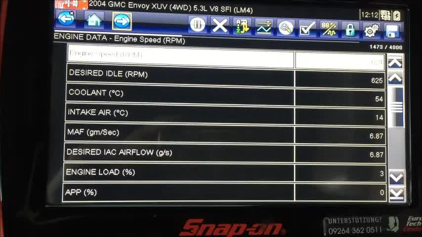

Hi guys, still looking way AFM/DOD not working?
Uploaded video, maybe you can see what is wrong?
Uploaded picture, same, can you check it?
1 and 2 picture, is that right location for checking AFM?
3 picture, AFM is disabled?
4 picture, engine Oil LOW? I checked oil, is on top mark. Maybe sensor is bad? Where is he located? Hot to check it for fault?
Thanks,
Paul
Nov 16, 2021 at 12:27 AM
STEVE W.
  • 15,344 POSTS
First you need to verify if it even has DOD, here is a real quick way, Look down under the intake at the valley cover. Is it smooth or does it have ribs and channels like the ones shown? If it's smooth it doesn't have AFM. If it is ridged it should have it. The electrical connector on the cover is what controls the oil. The low oil switch will read low or high. Low is off, high is on. So, yours is working. None of those PIDs are for the DOD, it may show in active tests, been a while since I've used a Snap-On scan tool. Personally, I've removed DOD from just about every vehicle because it has a very bad habit of damaging the camshafts and lifters. GM even knows how bad it is because they are offering DOD delete parts themselves.
Displacement on demand (DoD) is disabled for the following faults:
- Manifold Absolute Pressure Sensor
- Brake Booster Vacuum Sensor
- Engine Oil Pressure Sensor
- Engine Coolant Temperature Sensor
- Vehicle Speed Sensor
- Crankshaft Position Sensor
- Engine Misfire Detected
- Displacement On Demand Solenoid Driver Circuit Failure
So, check all of those to be sure they are connected and clean.
Nov 16, 2021 at 4:01 AM
