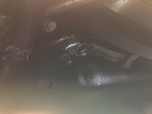

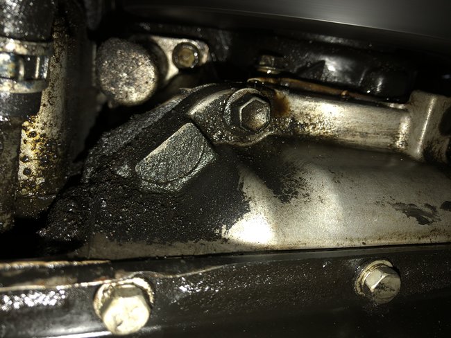

I noticed a leak here that drips and makes a small puddle. do you know this silver looking pan above the oil pan is called and how difficult is it to remove to install a gasket or silicone?

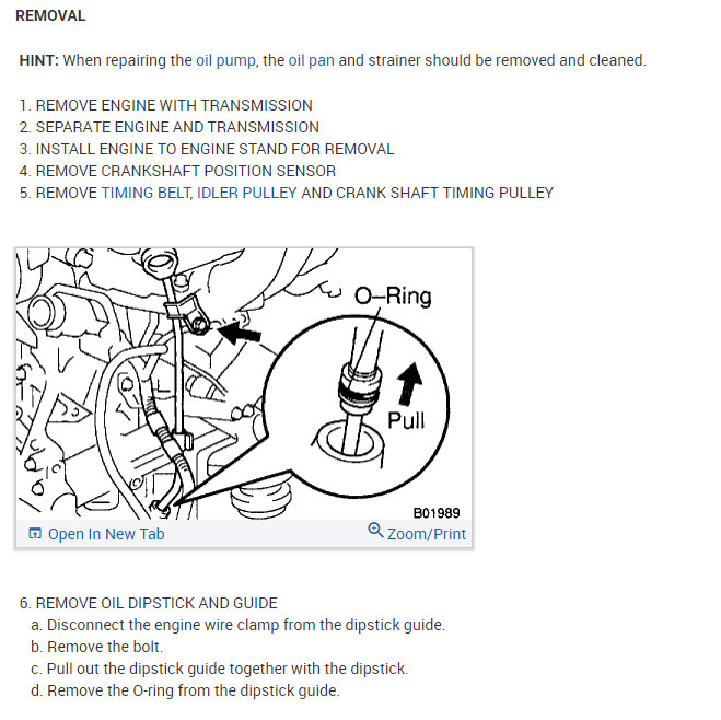

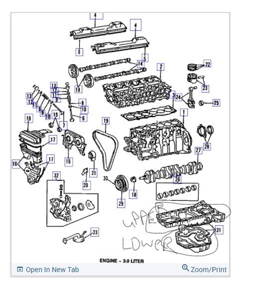

This looks like you have a upper oil pan seepage. Check out the diagrams (below). This repair requires to remove engine to repair (good idea would be to reseal at this time) I would approach first to steam clean engine top and bottom to verify seepage. I am glad to help you. If there is anything else we can help you with please contact us again. Thank you for choosing 2CarPros.

So this can't be done without removing the motor?

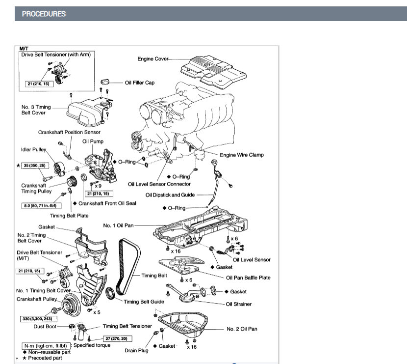

unfortunately the engine has to come out. see chart let us know if further procedure is required.
