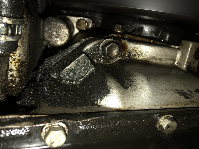

Do you know what this pan or gasket is called?
2003 LEXUS IS
224,000 MILES • 6 CYL • 2WD • AUTOMATIC
NASER NASER
  • 836 POSTS

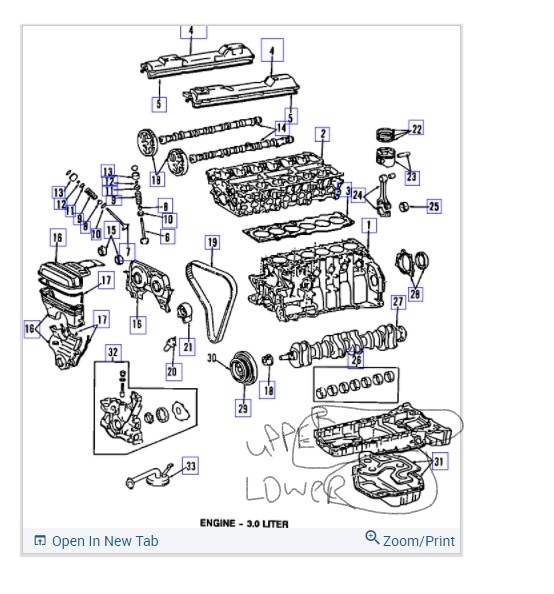

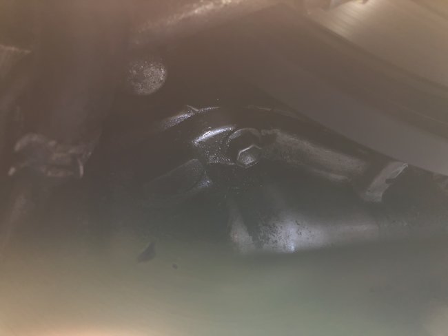

I noticed a leak here that drips and makes a small puddle. do you know this silver looking pan above the oil pan is called and how difficult is it to remove to install a gasket or silicone?

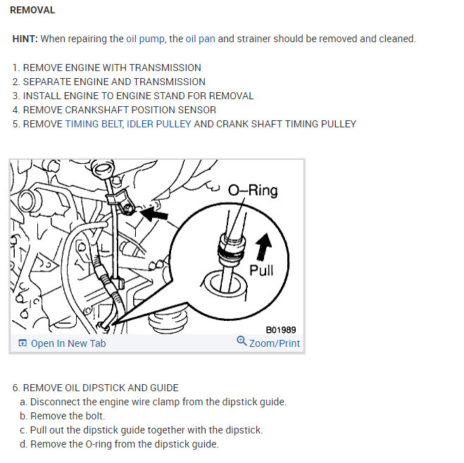

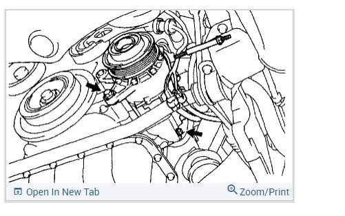

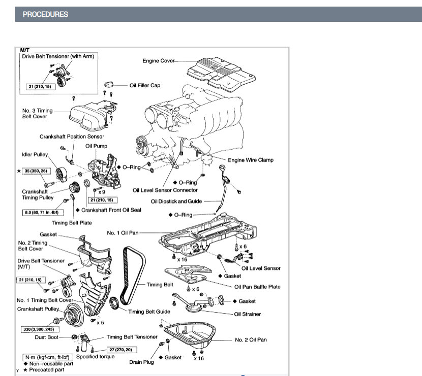

This looks like you have a upper oil pan seepage. Check out the diagrams (below). This repair requires to remove engine to repair (good idea would be to reseal at this time) I would approach first to steam clean engine top and bottom to verify seepage. I am glad to help you. If there is anything else we can help you with please contact us again. Thank you for choosing 2CarPros.

Hi Naser ,
unfortunately the engine has to come out. see chart let us know if further procedure is required.
cheers, Nick
