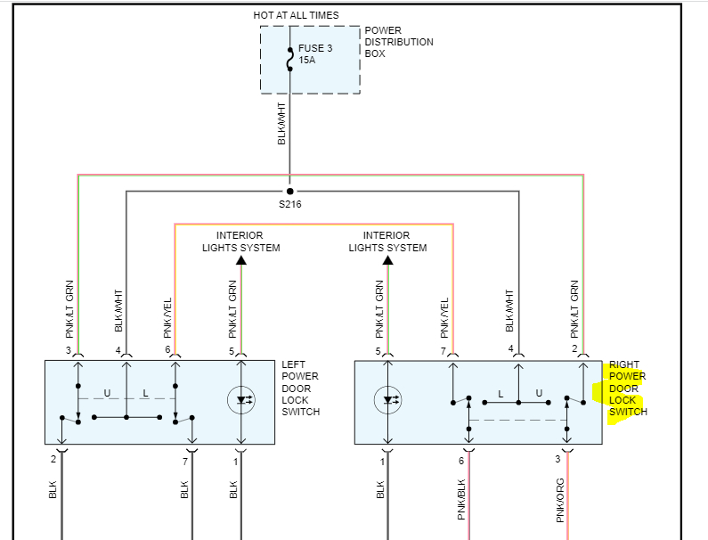

I’m trying to wire and splice together. I’m looking for a color wiring schematic for the passenger door on my vehicle so I can connect the wires.
I’ve counted 15 on harness and mine has 17 so I’m wondering do I take 2 of same colored wires and splice them together as one.
Jun 6, 2023 at 7:35 AM
  • 110,240 POSTS

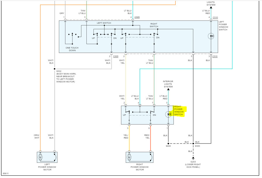

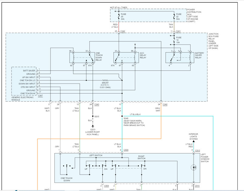

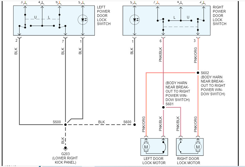

I don't have a general schematic for the right door. In the manual, they are broken down by circuits.
If you look at the first two pics, they are for the power windows. Pics 3 and 4 are for the power locks.
Take a look and let me know if this helps or if there is something different needed.
