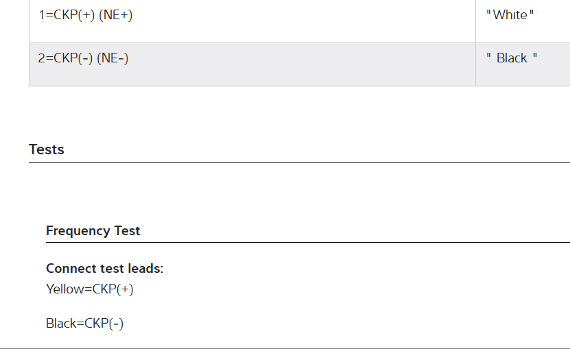

Does this car have a crankshaft sensor?
Aug 7, 2019 at 10:51 PM
SCGRANTURISMO
  • 4,897 POSTS

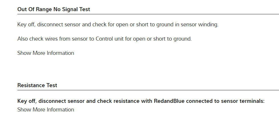

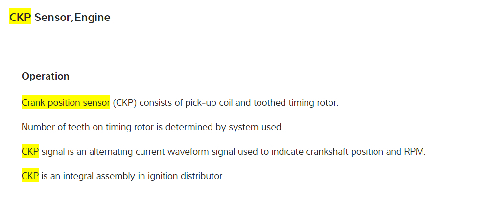

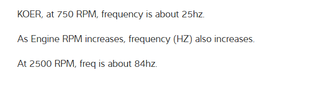

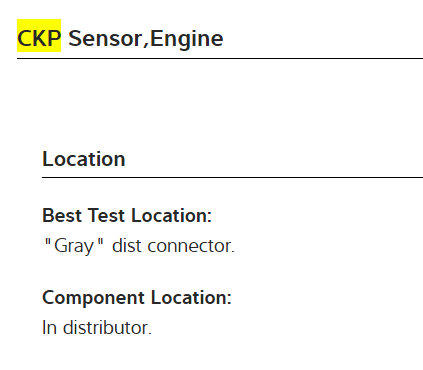

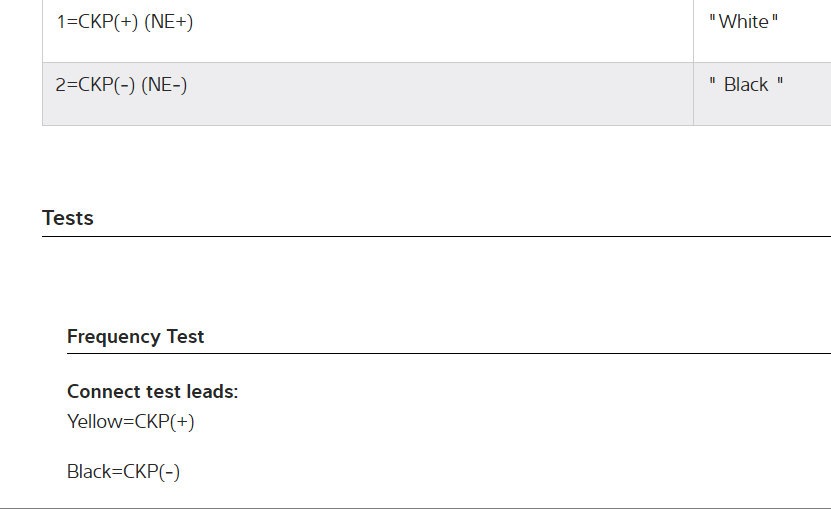

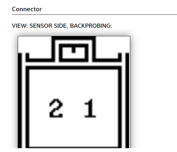

Yes they do. It is located in the distributor. In the diagrams down below I have included the description of what the Crankshaft Position Sensor (CKP) does, it's location, and factory tests to see if it is working correctly or not. You will need to use a multi-meter to run these tests, so I have included a wiring diagram down below if you are unfamiliar with how to use one.
Please go through these guides, if needed, and get back to us with what you are able to find out.
