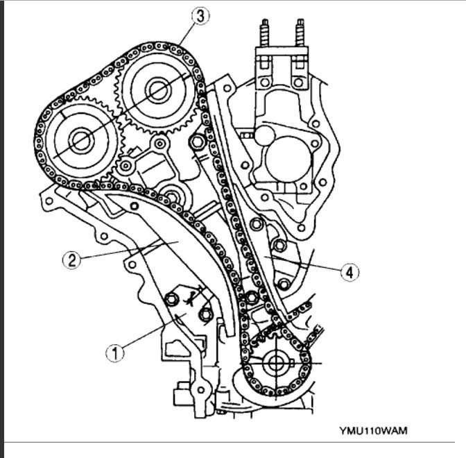

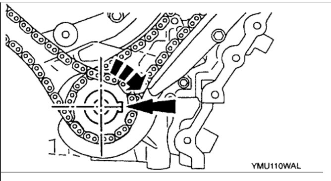

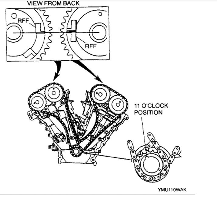

2000 MAZDA MPV
2.5L
V6
2WD
AUTOMATIC
60,894 MILES
Replaced new head gasket.
Sunday, June 25th, 2017 AT 10:42 AM
KEN L
MASTER CERTIFIED MECHANIC
50,321 POSTS
It could be becasue the timing is off on the camshaft, please do a compression test to see what it is.
and
Here is a diagram so you can double check it. (below)
