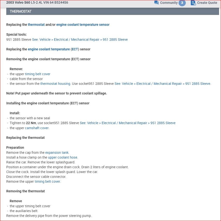

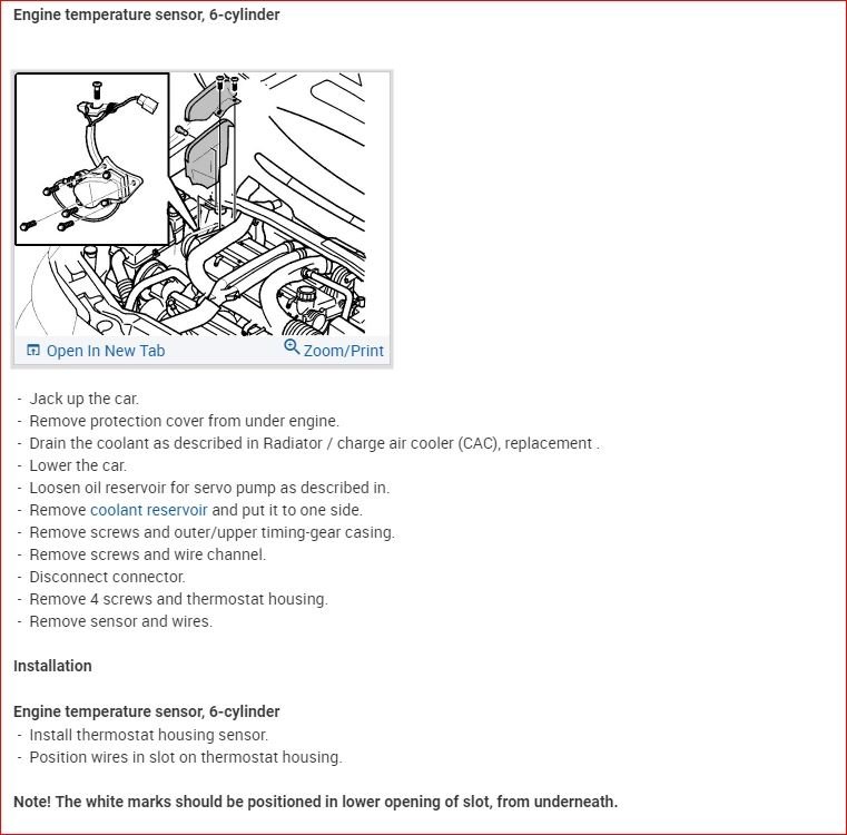

Took to AutoZone and it said I need to replace coolant thermostat and ambient air temperature sensor. Is this something I need to replace right away. Is it something I can do myself?
May 19, 2019 at 9:19 AM
Hi Ze,
It depends on the reason they are stating they need replaced. If your engine is overheating or has another issue, then yes, I would think they should be replaced pretty soon. If the engine overheats it can actually cause serious engine damage.

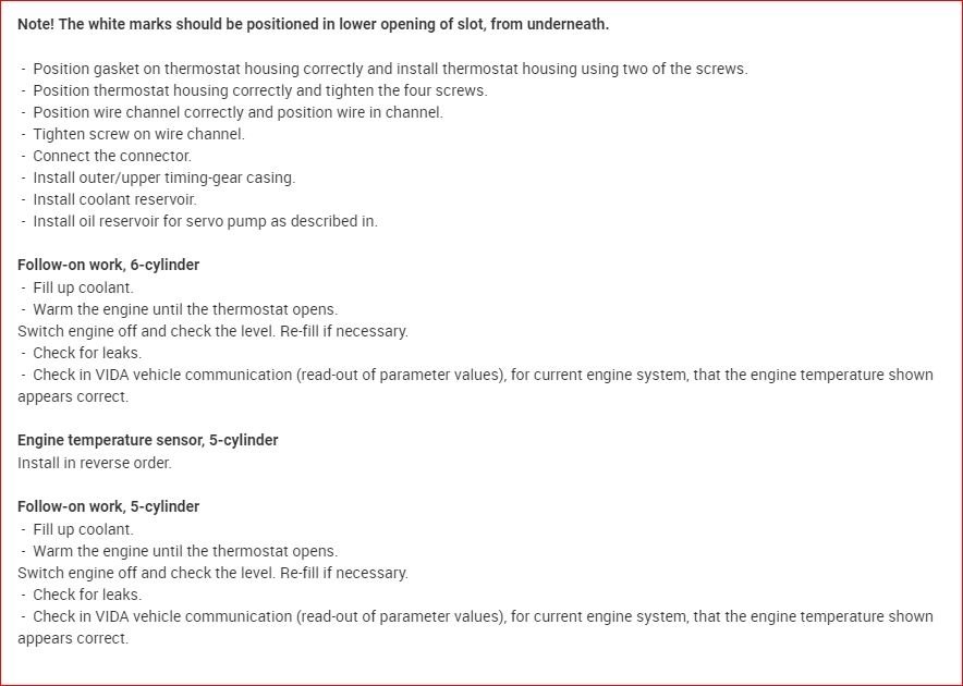

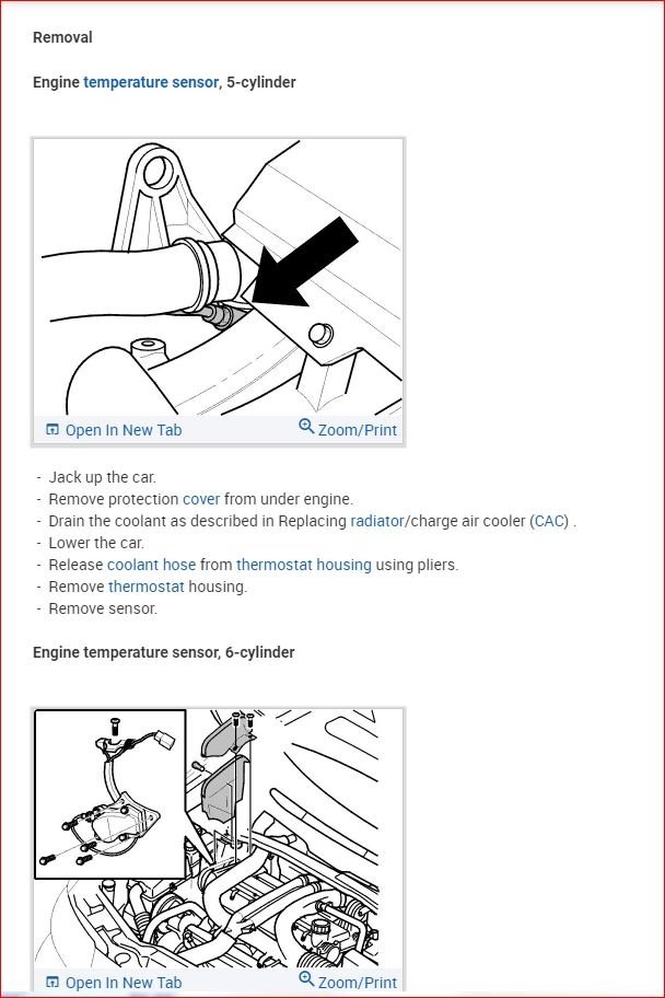

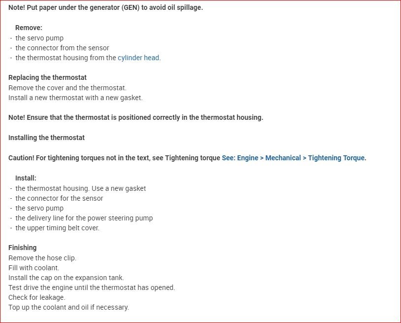

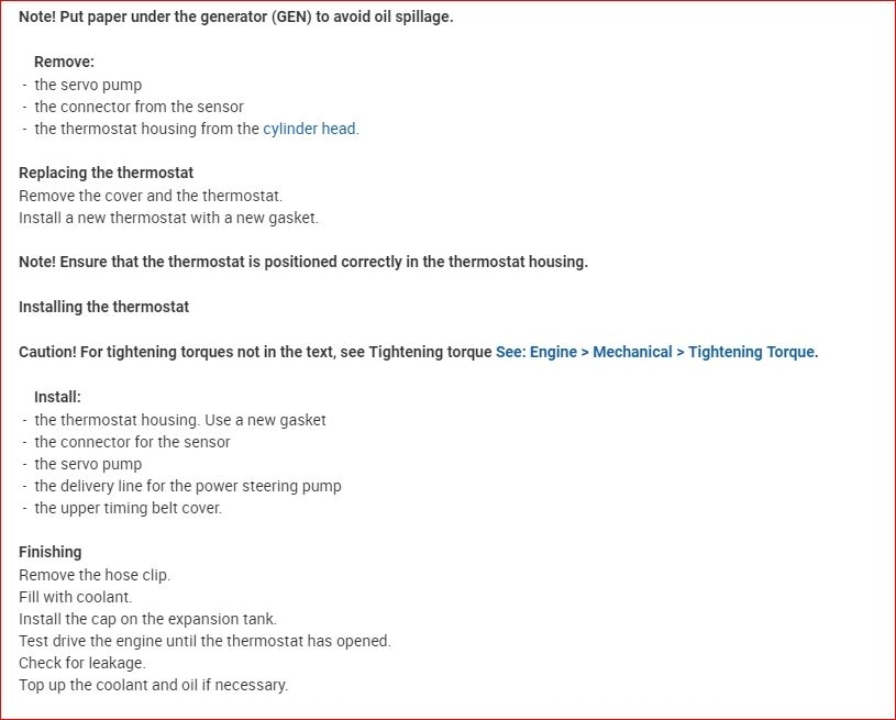

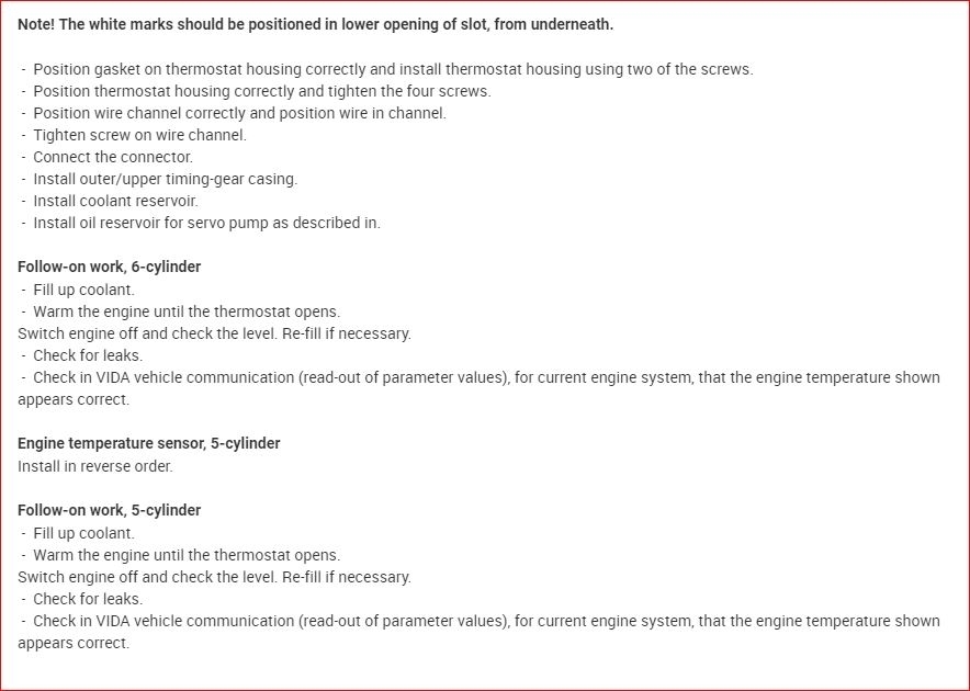

As for doing it yourself, I have attached the procedure for replacing both. They are pretty straight forward however, if you have never done it I would not do it alone. See if there is someone in your circle of friends that has ever replaced them. Maybe they haven't done it on this vehicle but the process is the same for each, the location of the sensor and thermostat is the only difference.

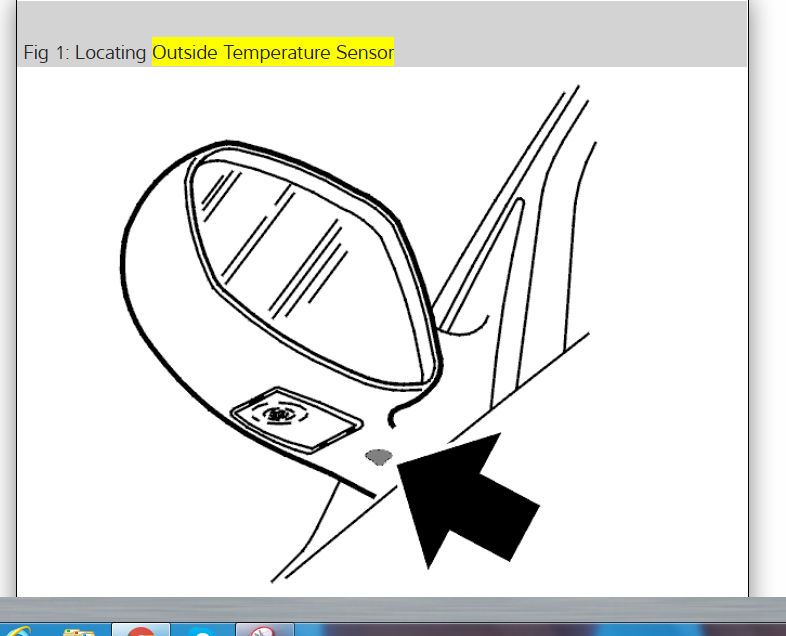

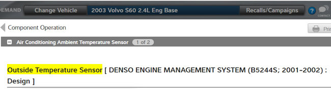

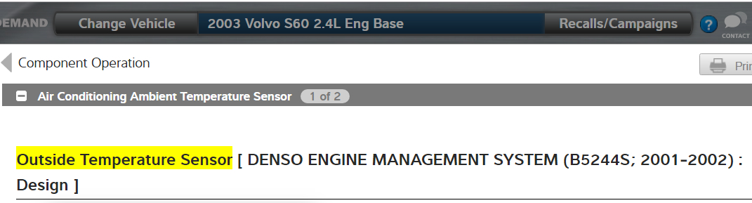

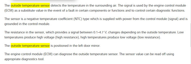

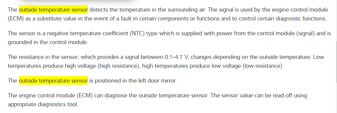

Yes. Coolant does just like it says and is the liquid that is used for cooling the engine and keeps it from overheating. The thermostat is used in the cooling system and is the "gate" that opens and closes allowing the coolant to be pumped around the engine and provides your vehicle with it's heater and defroster. The ambient Air Temperature Sensor is going to be the most expensive part, and the one the you do not to replace right away. It is just a thermometer that measures the temperature outside of the vehicle, which is used as a fail safe backup to other sensors in the engine should they fail. I have included a couple of links below for you to go to.
https://www.2carpros.com/articles/engine-coolant-59420607
https://www.2carpros.com/articles/how-an-engine-thermostat-works
I have also included in the diagrams down below a description of the Ambient Air Temperature Sensor so you can decide for yourself it is critical or not to replace, But coolant and a thermostat is critical to a proper running engine. Please go through these guides and get back to us with how everything turns out, or if you have other questions or concerns. We're here to help.
