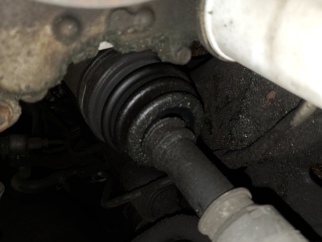

car is shaking bad, especially when i press the gas
2007 NISSAN ALTIMA
102,000 MILES • 2.5L • 4 CYL • 2WD • AUTOMATIC
DUWHOP31
  • 151 POSTS

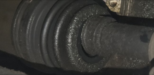

i checked all four motor mounts and replaced one and it still was shaking. So i parked my car and checked the passenger side axle. It looks like the boot is not securely connected. My question is, could this be the reason my car is shaking this bad? Do i need to replace the whole axle or just the boot?
Dec 13, 2020 at 1:58 AM
It is hard to know for sure if that will solve the issue but a failed CV joint will cause this issue so given the condition of the boot, I would replace it. Just replacing the boot will not fix the issue because the boot is meant to keep the dirt out of the joint and once it is in there, the damage is done.

Let's replace the axle and go from there. Thanks
