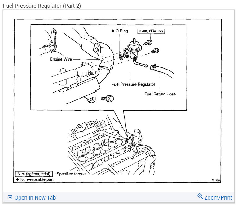

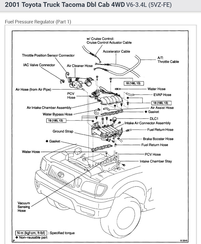

If I may jump in here I have seen the fuel pressure regulator cause noise in the fuel system. Can you remove the vacuum line to see if the noise stops? Check out the diagrams (below). Please let us know what you find. We are interested to see what it is.

Wow Ken, thanks for the reply now that you mention it. I have an adjustable fuel pressure regulator installed and the vacuum line was plugged direct to the manifold, so it was jumping up and down in pressure from 48 psi up to 55 psi (under load). What I did now that you mention it is: I relocate the vacuum line on top the throttle body and the pressure is now constant at 50 psi. as far as sound goes both pumps are operating correctly at this stage.
