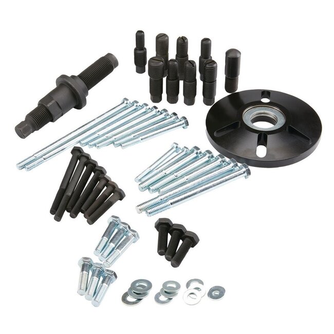

so I've been told I need to lower the eninge 2" to be able to change front main seal? Also do I need the special 3 point puller to get pulley off?
Aug 13, 2025 at 12:03 PM
STEVE W.
  • 15,351 POSTS
You need to lower it to get room enough to get the balancer off the crank snout. There isn't enough room for the puller and crank snout with the engine in stock position. You need the remover and installer kit to get it off and back on. You can generally get it as a loaner tool.

Ok just a fyi. I used a cheater bar to pop the bolt on the Pulley. The AutoZone has a loaner tool #57139 it's a low profile puller for Chrysler and some gm. Got it pulled through the wheel well. All told took me 5 mins to take off didn't have to lower or remove anything. I'll probably have to remove radiator hose to get belt on otherwise just the wheel well. Thanks for the info.

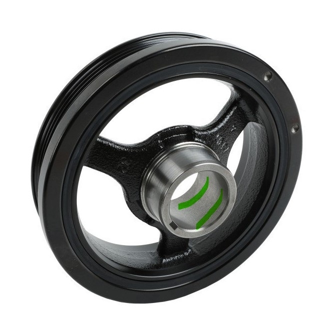

Okay so installation question. I've done this twice now with same results little oil leaks coming from what looks like harmonic balancer. I think the balancer isn't in all the way. I used the old bolt to pull the pulley in place. Is it possible the bolt doesn't have enough threading to pull pulley in all the way? I was going to pull the bolt and use a pulley installer to tighten pulley then tighten and torque a new bolt. Could this be the problem? If not could you think of another issue to address? Thanks
May 28, 2026 at 12:29 PM
STEVE W.
  • 15,351 POSTS
A more common issue is a groove worn in the balancer or just a poor fitting seal. Next is if the oil is coming through the balancer itself. Most have a keyway that goes through the casting. It can act as a pathway for oil to get through. Look at where the oil seems to be collecting, inside the face of the balancer is commonly the keyway. Outside or back is usually seal related. I would do two things that should stop any oil. First pull it off and inspect the seal, especially if it uses a spring behind the lip, they can fall out, if it looks OK, find a "speedi-sleeve" to fit the vehicle. It is basically a VERY thin sleeve that you press into place to create a new surface for the seal, plus as it makes the hub just fractionally larger it generally seals better if you have a marginal seal. I use loctite sleeve retainer on them, just to be sure they cannot leak. Then apply some silicone into and around the keyway, and apply some retainer around the crank. Then install the balancer. usually that stops any leaks.
May 28, 2026 at 1:46 PM
DAVENOOB
  • 371 POSTS
Few things it's a brand new balancer. So find a speedi sleeve that fits my seal and add loctite seal retainer around seal or around the whole slide in key hole part of the balancer? Automotive silicon just apply it around as well? I'm sorry I'm having issue visualizing this. Thanks
May 28, 2026 at 8:58 PM
STEVE W.
  • 15,351 POSTS
New OE parts or aftermarket? The sleeve would be used on the balancer snout, however if it's new there shouldn't be any wear groove to leak. As such it shouldn't need a sleeve. I would inspect the seal for damage as well as fit, in the front cover as well as around the snout. The seal should need to be driven into the front cover and should slip over the snout with some drag. For the sealer, a THIN coating on the area I added green to as well as a small dab on the crank key so that oil cannot bypass the key in the slot. The snout should bottom out on the face of the crankshaft but I've seem them still seep, so the sealer stops that. I've used silicone, sleeve retainer and even the old style Permatex non hardening sealer in that area, all seemed to work. I usually apply it to the perimeter surface of the seal (edge where the orange is) just prior to install, just in case there is a ding or imperfection in the surface. Old school engine builders trick. Warning, don't get it on clothes, it doesn't wash out very well.

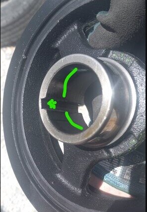

That silicone will work but apply a very thin layer. For the key I generally swipe the back with a finger that has about 3 grains of rice of sealant, then install the key in the crank. Then apply the sealer inside the damper and add about the same 3-4 grains of rice at each end of the key, the idea being that as the damper goes on it pulls some above the key. The seals all depend on which you buy. The OE are usually thin tin with a double lip seal, some use a spring, others don't. Most of the aftermarket ones will have a spring and a rubber coating that attempts to seal the exterior and hold it in place. When the engine is running correctly and the PCV system is working there should be virtually no pressure in the crankcase it usually is barely over atmospheric as the PCV gases are pushed into the engine to be burnt. An older engine that has some blowby can have more pressure in there and that can cause leaks.

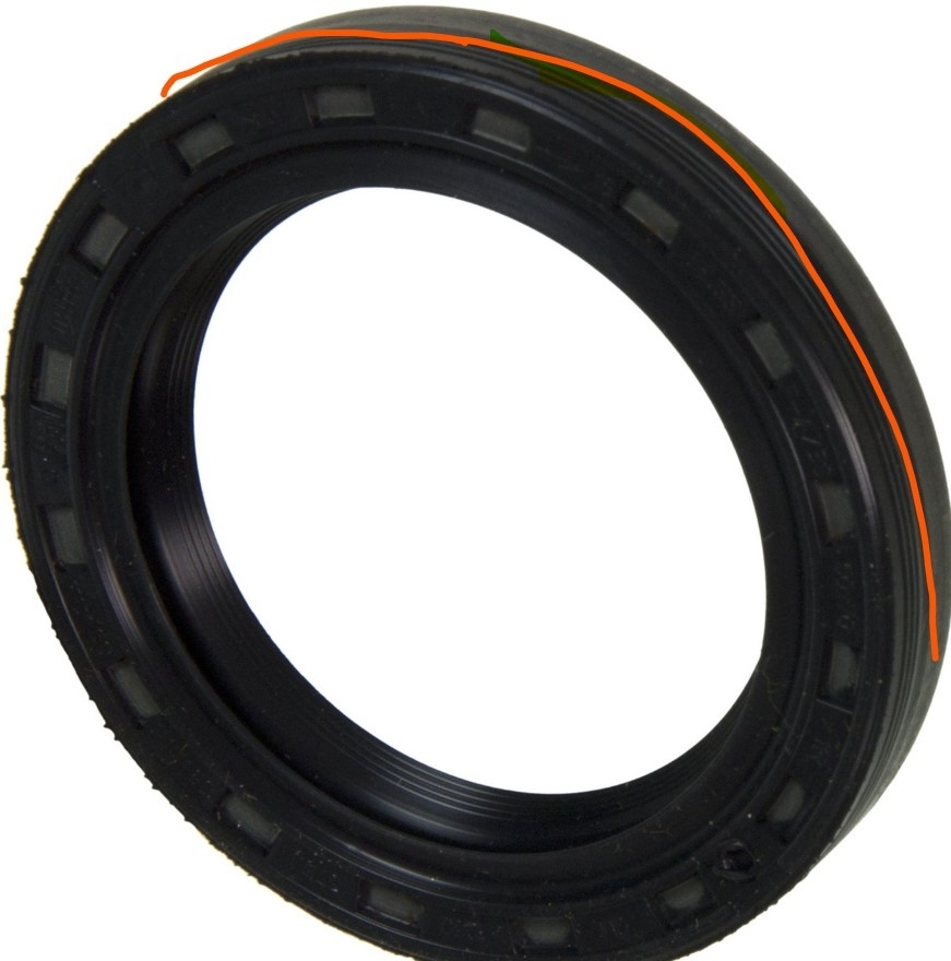

This is what seal it uses. It's slightly fatter around the diameter of the seal. I need to go buy a new seal anyways so I'll get the silicon you recommended. Thanks for the marked lines where to put it. I'll be knocking this out tomorrow. Just finished cv axle replacement on the other car so I can go get parts. Lol fml have a good one.

Silicone on outside of the seal only. I do put some grease in the inner seal lips though. You don't want sealant there. Then a smear inside the hub on the damper and around the key. If you look at the image, the area at the back is where the crank pulley bottoms out. The problem is that they rarely fit real tight and oil can get through. So you apply the sealer in a thin coat and on the key and it usually stops oil migration. They used a few different cranks, some have the pin, some have a key others used a different key. What you don't want is any sealant on the outer surfaces of the damper or crankshaft. The polished area that you see farther back is where the crank bearing sets, when the engine is running there is oil spraying out of that area, right across the damper at the sealing area. Any imperfection and you get a leak.

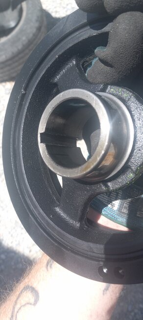

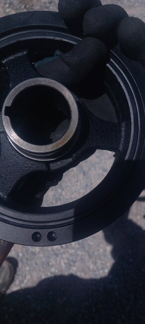

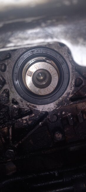

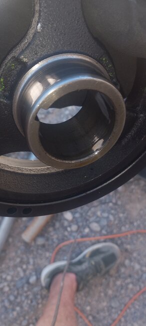

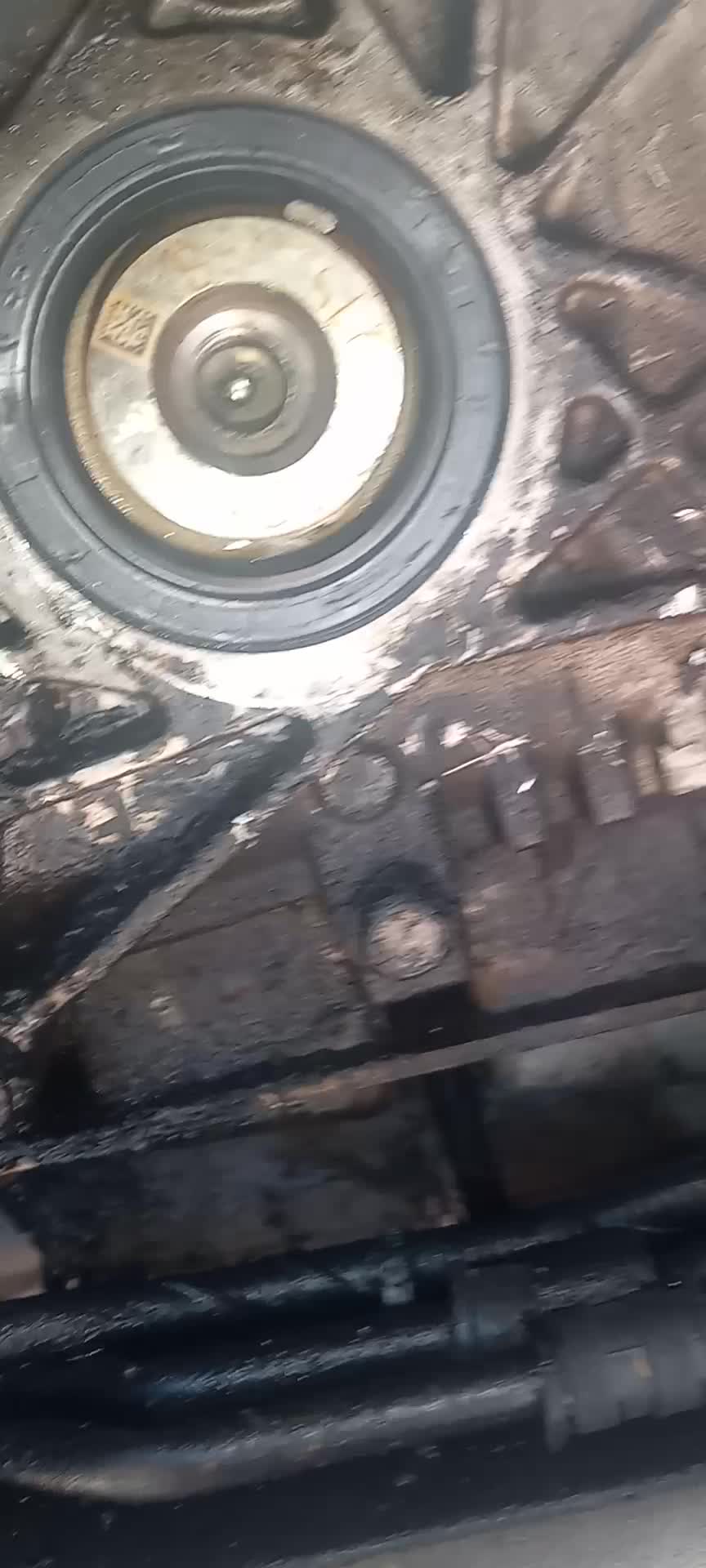

Here's some pics of the oil setting and snout all that. Also the seal.
May 30, 2026 at 2:05 PM
STEVE W.
  • 15,351 POSTS
Seal looks OK, apply the light coat inside the balancer and button it up. Won't hurt to apply some oil to the seal lips and outside of the balancer on the seal surface. That generally keeps the seal from sticking as the balancer goes through it.

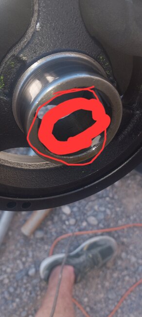

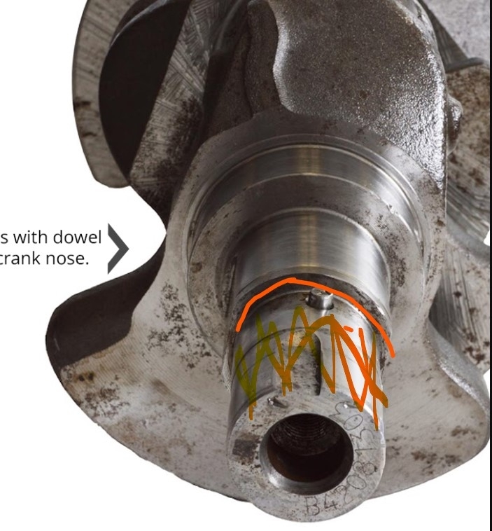

So where Seal and snout touch a dab of grease. Now my pulley is different then the second pic with orange on outside of shaft below the notched. So I'll add silicone to the inside and a little where it sits against crank. My key or notch coming out of the engine do I want to put some there as well? The first 2 picks with orange and green lines makes sense. Your second pic with orange on lower "shaft"(don't know proper term) doesn't quit make sense. That part is in the engine itself not part of the pulley.
May 31, 2026 at 8:05 AM
DAVENOOB
  • 371 POSTS
Sorry about bad drawing. So the inside will get a few rice size dabs spread around. Then the back where it sits against crank gets a smear, right? I marked very sloppy in red. Just making sure I've done this 2 times this is my 3rd so want to make sure. Thanks
May 31, 2026 at 8:10 AM
STEVE W.
  • 15,351 POSTS
Apply the sealant inside the balancer and in the key slot. Normally I put some on a finger and just wipe it inside the bore, then some in the slot. Don't put any on the face where the hub and crank meet, putting it there it can squeeze out and foul the seal surface.
