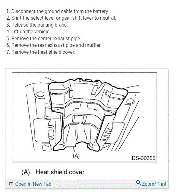

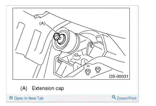

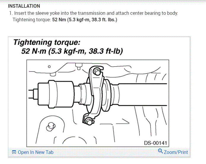

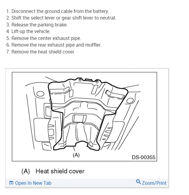

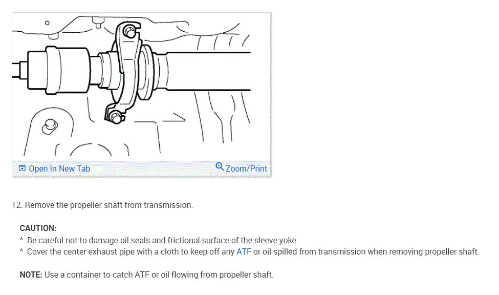

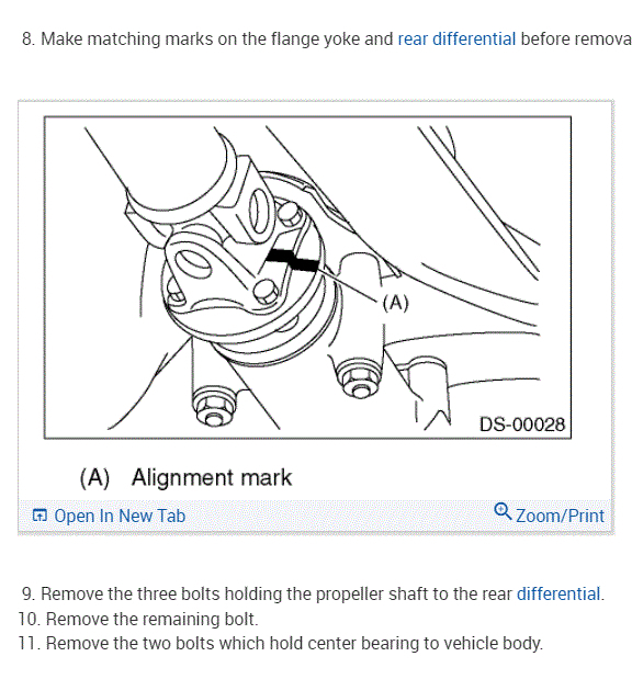

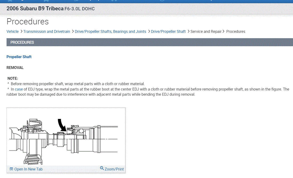

The center bearing went out. Do I have to take the whole driveshaft off to change the center bearing supp.
Thursday, March 10th, 2022 AT 8:50 AM
MECHANIC
110,176 POSTS

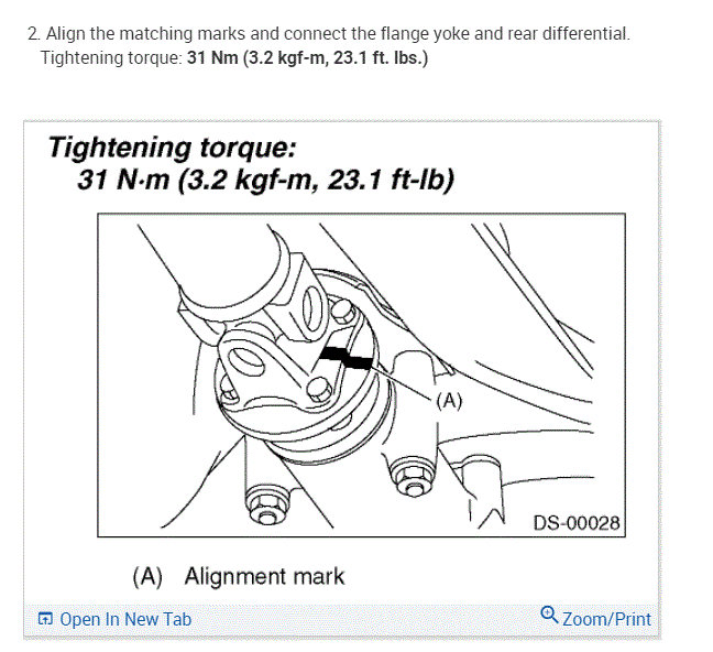

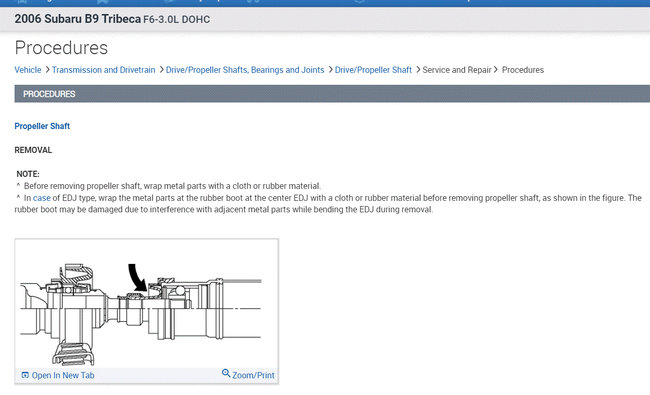

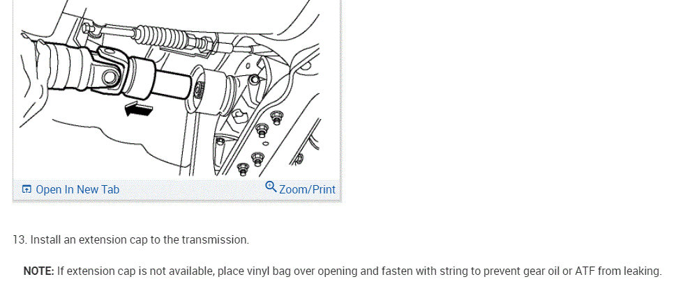

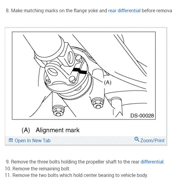

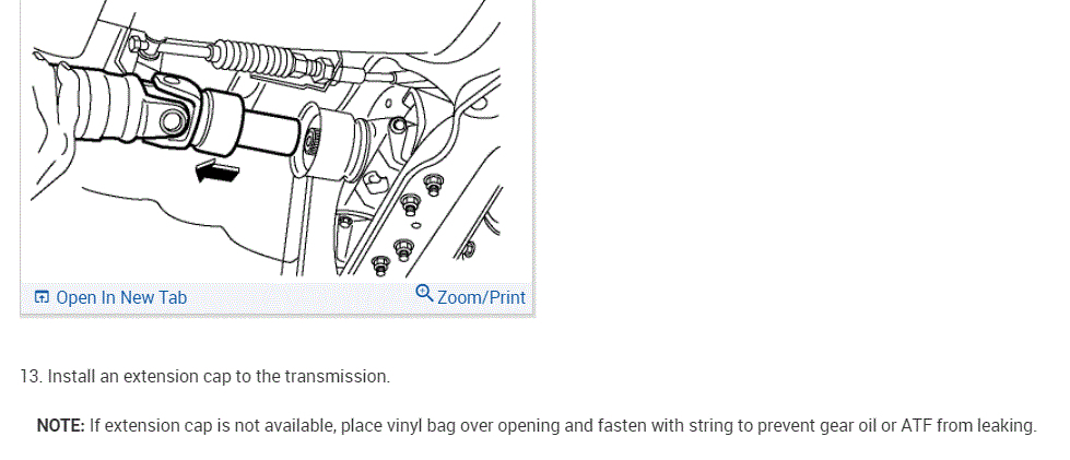

If you are replacing the bearing/support, yes it needs to be removed.
If you look below, I provided the directions for the removal and replacement of the drive shaft.
Images (Click to make bigger)
