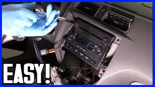

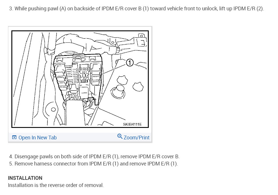

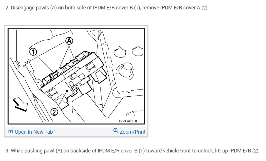

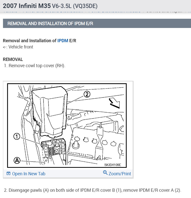

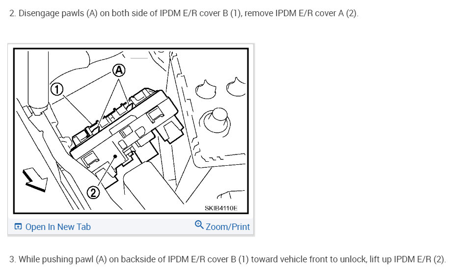

This is not a radio problem; this sounds like a classic IPDM problem which controls the power and operation of the systems mentioned. To be sure we should do a CAN scan, you can get a CAN scanner (Controller Area Network) which will work on most cars from Amazon.
here is a video to show you how:
https://youtu.be/u-4syLc-ifQ
Here is how to change the IPDM out in case you need it. It is easy to replace because it-self learns.
