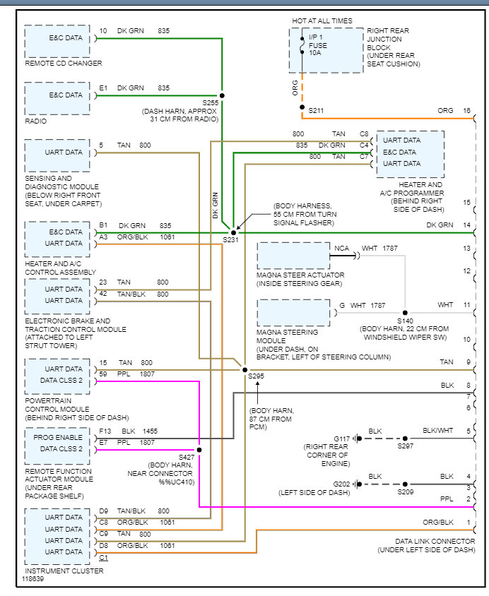

Could you please provide a pinout of the DLC on the car listed above?
Mar 27, 2023 at 8:50 AM
  • 55,433 POSTS
Here are the wiring diagrams for the ALDL data link connector and I have included a guide to help you test the connection.
