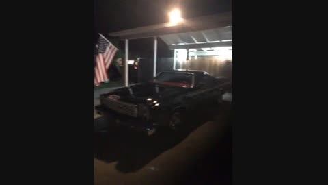

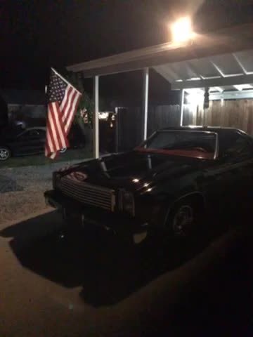

Thanks, I put the new distributor in brought the number one piston top dead center and lined the harmonic balancer to 0 the new distributor dropped in perfect! Thanks for your advice. Running great!
