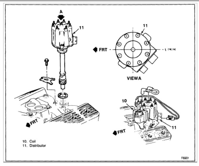

I'm now looking to upgrade the distributor in my car and just wondering how to go about it and if what I've chosen would be a right part.

This distributor uses the ignition box device that I have no idea how I'd have to hook up and what wires would probably go where since I'm still very new to performance parts
And if it's possible I could use an explanation on the properly timed installation and the whole bringing it to top dead center stuff and adjust the ignition timing

This is not what you want this set up is for performance engines you need a regular HEI unit here is a link for $162.00

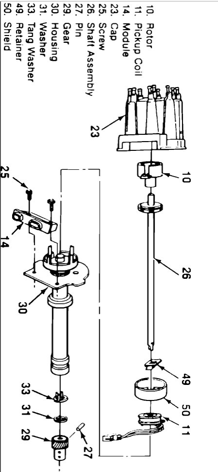

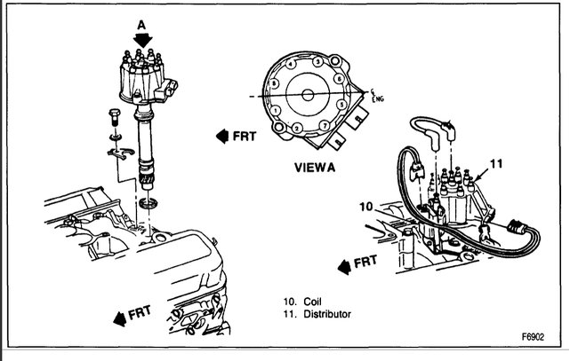

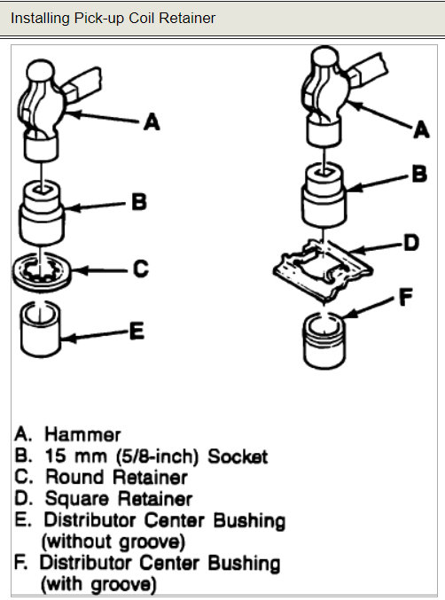

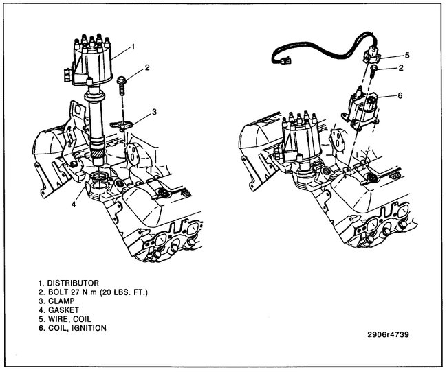

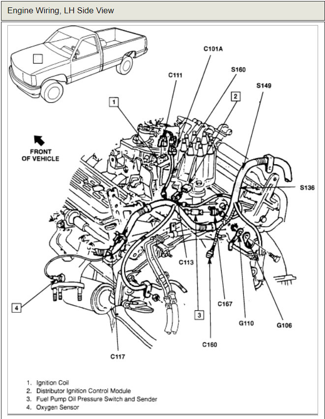

Yes, I have these instructions for you. Check out the diagrams (below). Please let us know if you need anything else to get the problem fixed.
