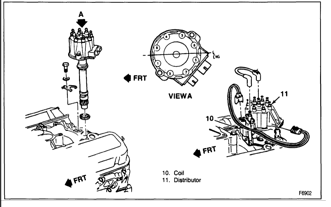

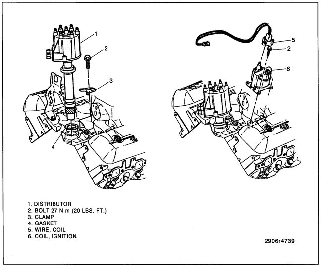

I'm now looking to upgrade the distributor in my car and just wondering how to go about it and if what I've chosen would be a right part.
Here is the link:
https://www.jegs.com/i/JEGS/555/40005K/10002/-1?gclsrc=aw.ds&&mrkgcl=1239&mrkgadid=3341146068&adpos=1o8&creative=351579892256&device=m&matchtype=&network=g&jegspromo=nonbrand&gclid=Cj0KCQjw9JzoBRDjARIsAGcdIDXCuHyqZd8fnztgKrTv72Hr9aYvRZwMgxZIwgIeAQ3tK4i81tr9HZUaAkgDEALw_wcB
This distributor uses the ignition box device that I have no idea how I'd have to hook up and what wires would probably go where since I'm still very new to performance parts
And if it's possible I could use an explanation on the properly timed installation and the whole bringing it to top dead center stuff and adjust the ignition timing
Thanks for any help and have a good day.

This is not what you want this set up is for performance engines you need a regular HEI unit here is a link for $162.00

Thanks, any tips on installation and bringing the motor to top dead center?
Aug 3, 2019 at 3:00 AM
  • 55,224 POSTS

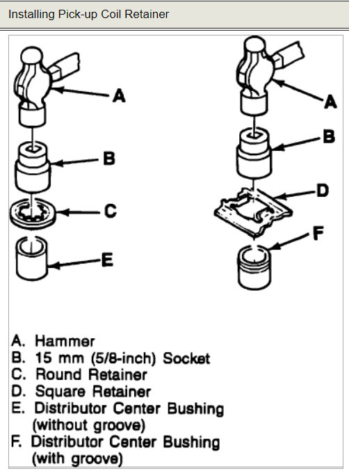

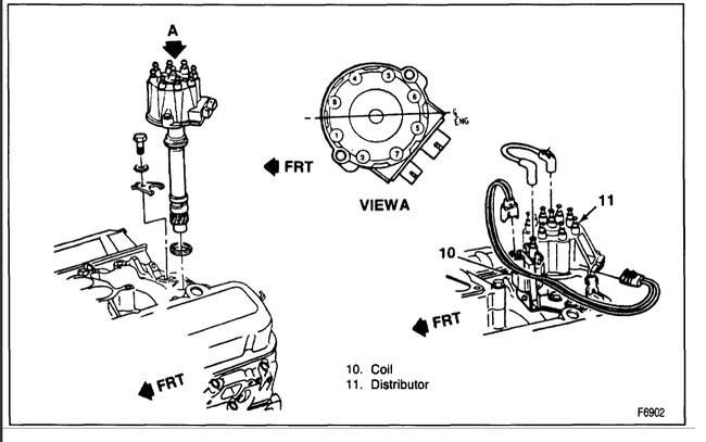

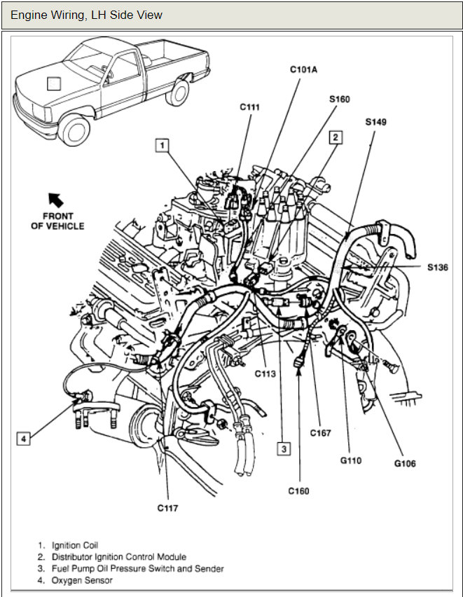

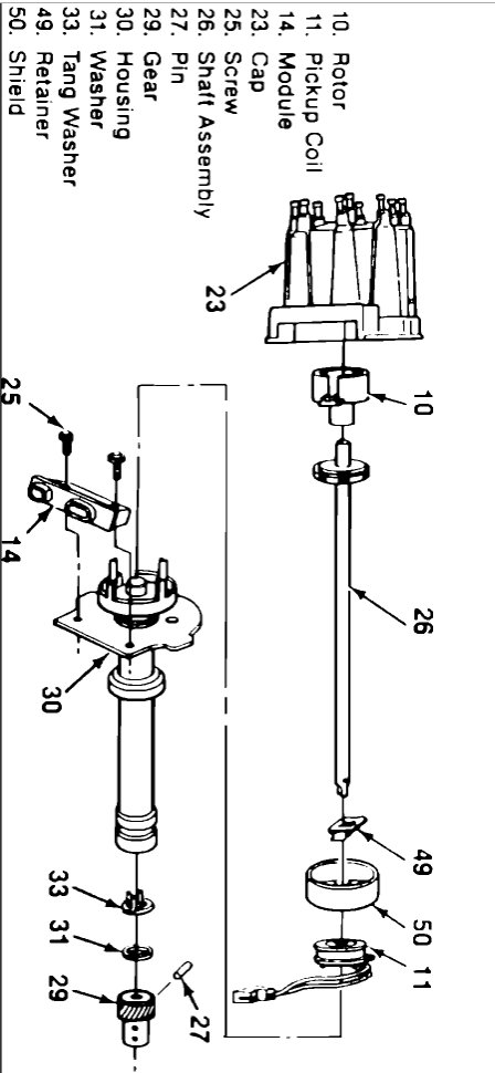

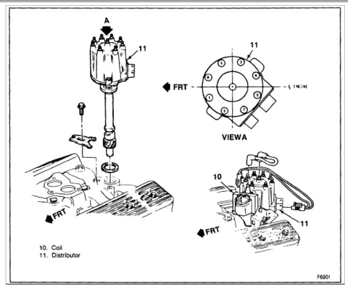

Yes, I have these instructions for you. Check out the diagrams (below). Please let us know if you need anything else to get the problem fixed.
