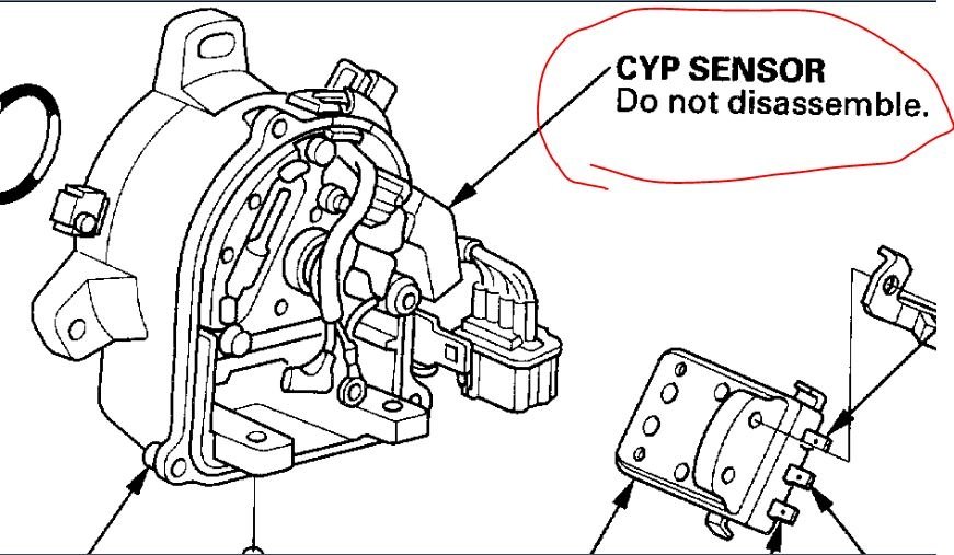

I am trying to replace the distributor sensor, but i cant remember how it mounts up. please help.

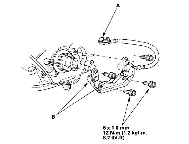

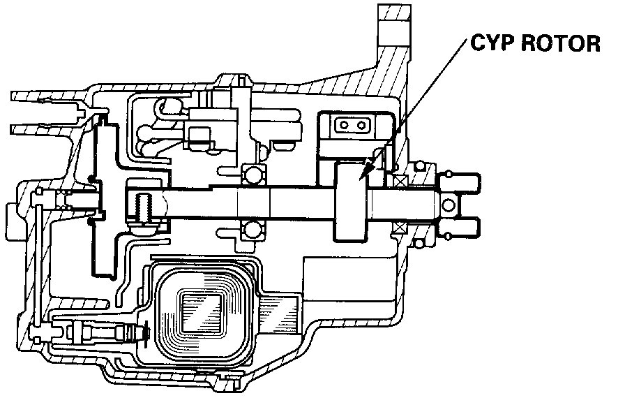

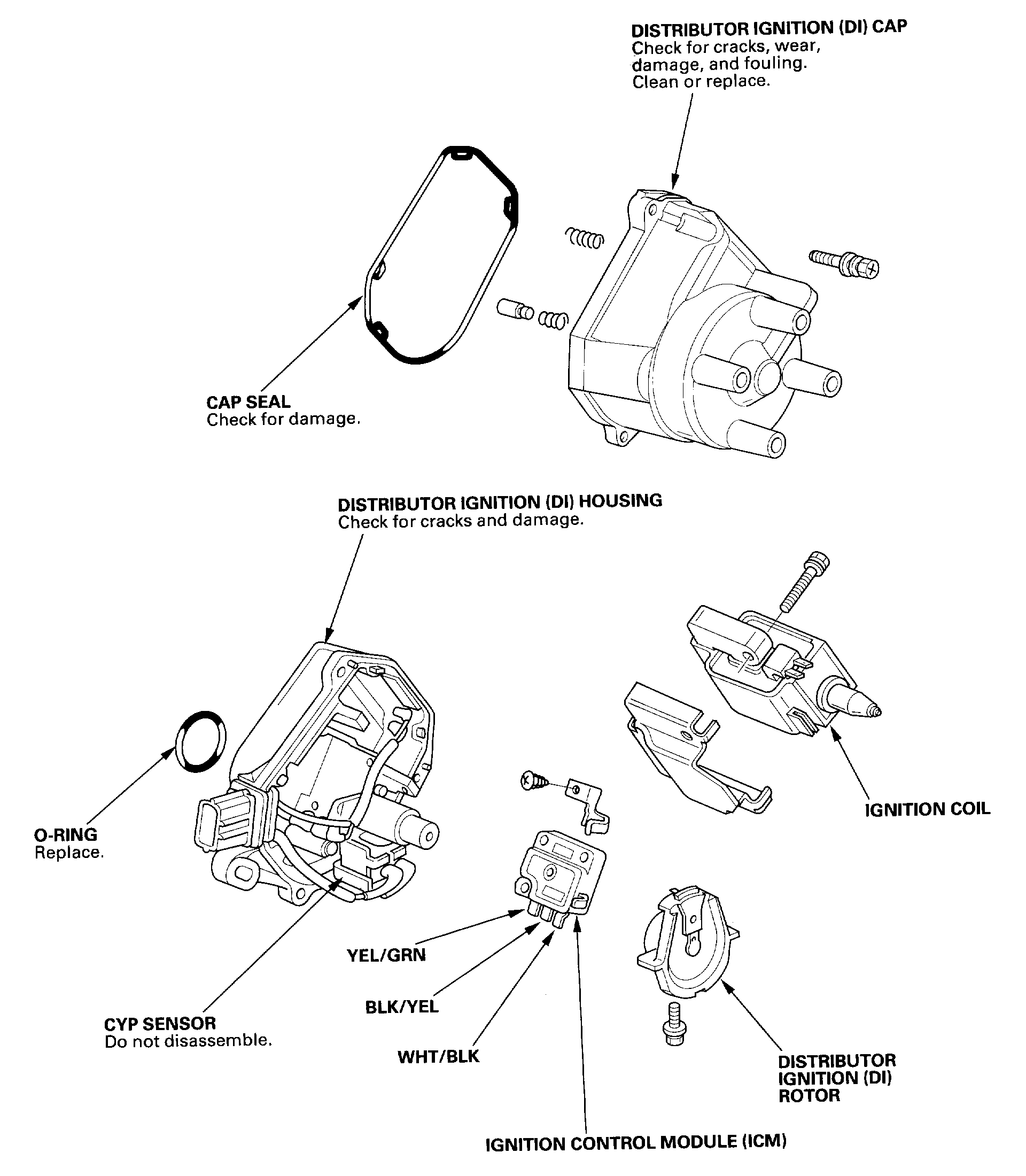

Are you referring to the cylinder position sensor in the distributor? I attached a pic of it below. Or are you referring to the ignition control module or crankshaft position sensor.
See the attached pics of the distributor so I know exactly what you are referring to. The last picture is the crankshaft position sensor.
