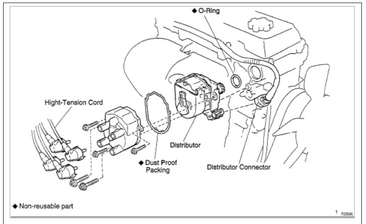

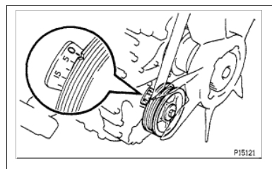

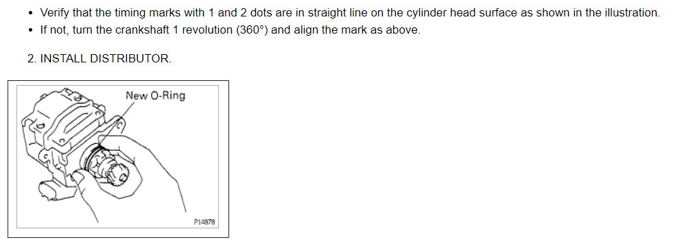

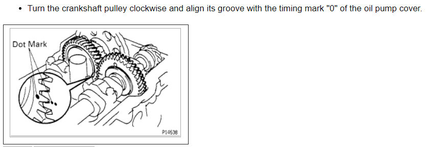

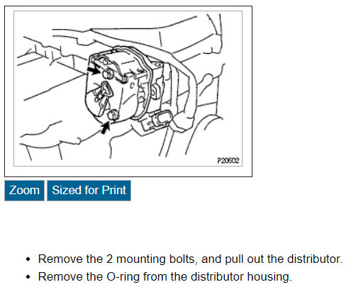

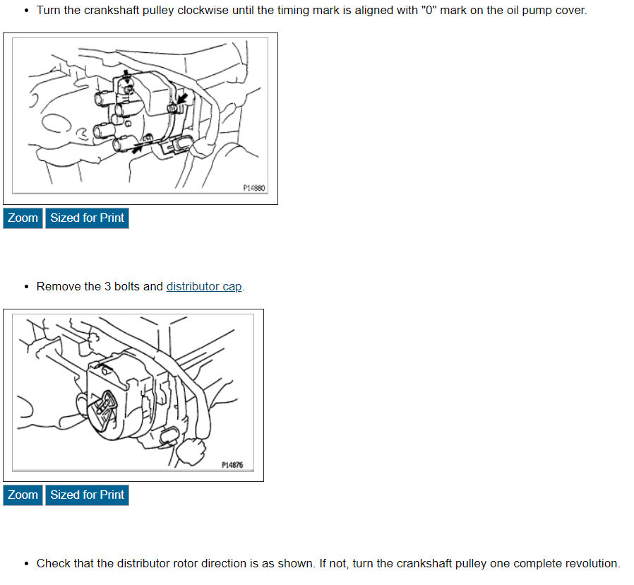

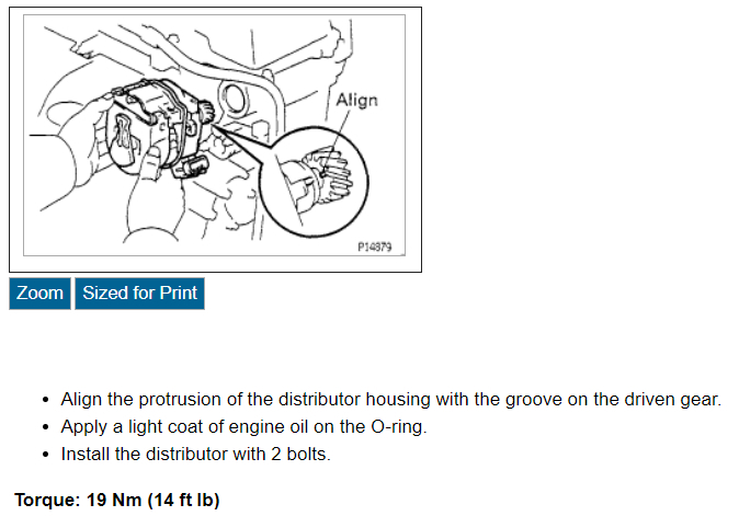

Change distributor.
Jun 21, 2018 at 1:05 AM
  • 55,423 POSTS
You will need to remove the valve cover to do it here is a guide and diagrams below on how to do the job:
https://www.2carpros.com/articles/replace-valve-cover-gasket
