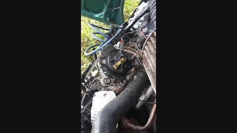

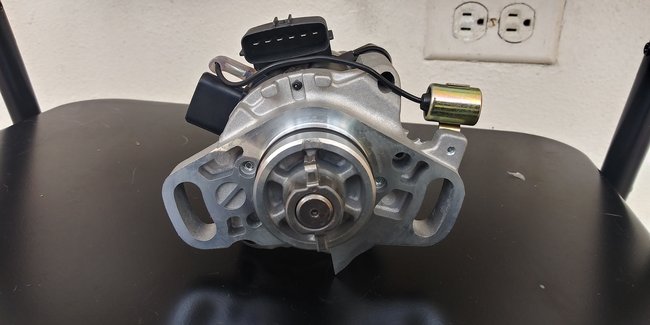

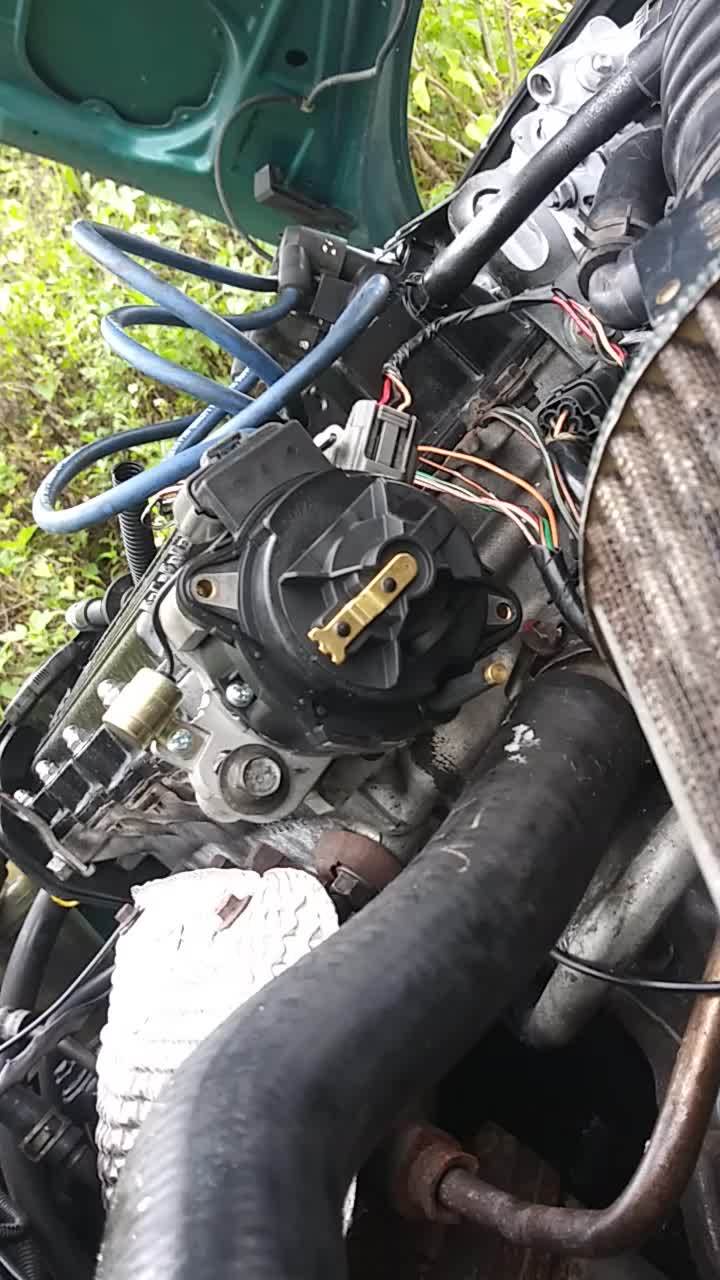

I need the code for the 6 pin plug that this distributor have to know if that's the problem to no start engine.
The distributor is brand new.
The problem is that it won't start i'm going to make a test to the entire system primary and secondary circuit, but i need that plug the way it goes to diagnose the problem. If you have the diagram code for this plug please let me have it, this car is so special, because the owner of the car is a cancer patient and need the car to go and get her chemo treatments. Thanks a lot for the help.
Att. Juan Marin

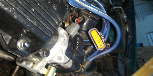

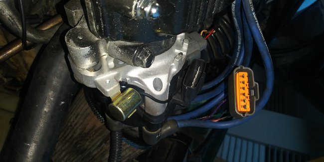

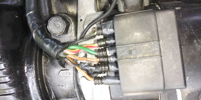

Hello and thank you for using 2CarPros. Unfortunately there is no specific code we can give you. The power train management should post a code if there is a fault. Have you checked for spark, fuel pressure, and fuel injector pulse? How is the compression? Looking at picture #2 looks like your missing the connector for the distributor and the harness does not look to healthy either?
So let's start with what fuel pressure is, do you have spark and injector pulse? Let us know please.

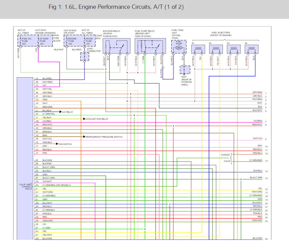

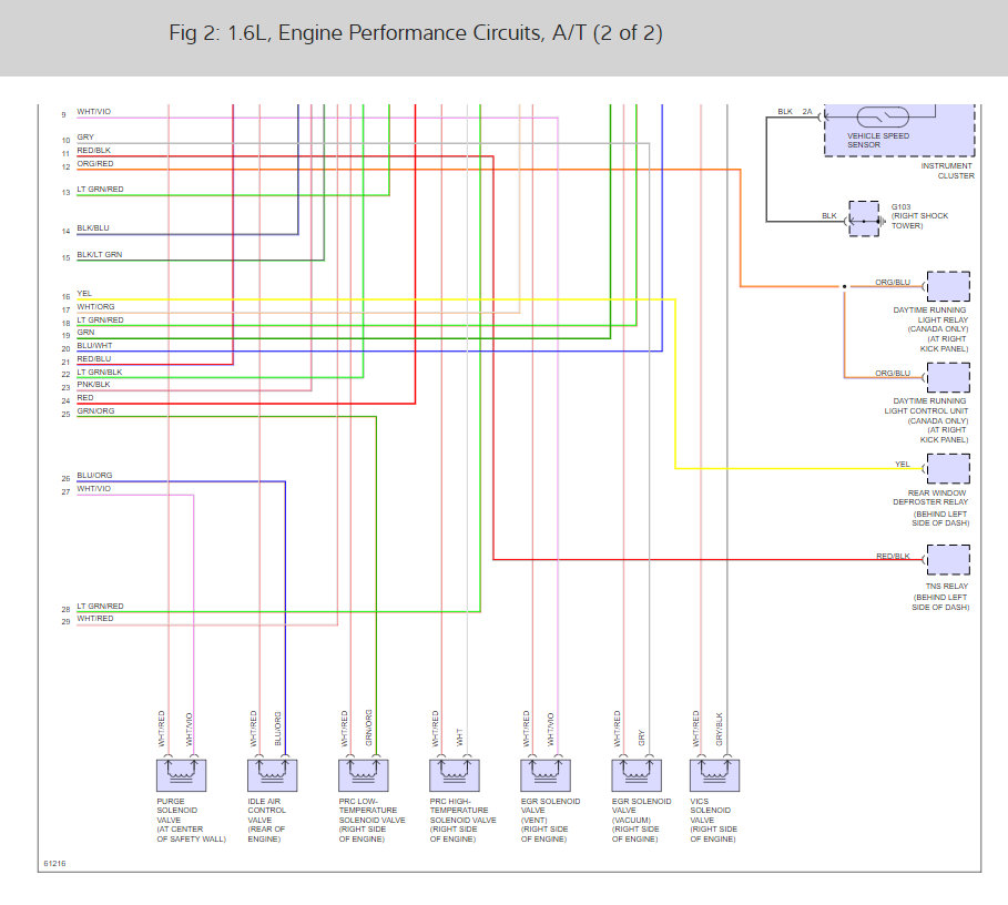

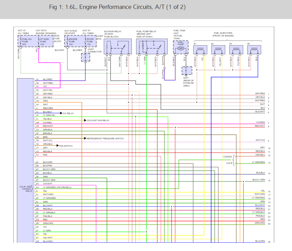

That's the diagram that i need, for that connector.
May 29, 2019 at 9:03 AM
  • 55,433 POSTS

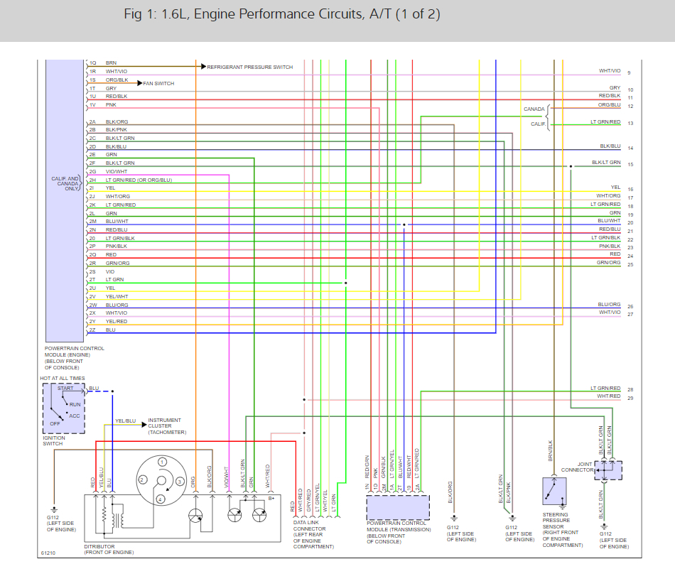

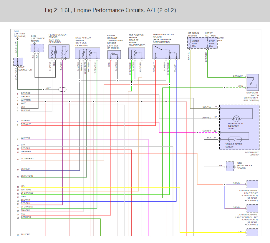

It sounds like you have good compression. here is the engine wiring diagrams you requested. Check out the diagrams (below). Please let us know if you need anything else to get the problem fixed.

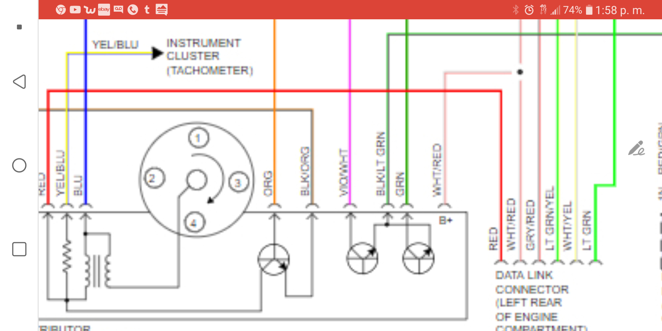

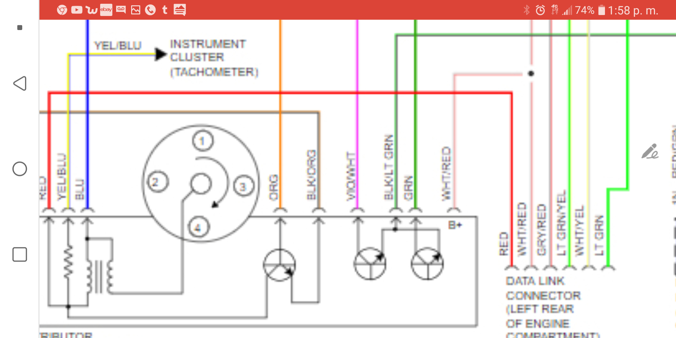

Hello. You send me the diagrams for the 6pin connector in the distributor, i make the changes, but i still not have current on the spark plugs. I check the pin for current and have voltage from the battery and return.
It would be possible that there's another diagram for that car?
I send to you the vin number of the car, for a maybe.
Vin number mazda mx3 1994 1.6l dohc
Jm1ec4359r0319261
If note on the video the rotation is counter clockwise.
On diagrams of the firing order i found it says that the rotation is clockwise. I check the cylinder number one and the rotor. Piston number one on top death center and the rotor match with the piston. The spark plugs cables are right 1-3-4-2. In that order, but at the same rotation of the rotor.
I think, maybe it's possible, that their is another wire order for the 6 pin plug? Let me know what you think and found. Thanks.

In the diagrams the rotor does turn clockwise so don't worry about that. Double check your work using the wiring diagrams above it is a six wire. Use this guide to check your work:
and

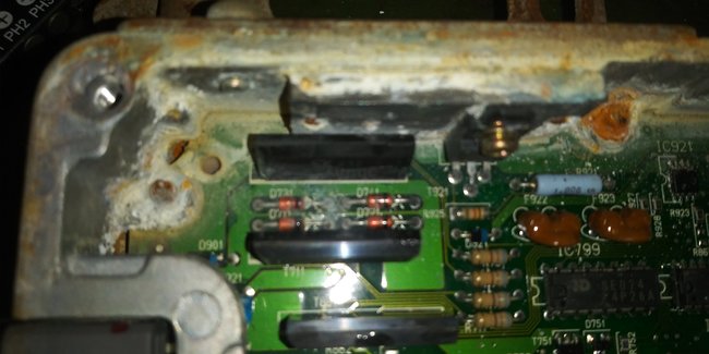

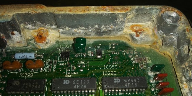

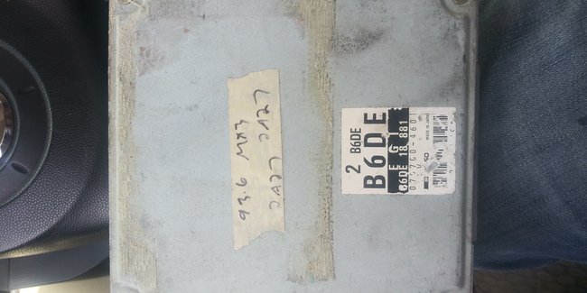

sorry i don't send this photos with my last reply. this is the ECU, ECM inside. is damaged.
Jun 10, 2019 at 5:49 AM
  • 55,433 POSTS
Yes, this is bad. please get a replacement and let me know what happens.
Jun 10, 2019 at 6:55 AM
MONCHO6685
  • 118 POSTS
I will let you know.
Jun 10, 2019 at 7:50 AM
MONCHO6685
  • 118 POSTS
Hello Ken. The part# for the ECU, ECM is b6de18881? For manual transmission.
Vin jm1ec4359r0319261.
Thanks.
Att. Juan Marin
Jun 11, 2019 at 7:16 AM
  • 55,433 POSTS
The numbers should match the old ECM do they?
Jun 12, 2019 at 4:47 AM
MONCHO6685
  • 118 POSTS
It's written with black sharpie.
I let you know if it's work.
Thanks, ken.

i have problems with this wires:
the green -
the violet white -
they are grounds to the computer, right?
if it's possible i need the complete diagram of the wires to know where exactly they go. i have current in the secondary circuit now but intermittent.
i used to test the circuit:
1) test light
2) noid lights
3) multi-meter
4) jump cables
that distributor have the pickup coil and the coil in the same piece.
the engine almost start, but i have to see that two wires. i think the problem is there. what you think??
Jun 25, 2019 at 9:48 AM
  • 55,433 POSTS
You have the engine wiring diagrams on the 4th post and a guide to help check them, please do some testing and get back to me.
