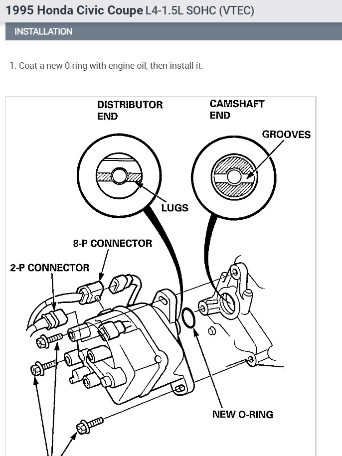

The car listed above is a coupe with a G23vtec swap. Chipped p28 ECU. New dizzy. New TPS.
Jul 25, 2023 at 7:45 AM
Experienced Mechanic
55,721 POSTS

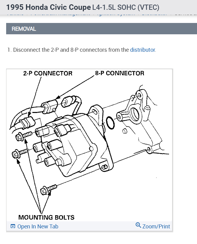

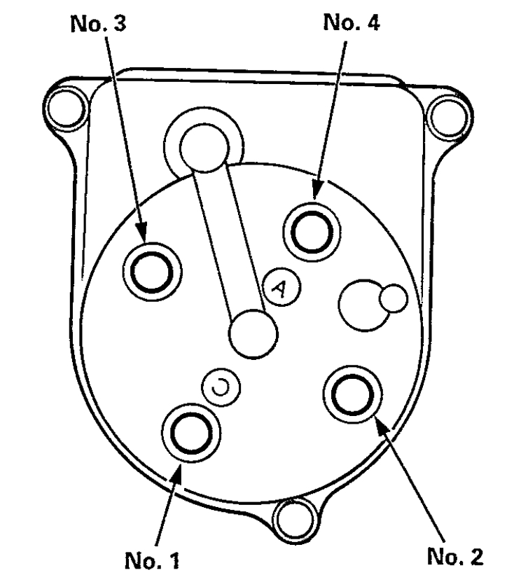

Any codes? here is a guide to help you run the codes, but it sounds like the ignition distributor is bad.
Check out the images (below). Please let us know how it goes
