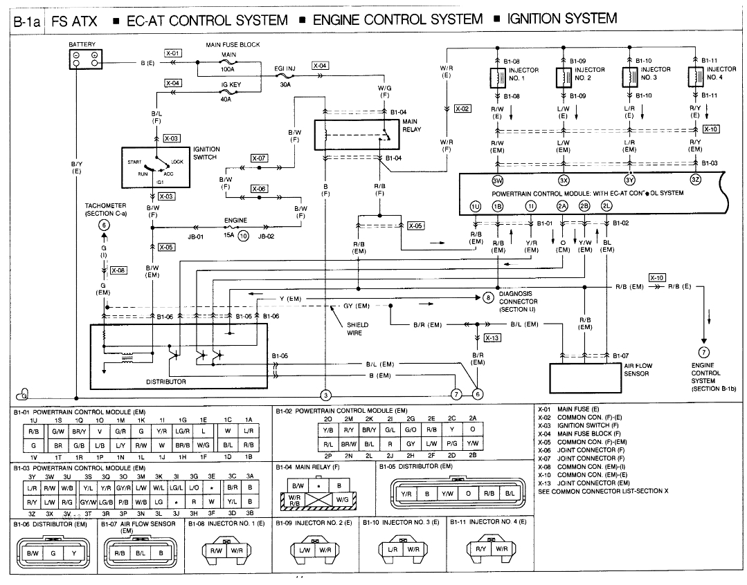

Hi, i pulled my distributor to pieces a while ago. I put back together and motor only just fires, now inside the distributor the wiring does it matter which way the wires go for instance which is positive on coil? I have a black/white wire which has 12-volts and green wire to coil which way round do the go then we have the camshaft shat sensor or hall sensor optocoupler with two wires blue and green. Which way do they go? please if anyone has a picture or diagram a simple one of inside distributor be so good.
May 11, 2023 at 1:28 AM
  • 55,433 POSTS
Here is a wiring diagram of the inside of the distributor. Check out the images (below). Please let us know if you need anything else to get the problem fixed.
May 11, 2023 at 4:56 AM
GLEN28
Hi thanks very much for that much appreciated, I have solved that problem now. I have a miss that comes and goes, more than not I've replaced distributor plugs and leads ,plugs twice ,fuel injectors ,fuel pump ,O2 sensor car has 140,000 on it 1 owner fuel regulator as well, can't narrow down the miss all plugs same reaction when 1by 1 taken off the only thing I find is when i take injector power off one it has nilly no change but also the injector can change to which one it is driving me crazy also I forgot the coolant temp sensor was done as well.
