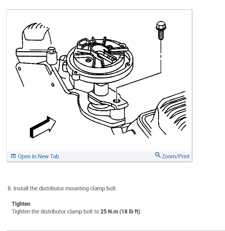

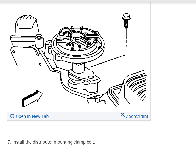

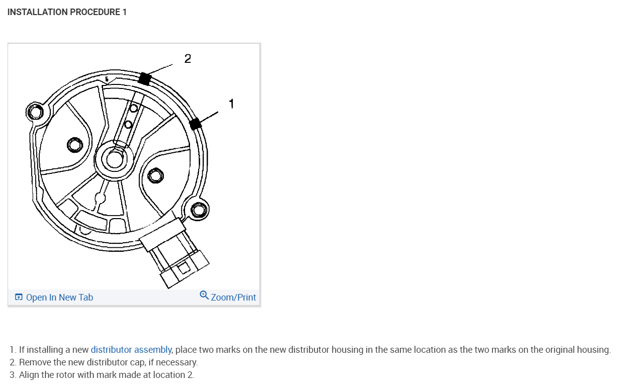

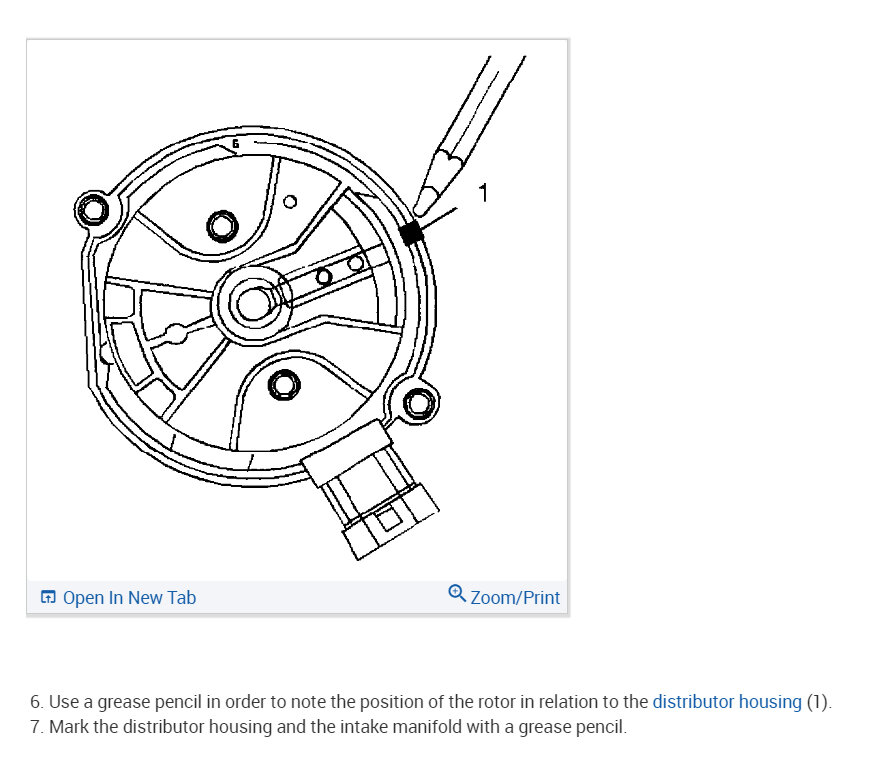

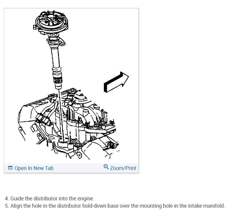

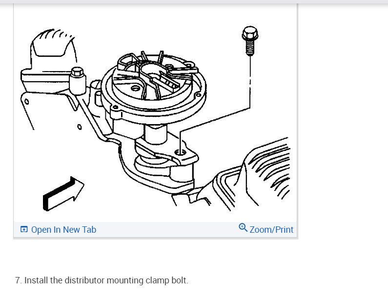

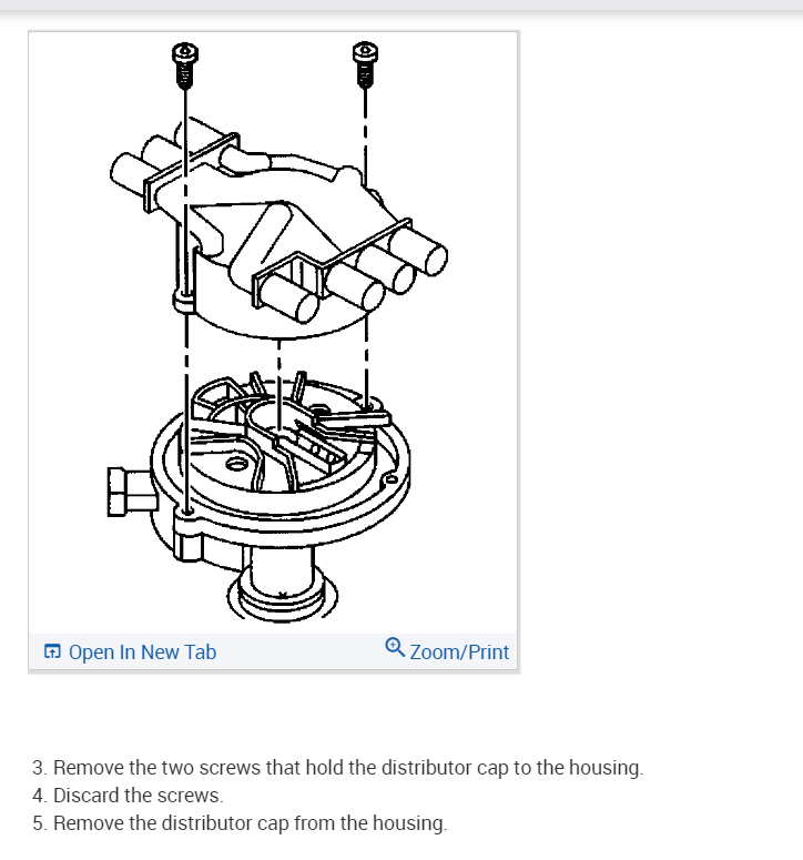

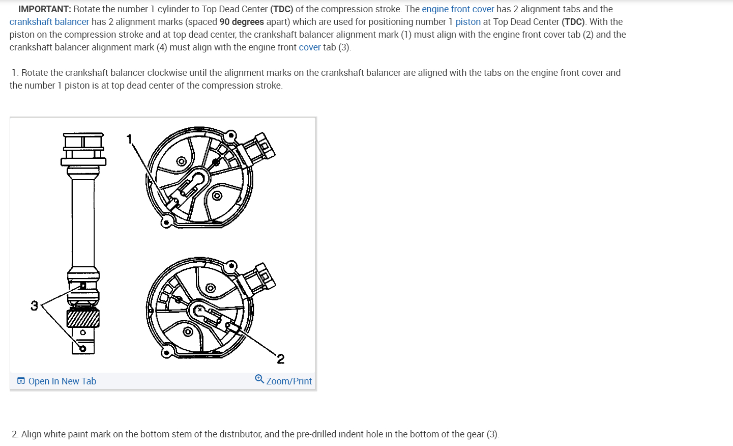

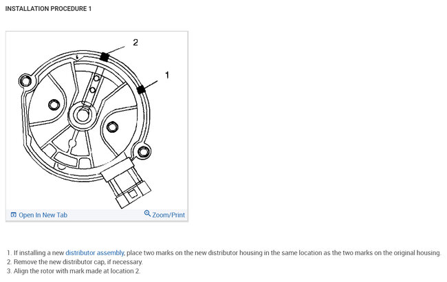

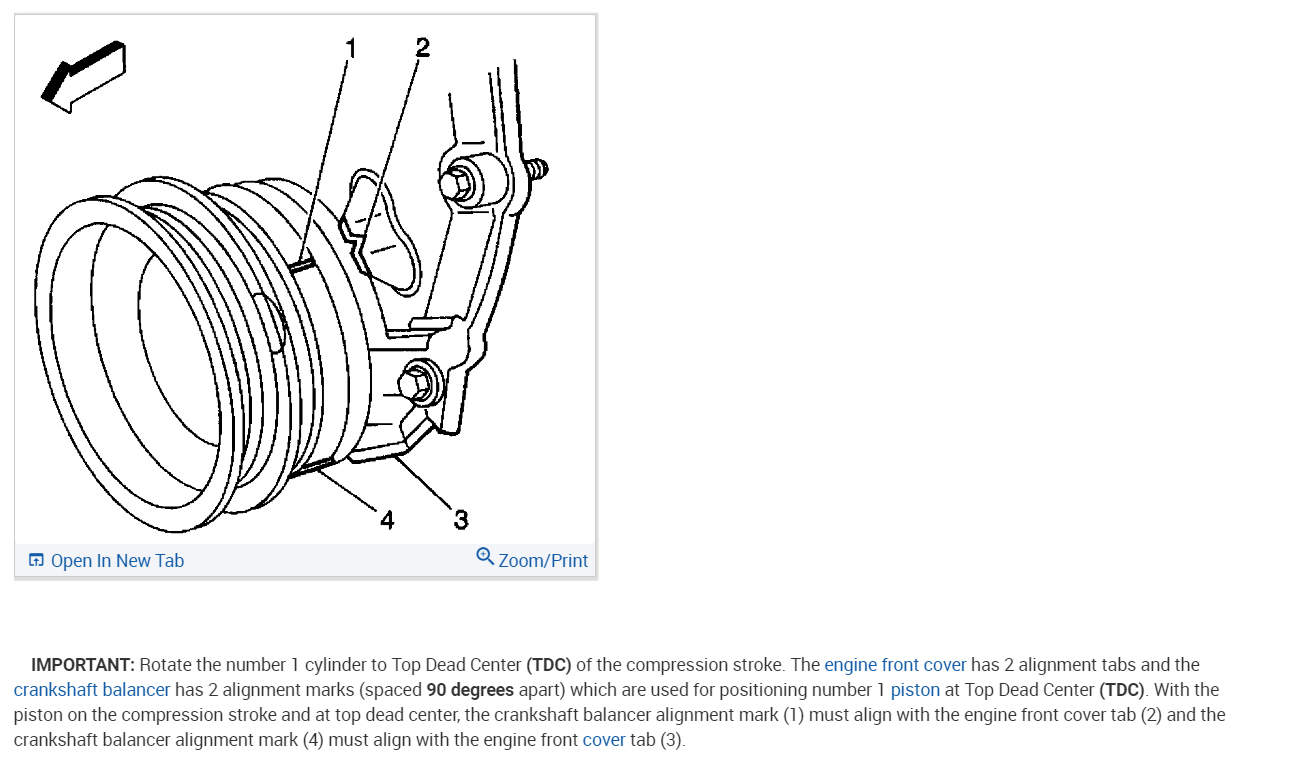

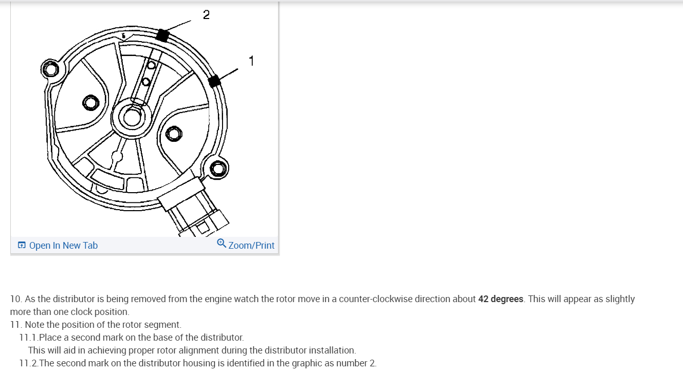

Truck was running fine changed the distributor and plugs and wires all new now won't start.
May 24, 2023 at 4:54 AM
  • 55,456 POSTS

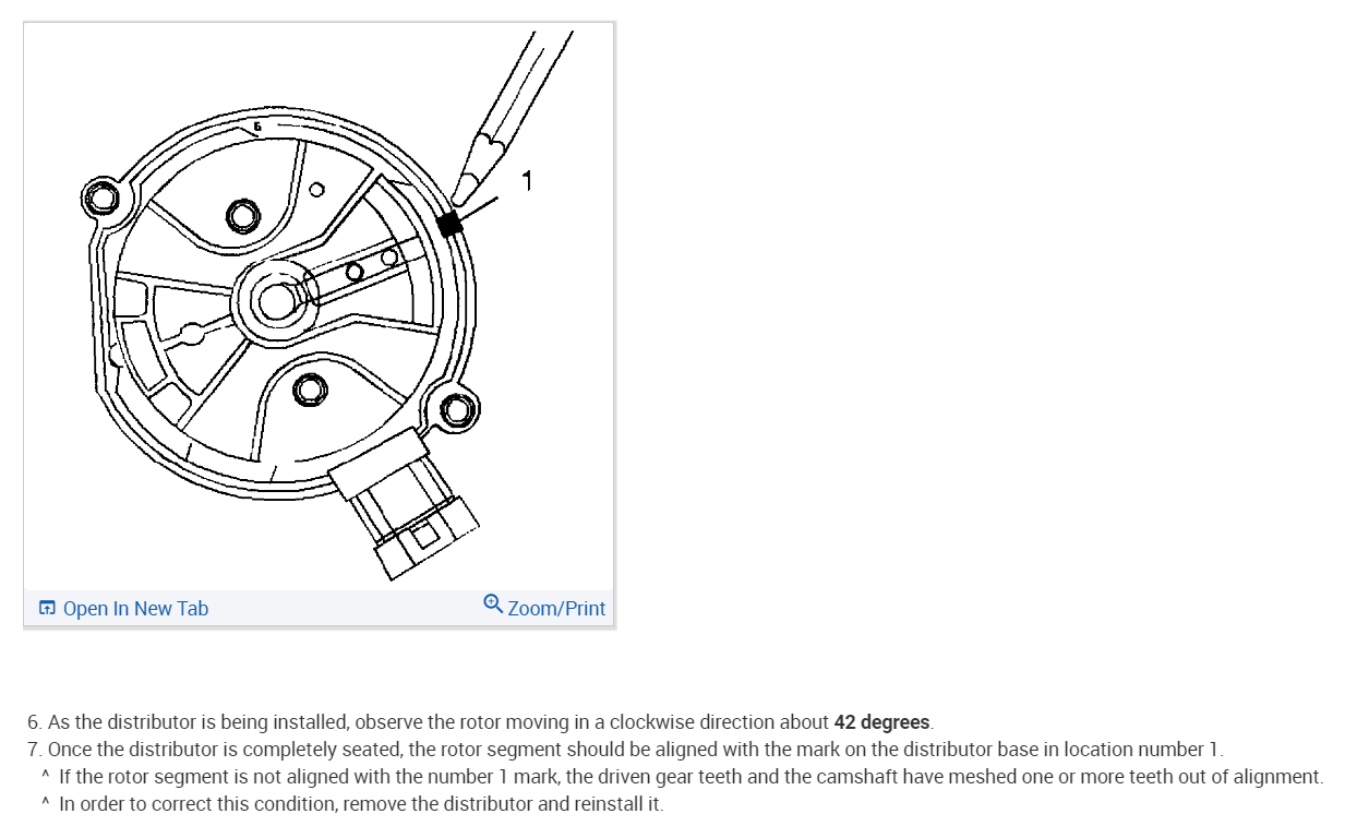

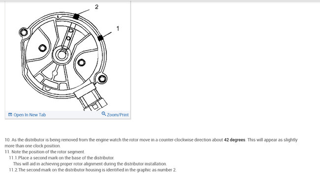

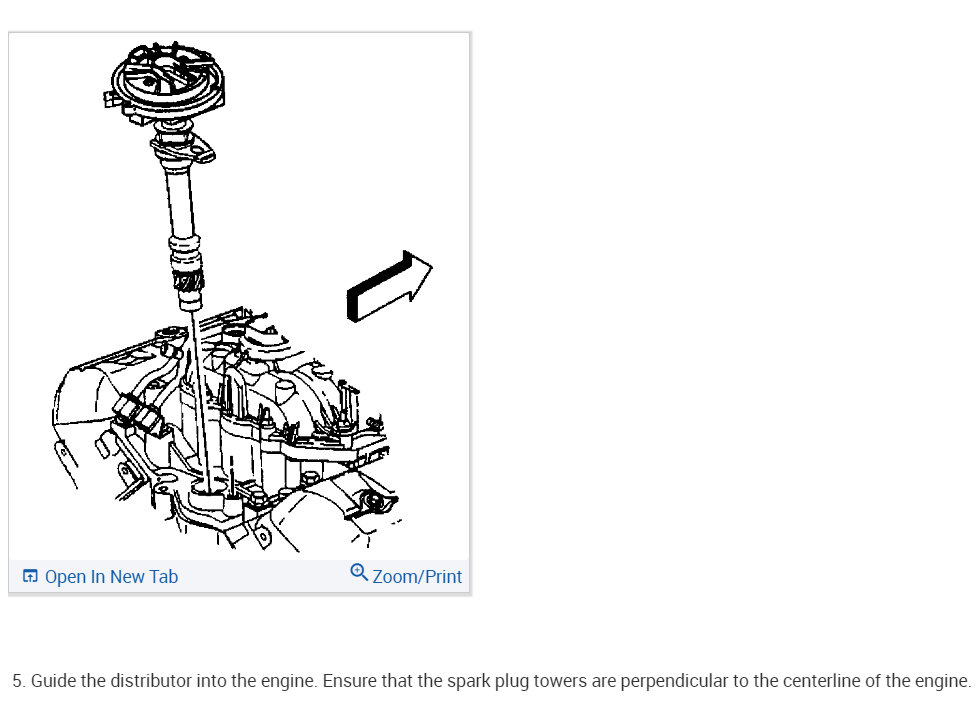

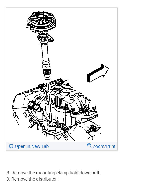

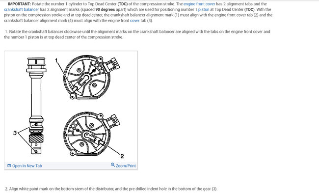

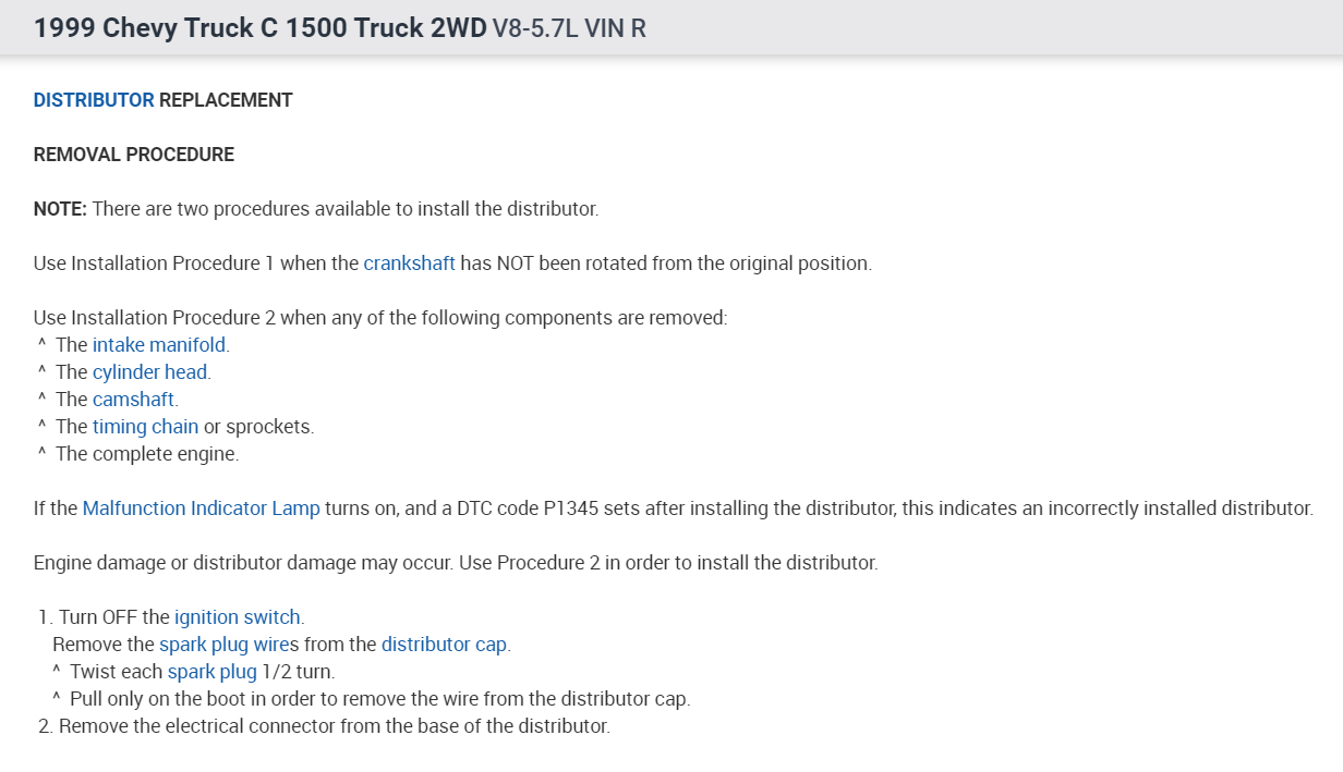

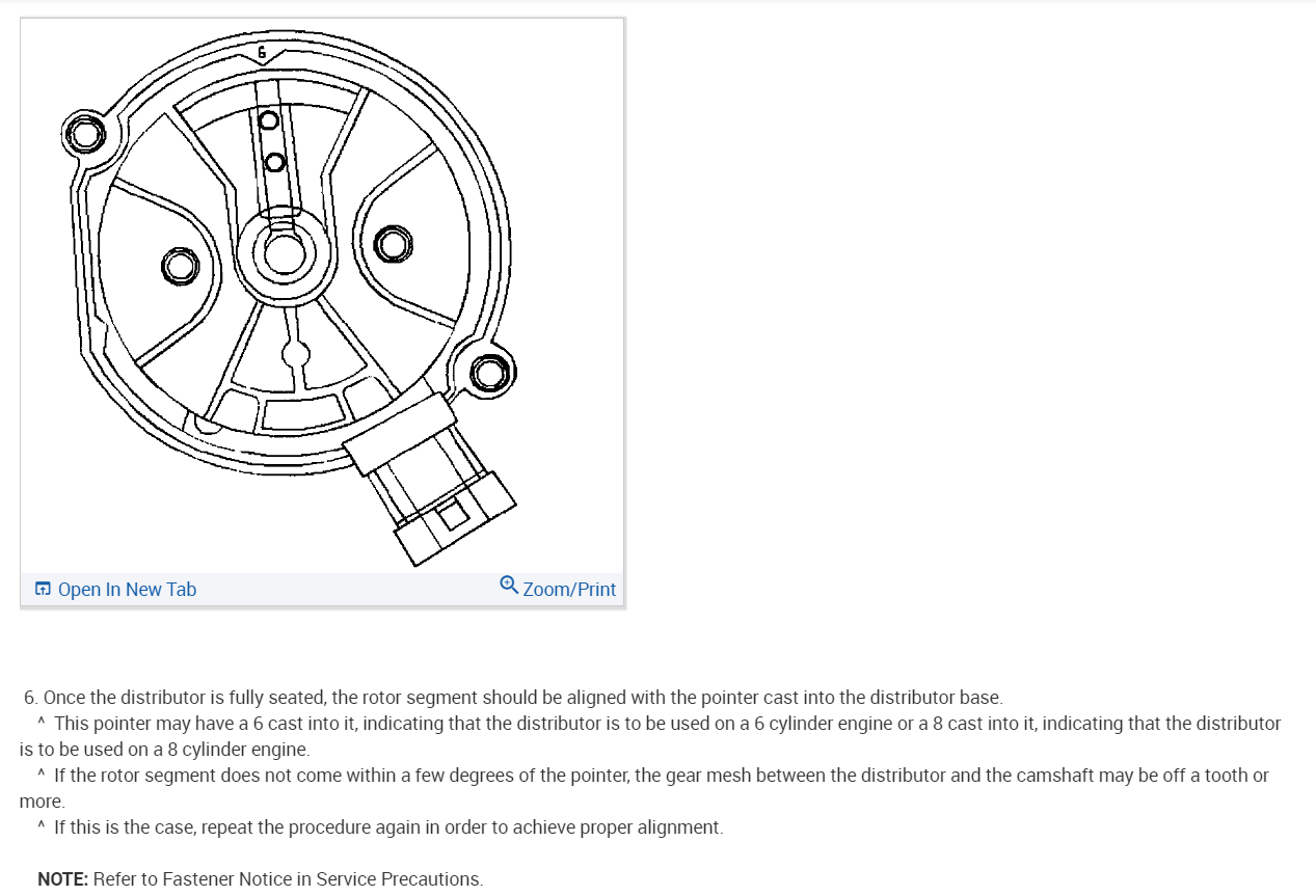

It sounds like when you installed the distributor you got it a tooth off which will make the engine not start. Here is how the unit is installed in the images below. This guide may help as well:
https://www.2carpros.com/articles/car-not-running-advanced
and
https://www.2carpros.com/articles/comprehensive-guide-on-installing-an-automotive-ignition-distributor-step-by-step-process
