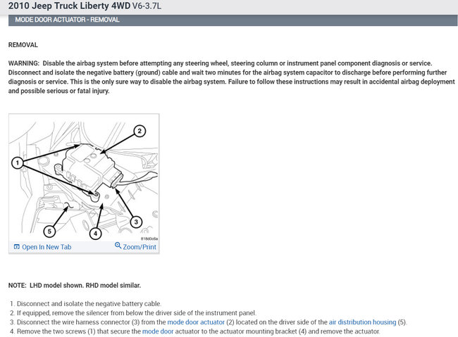

I have no A/C and the hot air will only blow through the defrost?
117,000 MILES • 4WD • AUTOMATIC
JALEFLORE
I need help figuring out how to replace the distribution box. I have no A/C and the hot air will only blow through the defrost. I removed the actuator to replace it, but the gears on the distribution box are stripped/broken.
Jun 9, 2022 at 6:03 AM
  • 55,746 POSTS

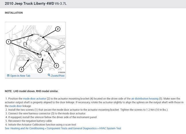

It sounds like the Mode blend door actuator is out, here is how you can replace the unit in the diagrams below. I have also included a generic guide to help you see what you are in for with the repair.
Jun 10, 2022 at 3:30 AM
