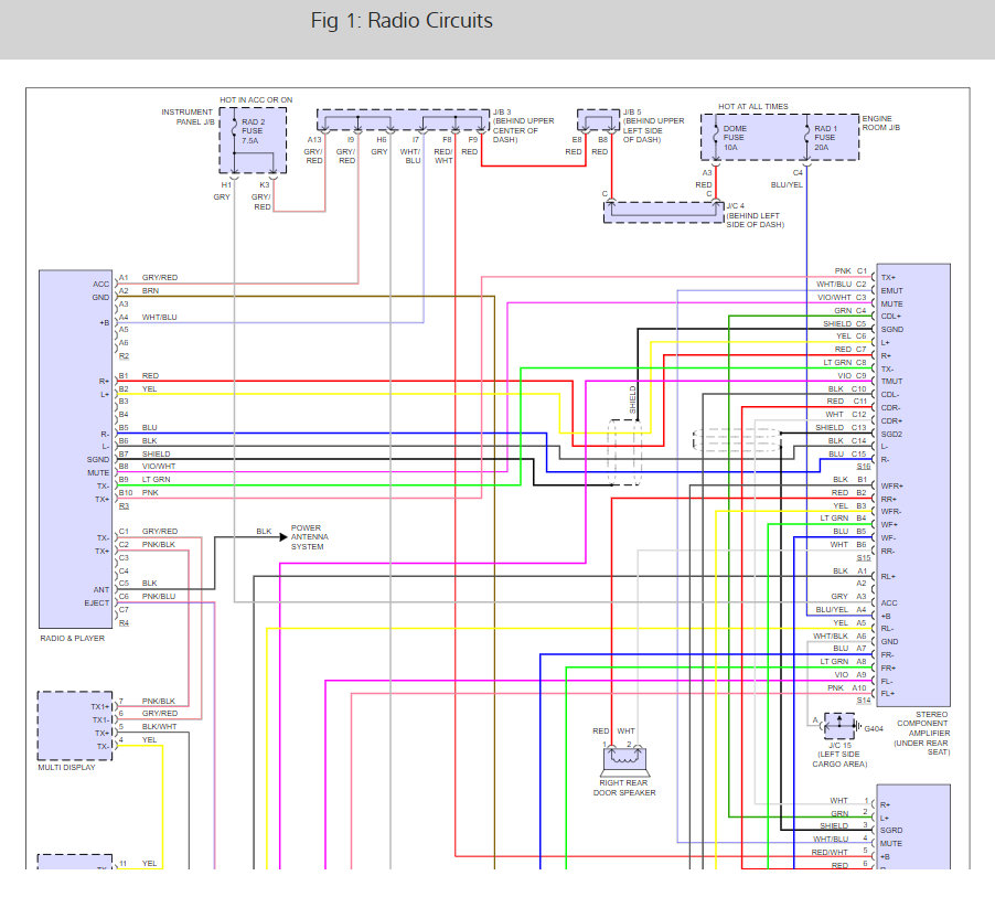

Display screen sometime come on then disappears when I restart the car. It has been off for a while now, but it comes and goes. I can still listen to radio and work A/C but no display.
Sep 5, 2018 at 6:39 AM
  • 55,423 POSTS

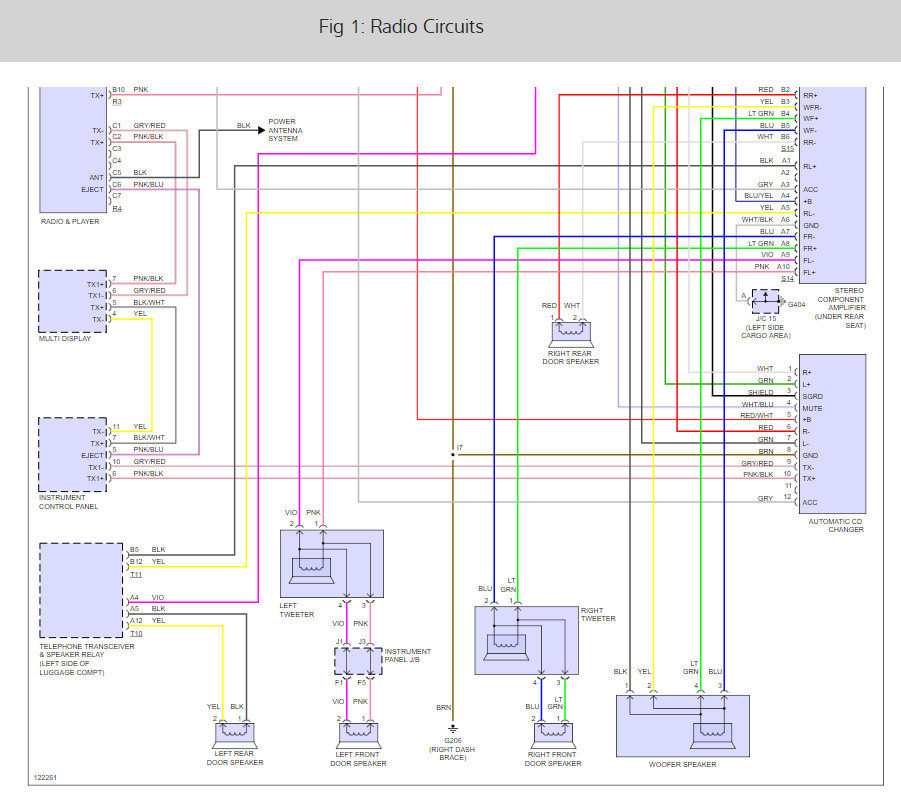

That fact that the display comes and goes it telling us it is a connection or electronic driver issue. The multi display is shared by many systems. Here is some of the wiring diagrams going to the display so you can see how it works. Nine times out of ten it is the display itself that need to be replaced.
