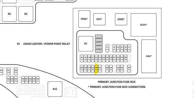

Good evening, the display screen in the car is frosty, do you know if it can be cleaned or replaced? Additionally, the radio used to work but it does not work any more. Do you know the cause and how to fix it? Thank you

Would you mind uploading a photo? Is it frosting around the edges?

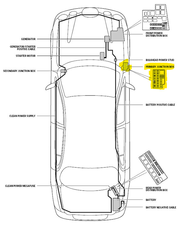

Is your radio not powering on? If so have you checked fuse 26 in the primary fuse box? (Highlighted in yellow)
