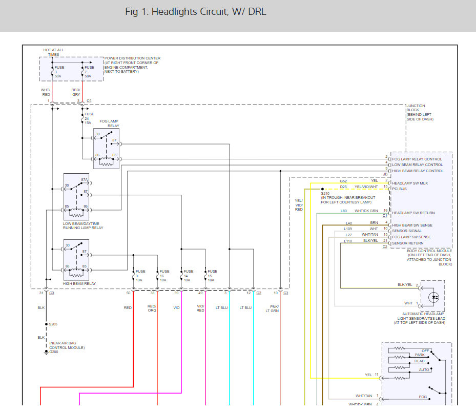

When i switch the headlight on ( only first position) the radio and dashboard display does not light. The sound of the radio work correctly. I will switch headlamp on second position every light (dashboard and radio) works correctly.

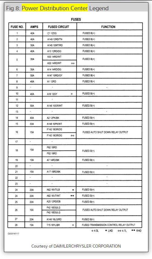

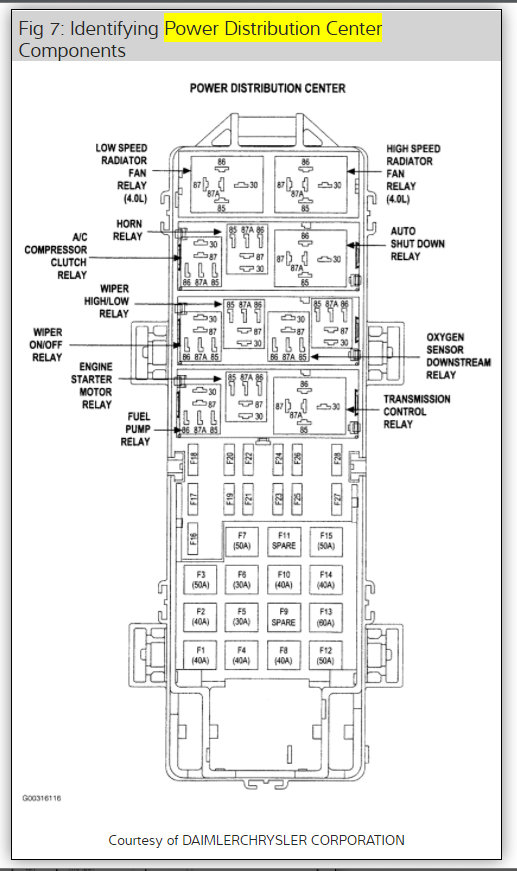

It sounds like the headlight switch is out. To be sure here is a guide to check for power and the headlight wiring diagrams so you can see how it works and to see which wires to check for power:
Can you please shoot a quick video with your phone so we can see what's going on? that would be great. You can upload it here with your response. Check out the diagrams (below). Please let us know what you find.

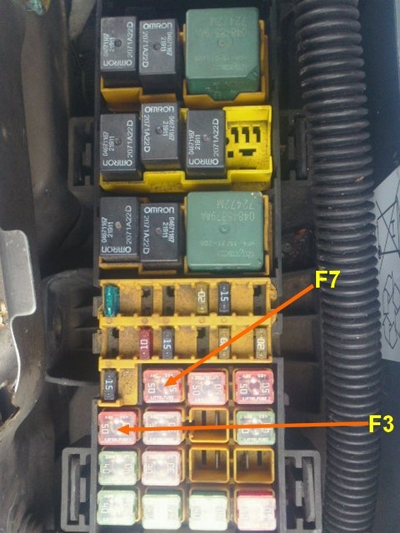

Thanks for the video. lets check fuse # 3 and 7 in the fuse panel under the hood. here is a guide to help test for power and the fuse locations as well:

I check both fuse as indicate , they are good and nothing change.
Note that radio and mileage display shuts off only when i switch on low beam.( first position) on high beam (second position) they light correctly.

I would recheck the wiring to the headlight switch and then replace the switch. Please let us know what happens.

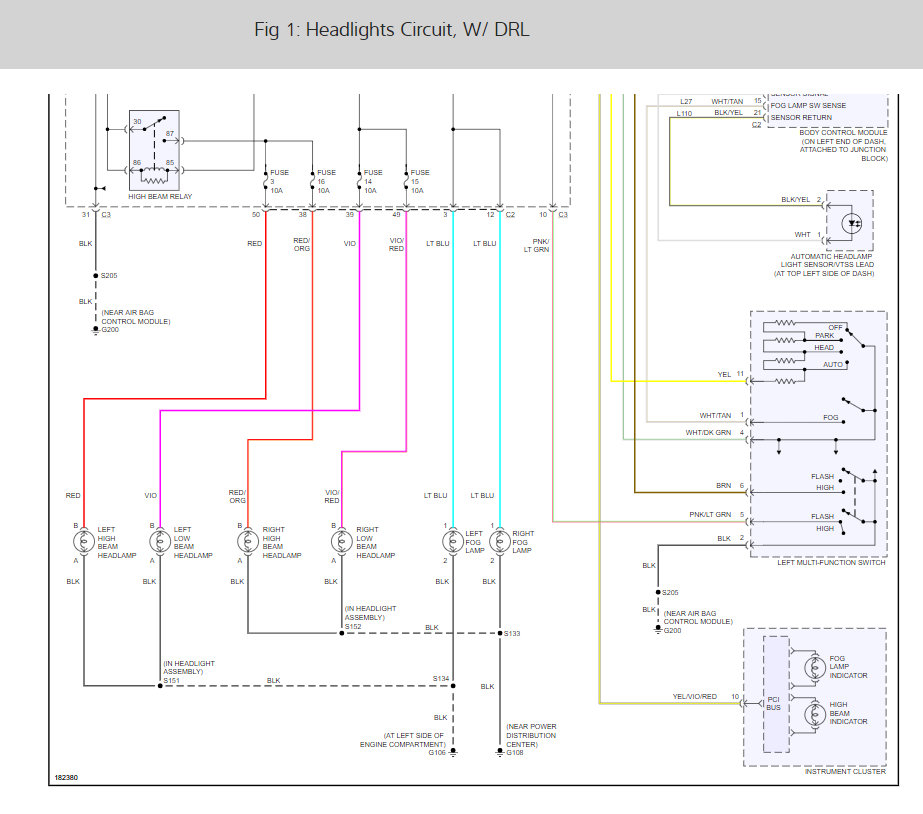

yes, but i do not know how to test the wire. so many.

This guide should help use the headlight switch wiring diagrams above:
