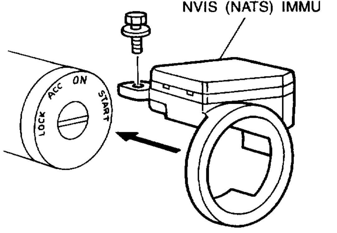

Key fob works. Full dash illuminate, key in on position security light solid. Key out blinks. No crank.
Oct 26, 2024 at 9:00 AM
STEVE W.
  • 15,349 POSTS

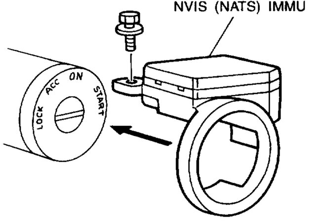

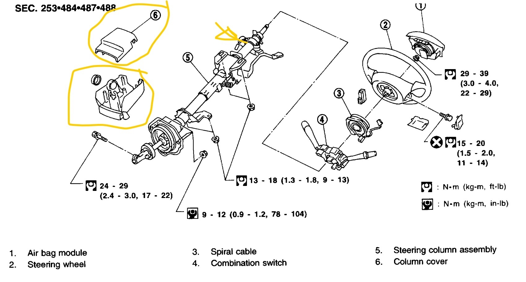

Nissan uses a split system like many others, the fob uses one system, but the keys use a different system. The security light on solid means that part of the key recognition system has failed. The most common is the NVIS module on the steering column. Its job is to send out a pulse that triggers the transponder in the key, which sends out a code that the NATS then looks in memory for. If the code matches a valid key code everything works. If not, you can get a no start like you have. Testing it requires a scan tool to read the immobilizer and see if it responds, or you can do what many who don't have that do and just replace the NATS module and see if they can get it to work. To give you an idea of how bad their support can be, the first image is all they list in the remove and replace directions for the module! However, to make it easier you will need to remove the upper and lower covers on the steering column by looking under it and removing the screws, then there are clips that hold the halves together. Once off the NATS module can be replaced. Then you need a scan tool to initialize the replacement NATS.
