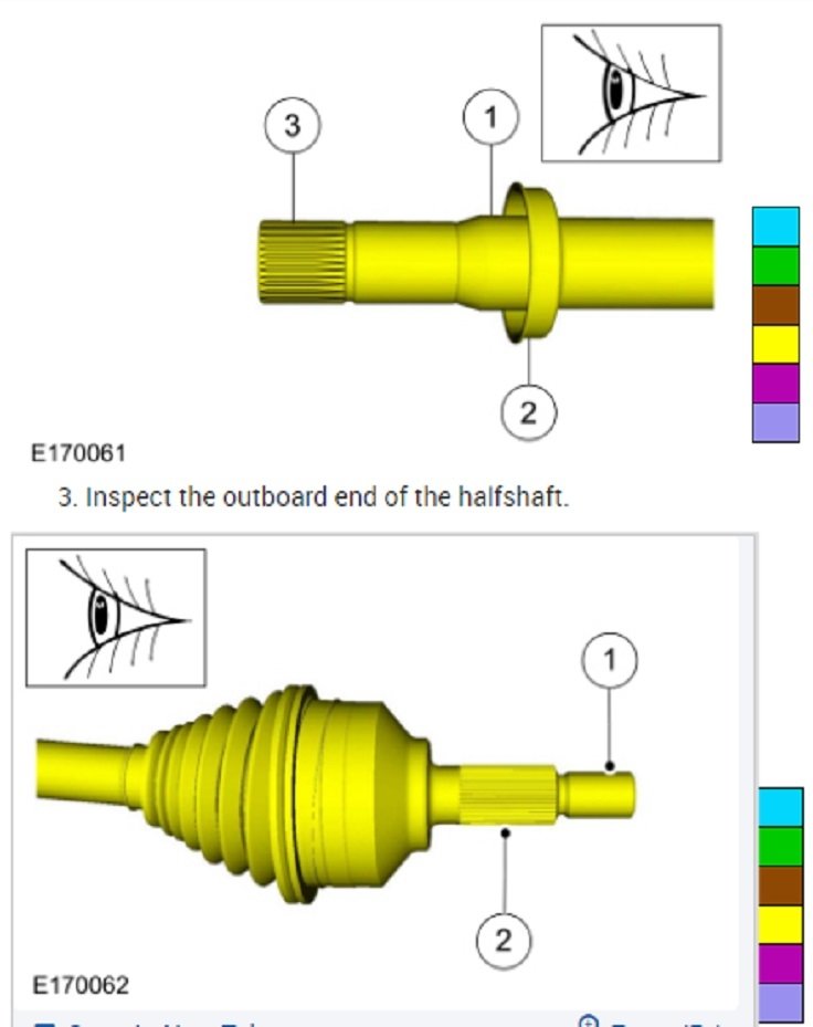

I wasn't able to find a drawing of the separate parts, probably because Ford expects the entire half shaft to be replaced, but I do know that you can buy all of the individual parts for Chrysler CV joints from the dealer's parts department. You might consider asking at the Ford dealer if they show the separate parts in their parts catalogs.

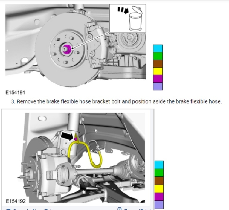

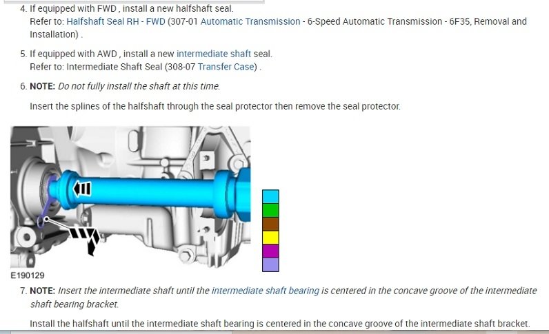

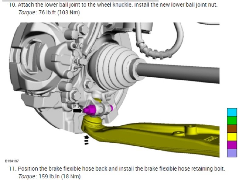

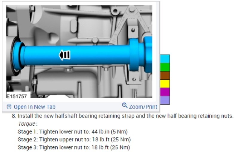

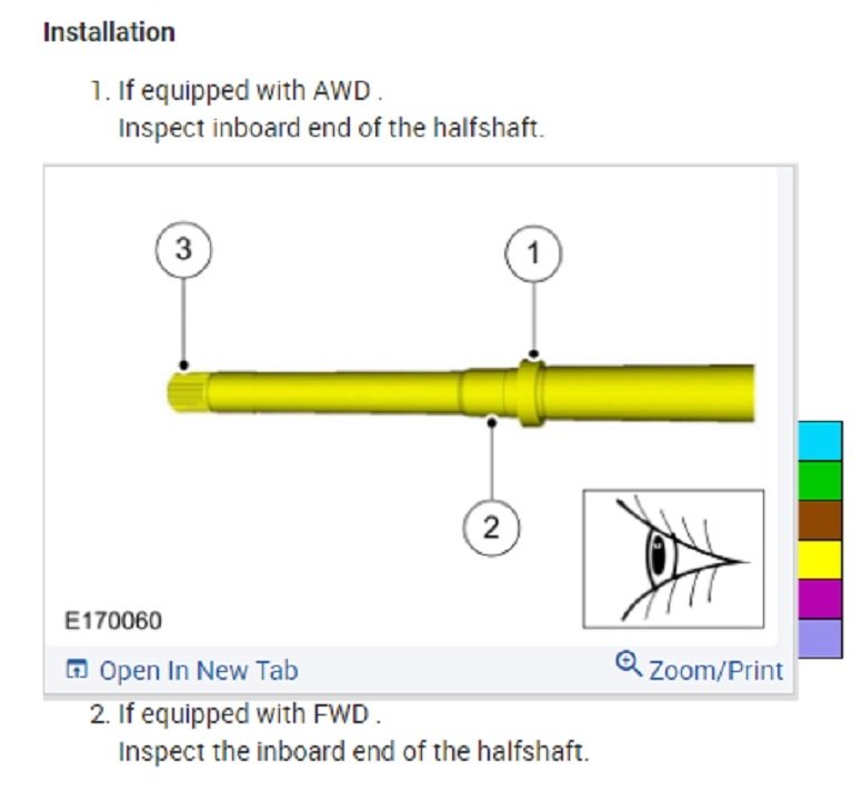

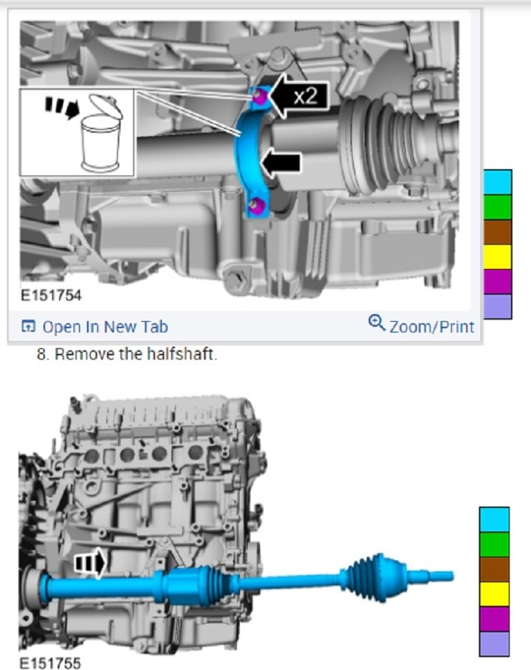

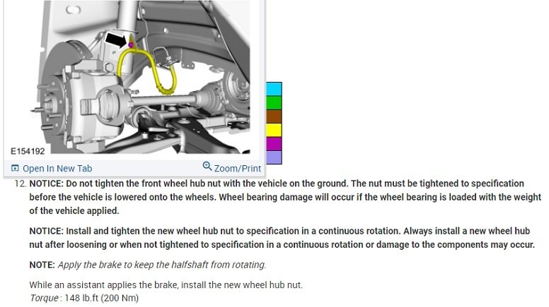

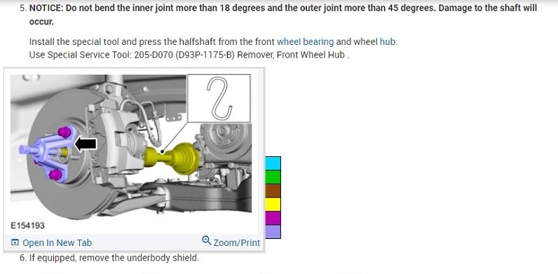

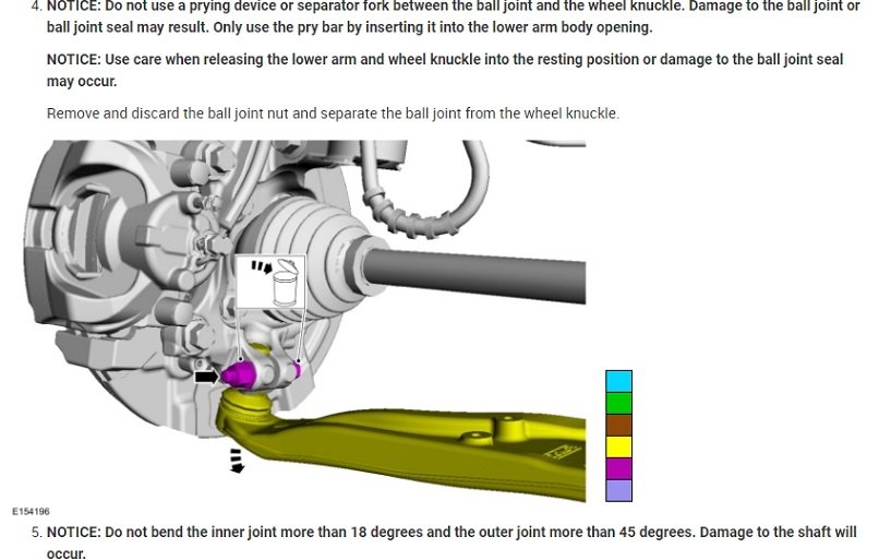

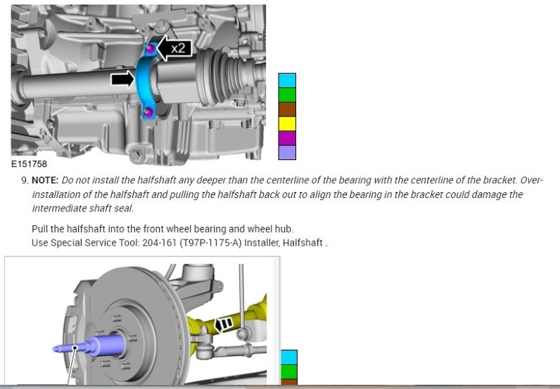

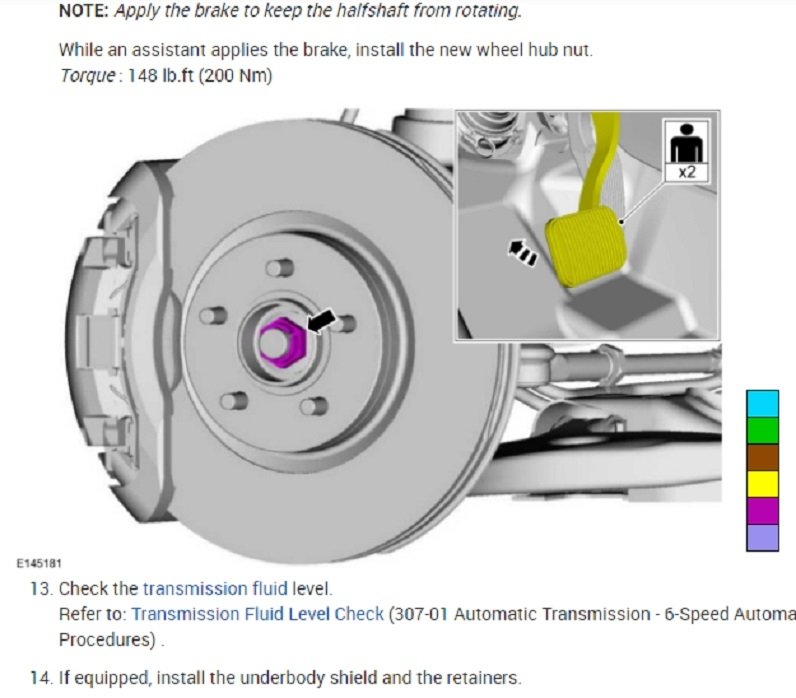

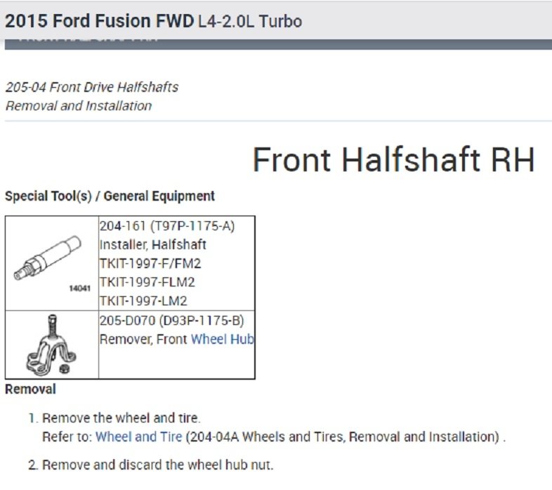

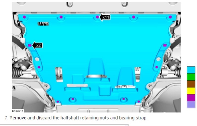

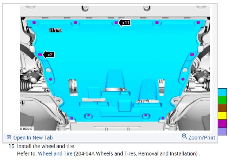

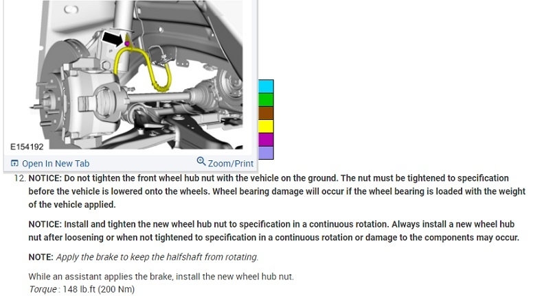

If it will help, here's Ford's procedure for replacing the half shaft. The torque specs are included. I also noticed they say the axle nut on the outer joint is a "torque-to-yield" nut which means it's a one-time-use nut and must be replaced every time it is loosened. Copying these instructions was kind of cumbersome. If I accidentally cut something off, or if you can't read any parts, let me know and I'll try again.
Also be aware to never allow any vehicle weight to sit on the wheel bearing when that axle nut is not tightened to specs. I warn about that all the time, but this is the first time I saw that warning included in this procedure. Setting any weight on the bearing when the nut is loose will instantly make it noisy. It will make a buzzing noise like an airplane engine.
