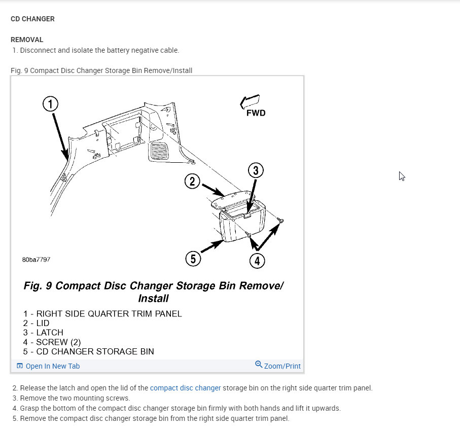

So my battery is getting drained and I can hear the CD player shuffling now whereas I didn't beforehand. I'm thinking that may be draining my battery but I can't find information anywhere about how to disconnect it. Any one know?
Aug 14, 2020 at 4:39 AM

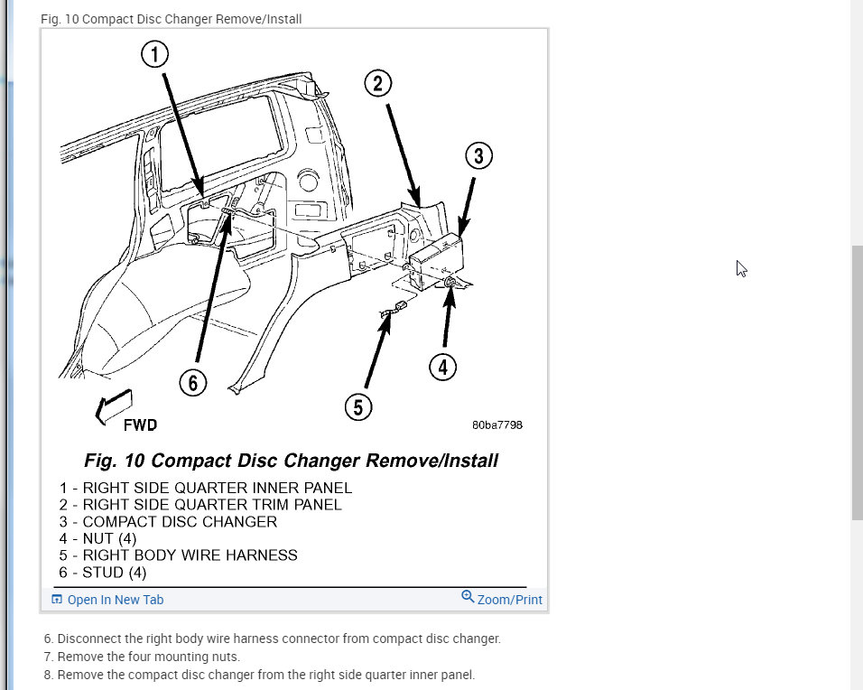

Normally you can just remove the fuse but this vehicle has a BCM and no fuse just for the CD changer. So that means you need to go to it and unplug the connector directly from the changer.
I included the procedure on how to access it. Once you do, you just need to disconnect the connector and secure it so it doesn't cause a noise while driving.
Let me know if you have other questions. Thanks
