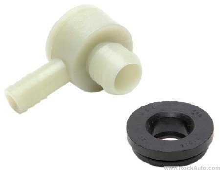

Thanks, and at this point think you were on the right track. I tested the valve while on the car, seemed to work as it should. Decided to remove it from the booster to check off the car. When i pried it out of rubber grommet, I heard an instantaneous vacuum realease, which I didn't expect. Reassembled started car and has worked fine for last week. Can't rationalize what the root cause is, or how to prevent, but something going on with the valve for sure.
Jun 4, 2017 at 11:38 AM
STEVE W.
  • 15,312 POSTS
OK you pulled the check valve (see image). The valve I was referring to is inside the booster itself.
Releasing the vacuum when you remove the check valve is correct it locks vacuum in the booster.
This video explains the internal valving and reaction disc. I believe you have an issue with those valves. The problem is that it's intermittent and not real easy to test because of that.
