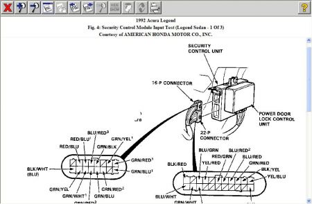

CSCHMITZ
Hi, can you pleas tell me, how to deactivate the alarm system?
When i pull the fuse of the horn, it is deactivated, but the horn also.
I don´t need the system.
I wished i could take the module completly out. Where is it lokated?
Thank you very much for any tips.
Yours, Christian
Mar 19, 2019 at 3:57 AM (Merged)
KHLOW2008
  • 41,814 POSTS
Hi Christian, Try unplugging the module under dash on driver's side.
https://images.2carpros.com/forum/automotive_pictures/192750_AlarmControl92Legend_1.jpg
