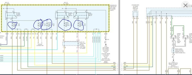

Driver side head light assembly shorted out due to a broken wire touching the metal bumper
2007 CHEVROLET SILVERADO
140,000 MILES • 5.3L • V8 • 2WD • AUTOMATIC
ROB K
  • 6 POSTS

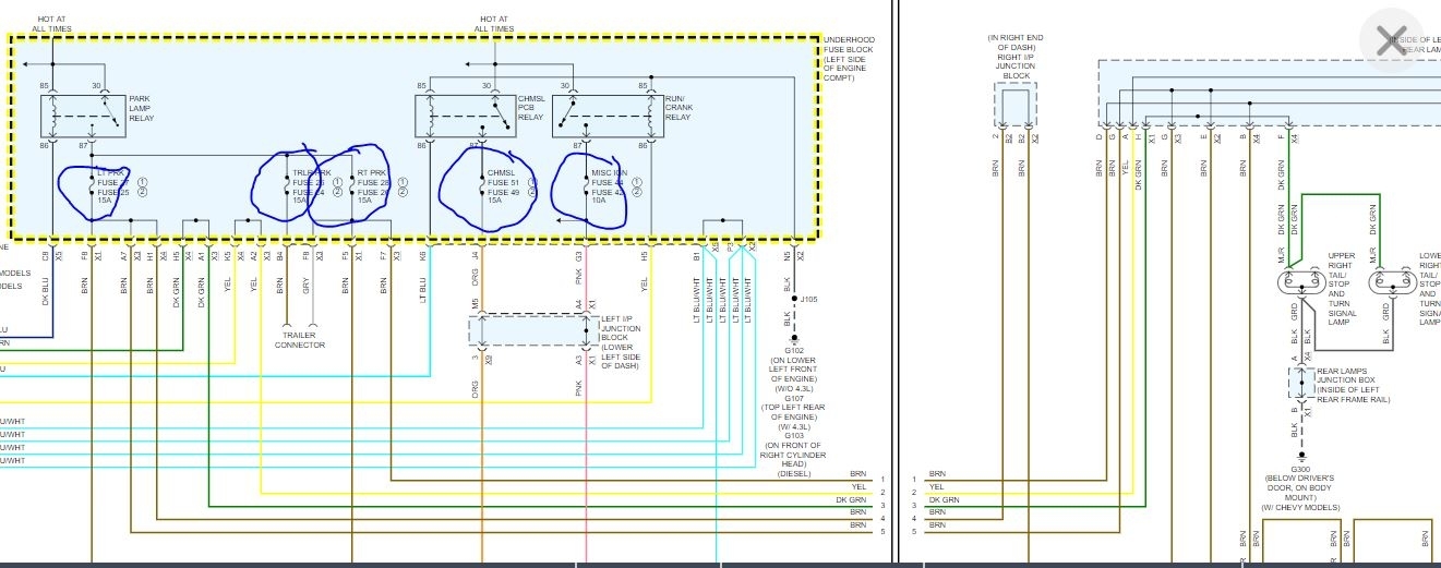

I was in the process of changing turn signal bulbs out for switchbacks today. In the process the main headlight after marketing wiring red and black wire broke. The red wire was broken and came into contact with the bumper of the vehicle while the vehicle was on and it shorted out the driver side headlight hi lamp, and DRL. It also knocked out the driver side tail light whole assembly (park, DRL, and brake lamp) it also knocked out the driver side license plate illuminator.
Apr 27, 2020 at 11:14 PM
Good morning,
Did you repair the broken wire?
You need to test the fuses I highlighted in the diagram I attached below for power on both sides. It looks like you blew a fuse when the wire touched ground..
Make sure you solder and shrink wrap the repair on the wire. Butt connectors are not a good repair.
Apr 28, 2020 at 4:29 AM

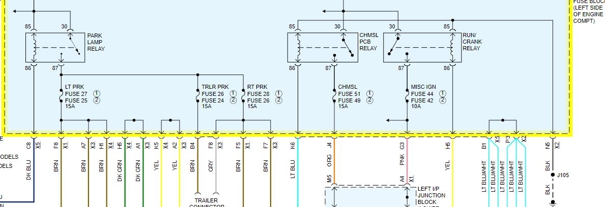

This is for a 2007 nbs Silverado? The images of the wiring diagram and fuses are hard to read the blue circle covers the fuse numbers in image 1.
Apr 28, 2020 at 11:50 AM
Okay, sorry about that. I blew it up even bigger for you without the circles.
Make sure you test for voltage on both sides of the fuses. These boxes had a high failure rate for supplying voltage.
Apr 28, 2020 at 12:03 PM
ROB K
  • 6 POSTS
Thanks. repaired the wire and all the fuses you suggested. Everything works now. However, I still have a hyper flash issue on the passenger side headlight and tail light. Can you inform me of the relay that is responsible for this function?

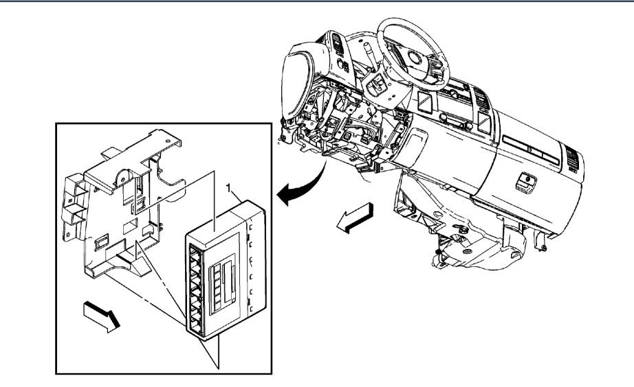

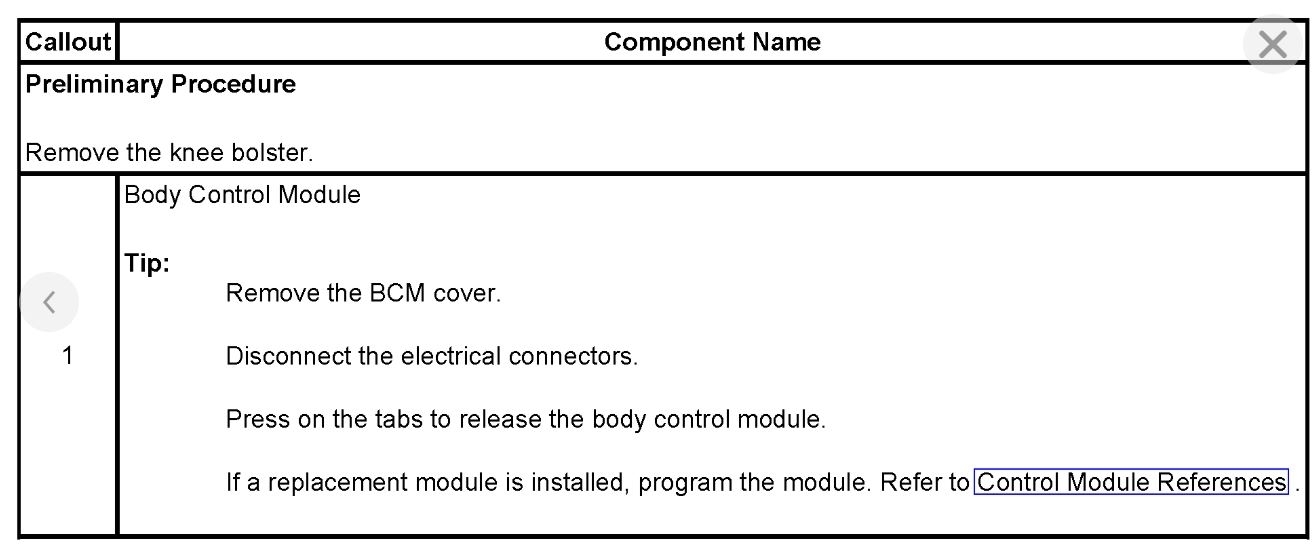

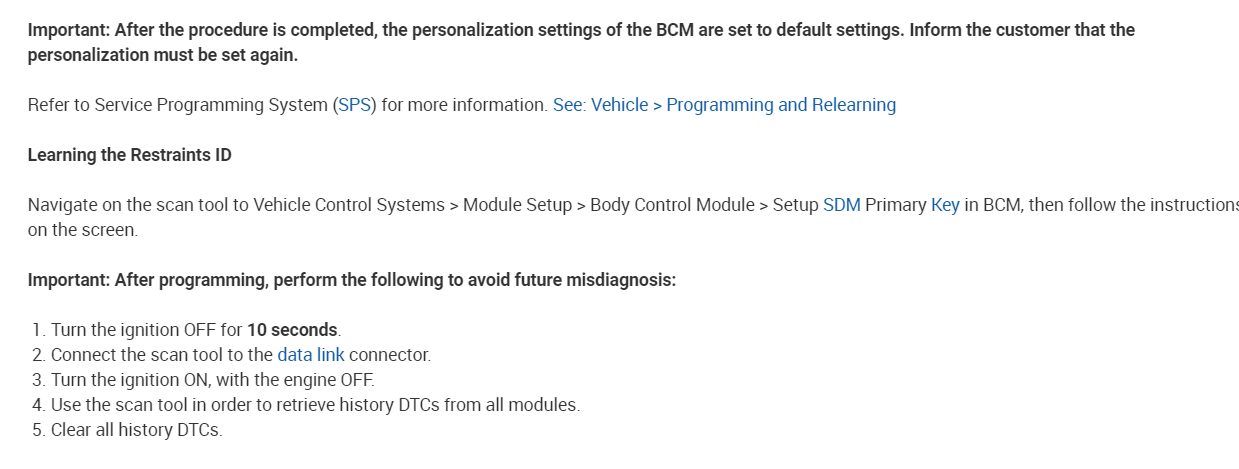

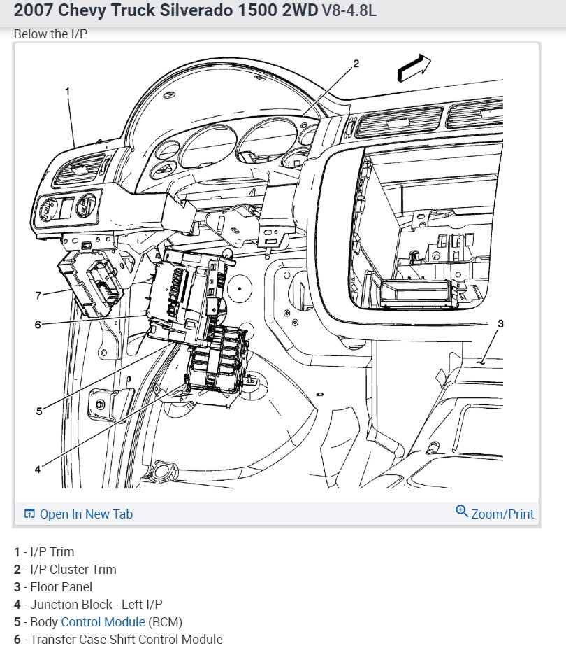

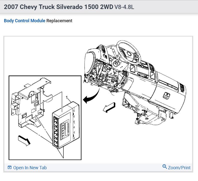

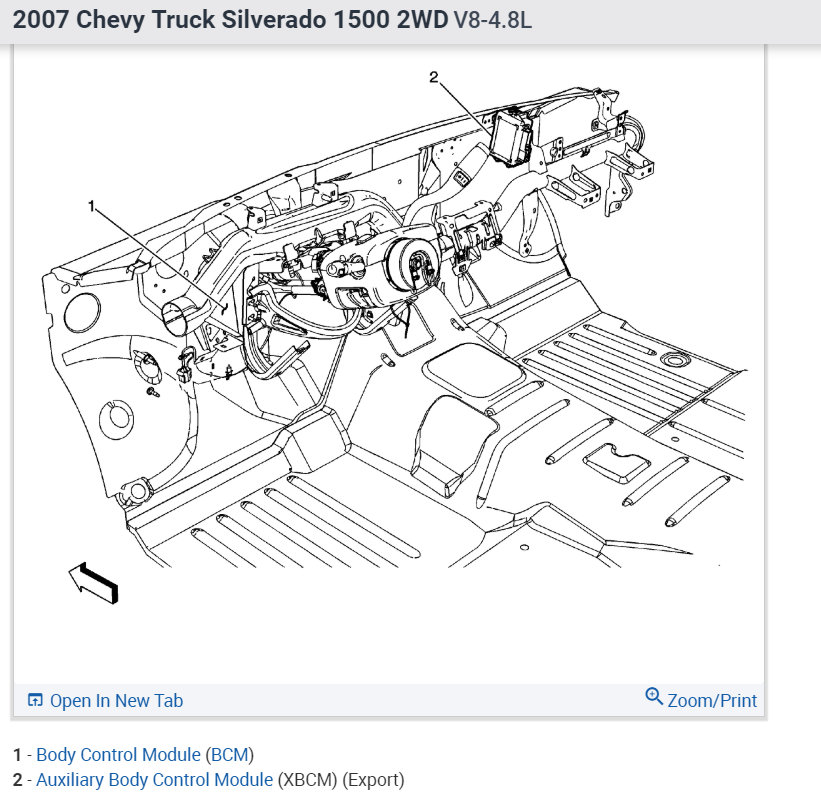

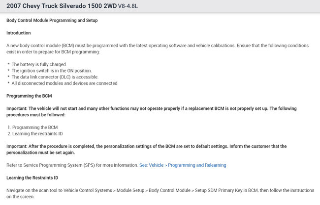

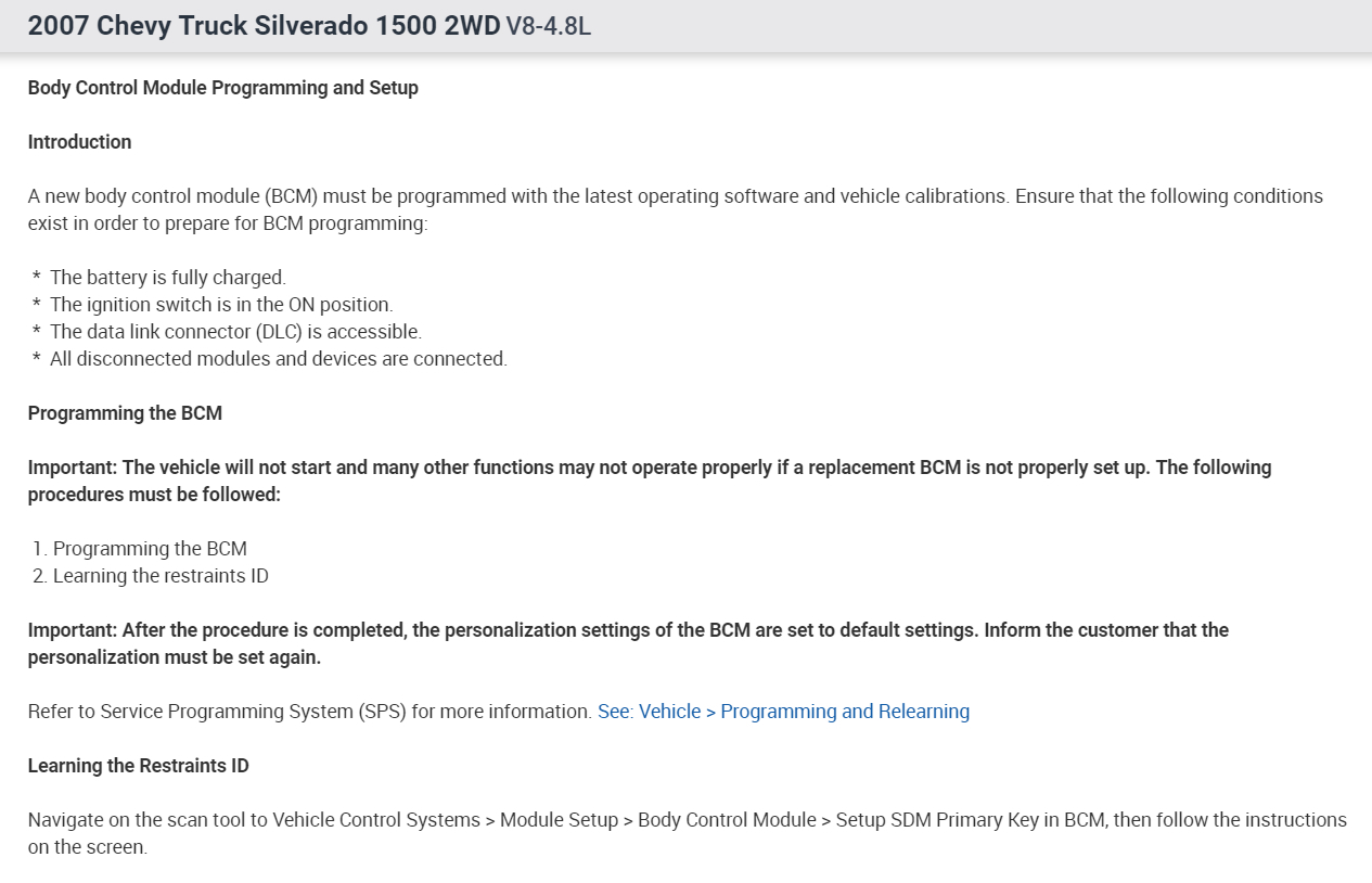

This vehicle does not use a traditional hazard/turn signal flasher. This function is controlled by the Body Control Module (BCM).
There is no flasher as in the old days.
The BCM controls the speed of both 4 way and turn. It may have been damaged from the short circuit issue.
I attached a picture of the location and the procedure for you. It is a programmed module.
May 2, 2020 at 3:53 AM

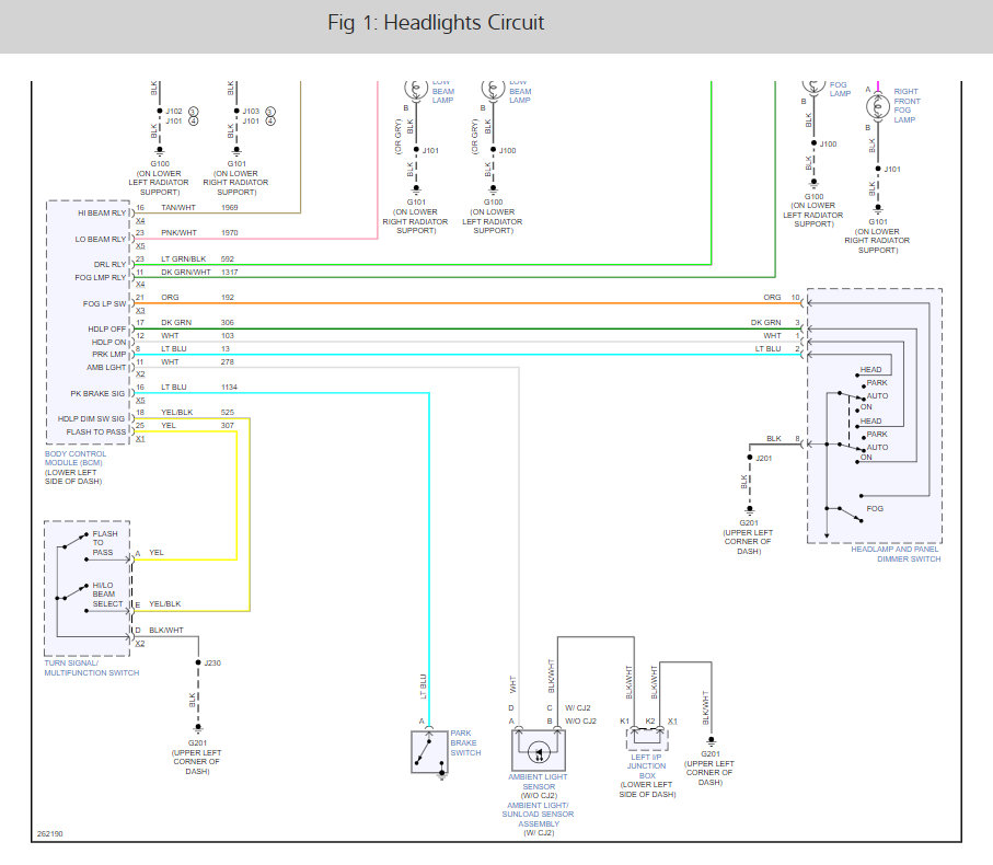

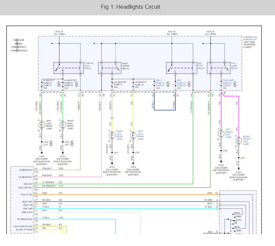

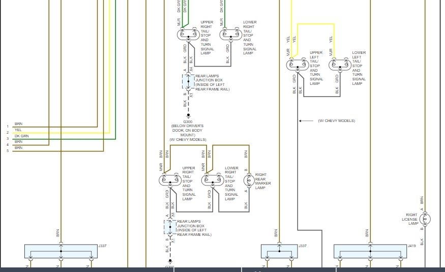

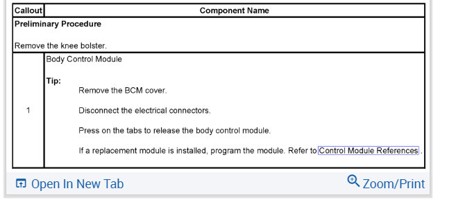

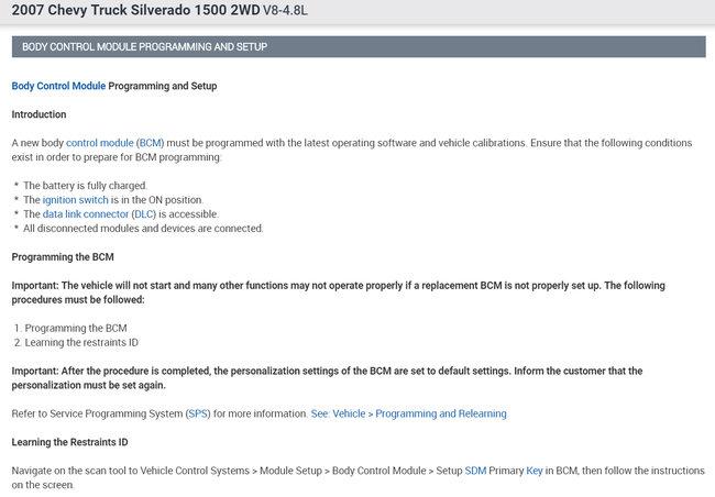

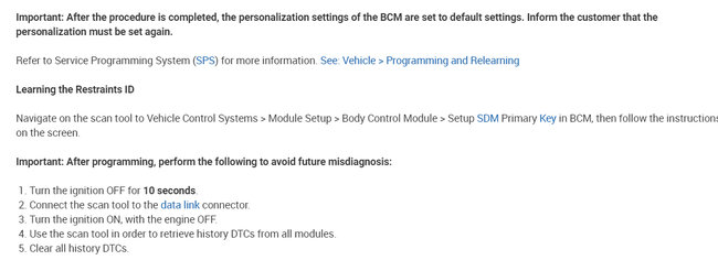

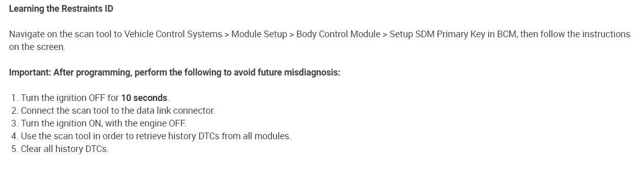

It could, but I would check the system grounds. here are the complete headlight wiring diagrams so you can see how the system works and where the grounds are. If the grounds are good the BCM needs to be replaced here are the instructions for that as well. Check out the diagrams (below). Please let us know what you find.
