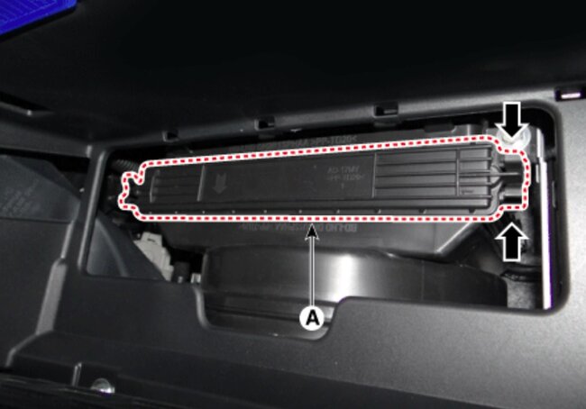

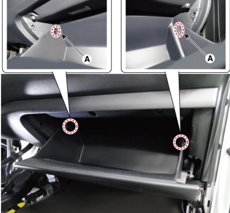

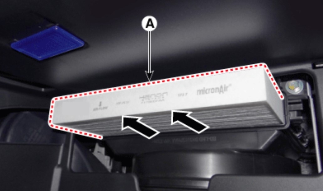

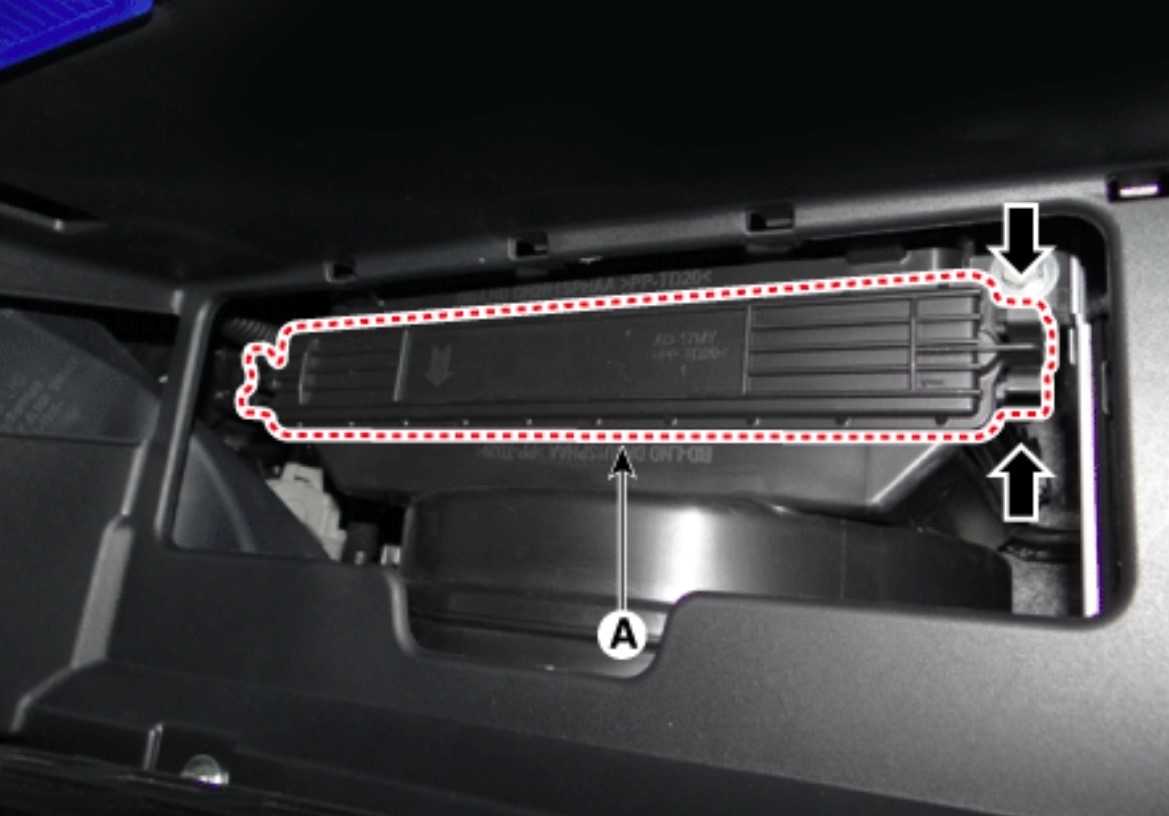

Yes they can get into the inlet side, but then they hit the cabin filter which means they can't get inside the car itself. Most cars have an inlet screen on the outside as well that blocks larger items. Others don't. Easy way to tell would be to replace the cabin filter. It's behind the glove box. You empty the glove box out, then remove the two stops from the holes and disconnect the damper on the outside. Then drop the box down and release the clips on the cover. Now look at the filter for the airflow direction. Then remove it. Look it over for any damage or signs of critters. Install the new one with the arrow pointing the correct direction. Install the cover, put the glove box back together. Throw out the 2-year-old tootsie rolls, and leaky pen (lol) then enjoy. FYI if you can find them, they make a carbon filled filter for many cars as well as baking soda ones. I use those rather than a stock filter as they can help if you go through areas with dubious air quality. I used to drive past a rendering plant and in the summer, it got really bad. The baking soda one helped with that.

Okay, I have a 2022 kia forte LXS and i routinely check my cabin filter and motor blower and all clear. As a matter of fact, my filter has an arrow pointing down, so I inserted it as directed. I was just worried a wasp could get into the A/C vent somehow via the cowling or through ducts in the engine bay. Also where is most common for daubers to build nests in cars?

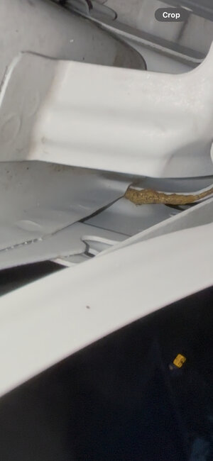

Okay, any idea what this is? Found in the crevice near hood hinge. Propped up hood and looked in crevice and saw and it’s on both sides same spot.

If you mean the brown stuff, that is factory seam sealer. If you were to strip the car down and pull the paint off you would see that all over the place where the various body panels are put together and they want to stop moisture from getting in the seams. That is just an area where they didn't smooth it out real well.

Oh okay, that's a relief I thought it was a big nest of some sort I was worried.

Nothing to worry about with that stuff. It's pretty much like caulking the gaps and cracks on your house.

Just weird because I don't see it on my car and I have a black 2022 kia forte. Maybe they do it in the newer 2023 models? Because that's my grandma's car she has a 2023 white forte.

They have used it since the 1940's when all steel bodies became the normal thing, but some folks are better at not making a mess with it or applying too much so it squeezes out like that. You should see cars from the late 70's through the 90's there would be globs of it and places where they forgot to place any, then other times it looked like they applied it with a 4 inch paint brush. I've looked at cars on the lot and it's amazing to see the differences on "identical" vehicles.
