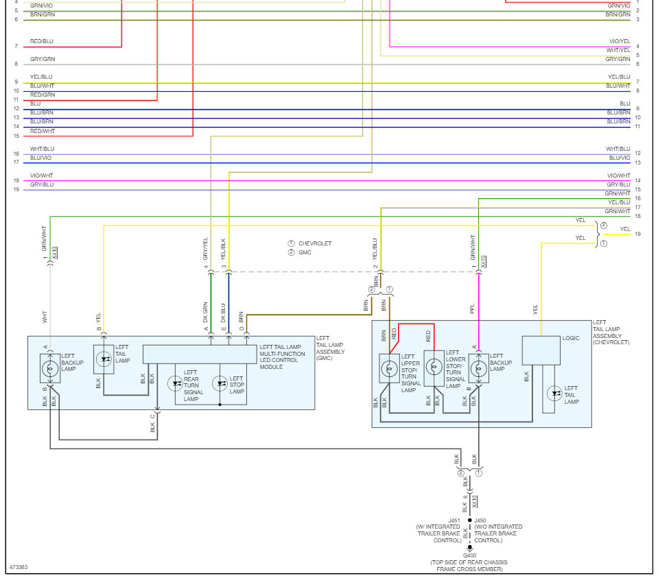

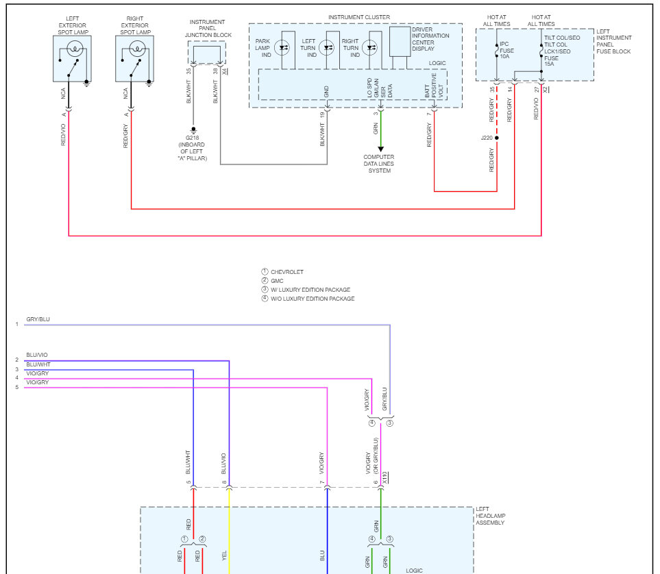

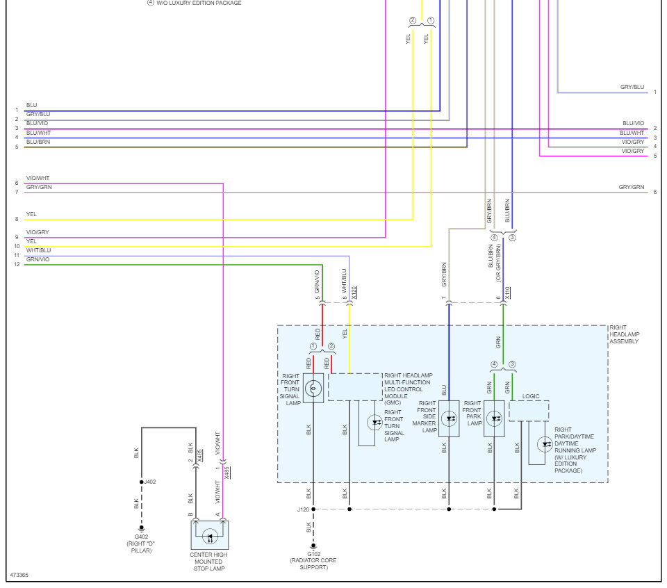

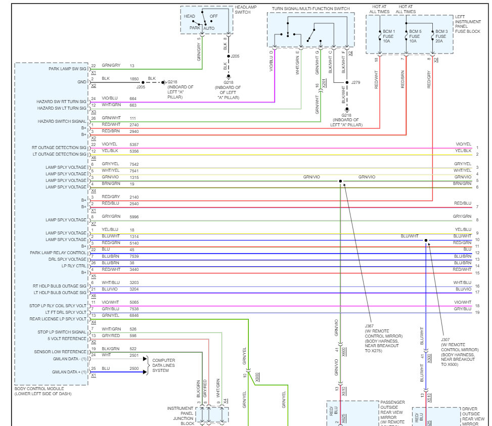

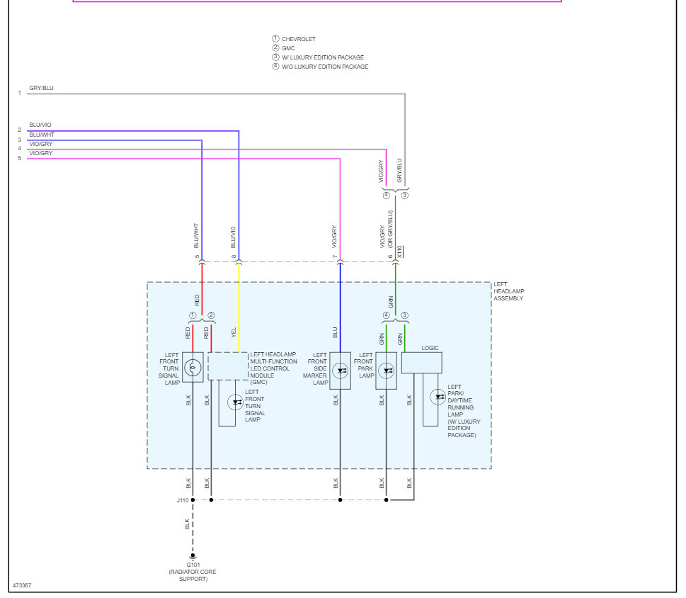

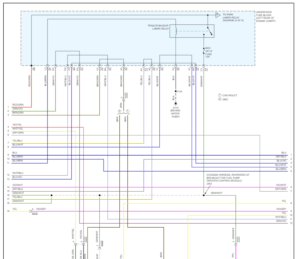

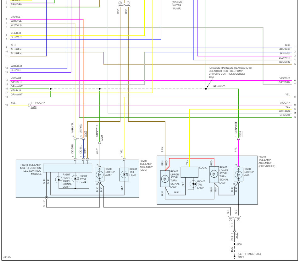

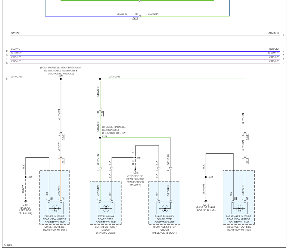

This vehicle is a Denali, so it has all digital lighting. Right directional start off normal then speeds up.
Apr 15, 2023 at 5:11 AM
  • 110,248 POSTS
Does it do it regardless of the direction? Also, if the light speeds up as you mentioned, that is an indication of bulb failure. Have you checked to see if there are any not working?
Apr 15, 2023 at 3:07 PM
  • 55,710 POSTS

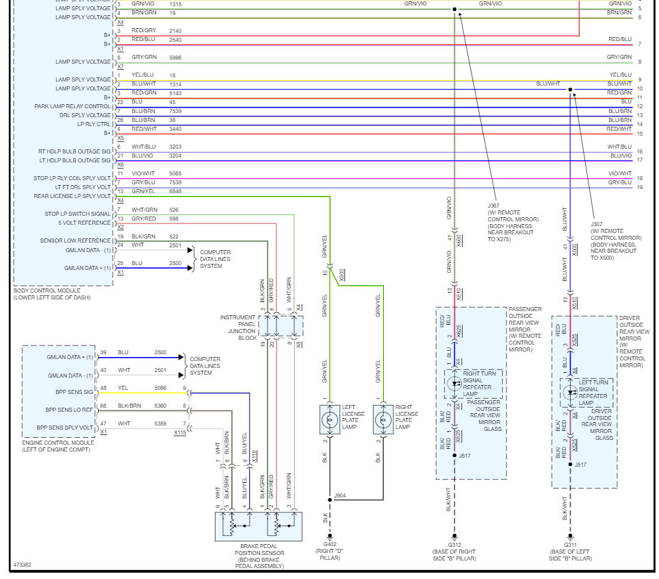

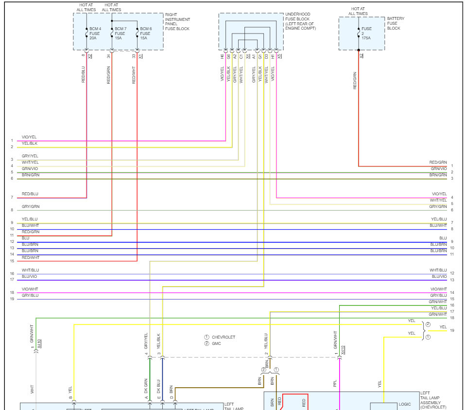

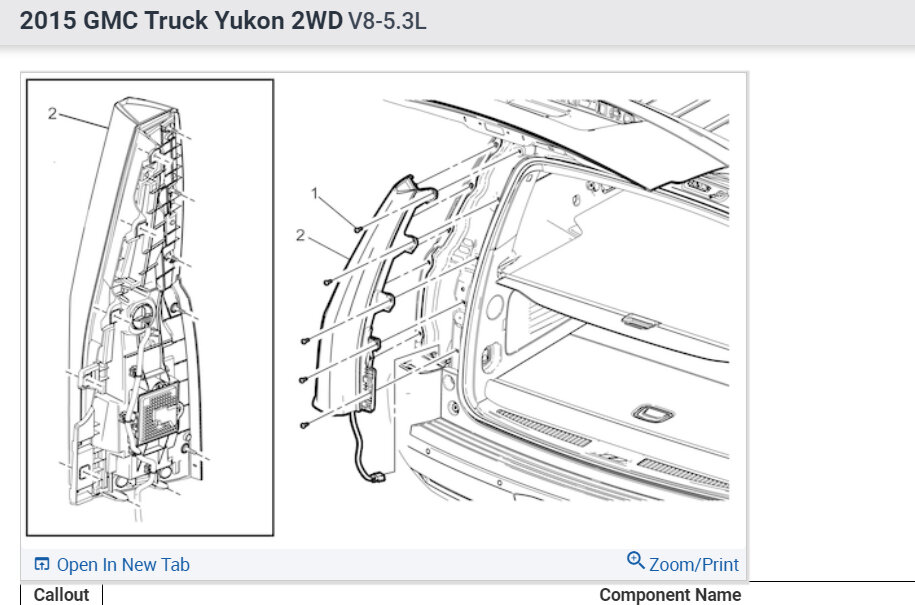

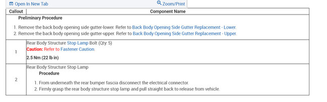

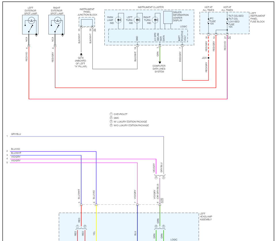

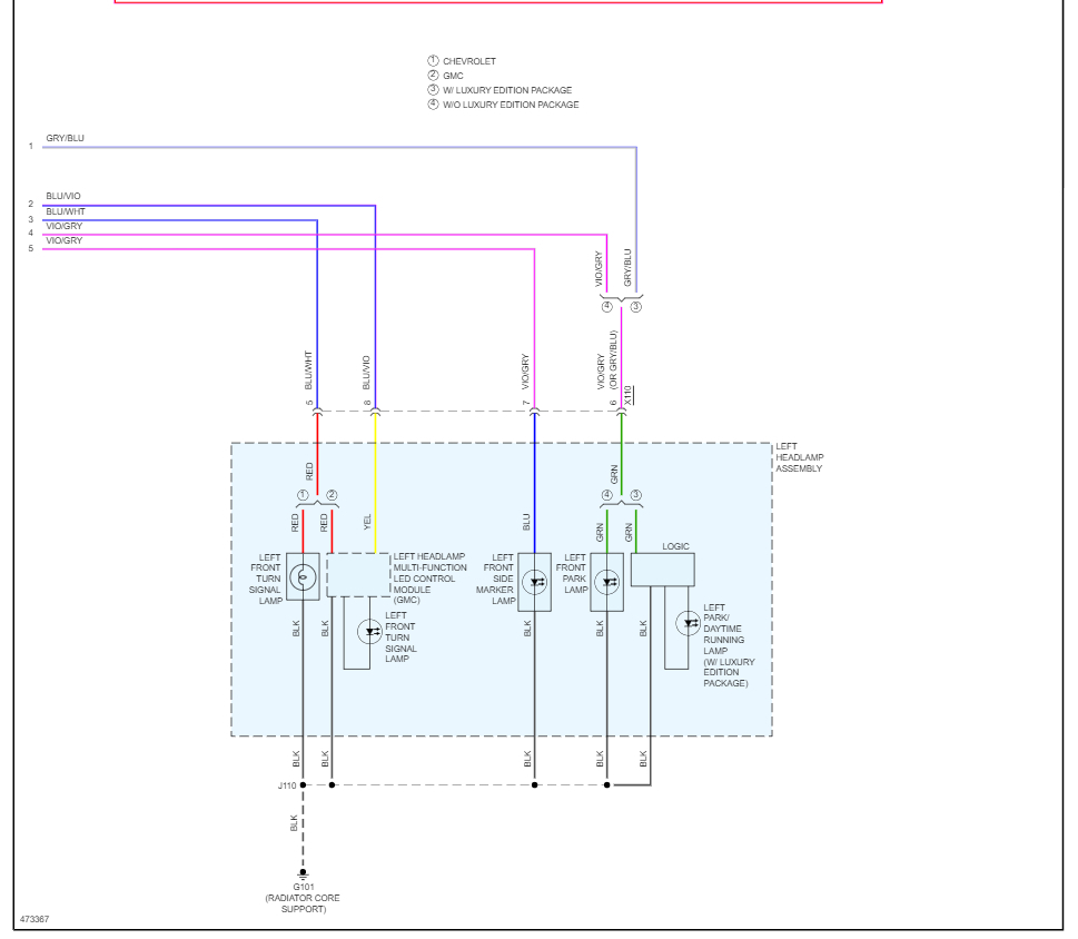

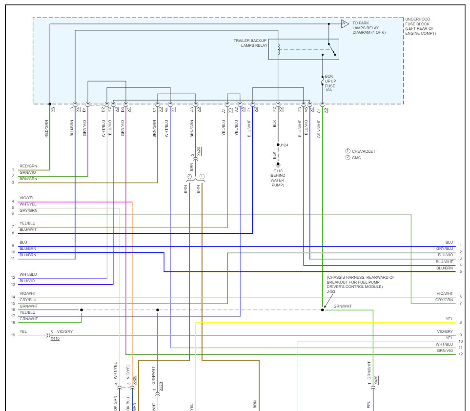

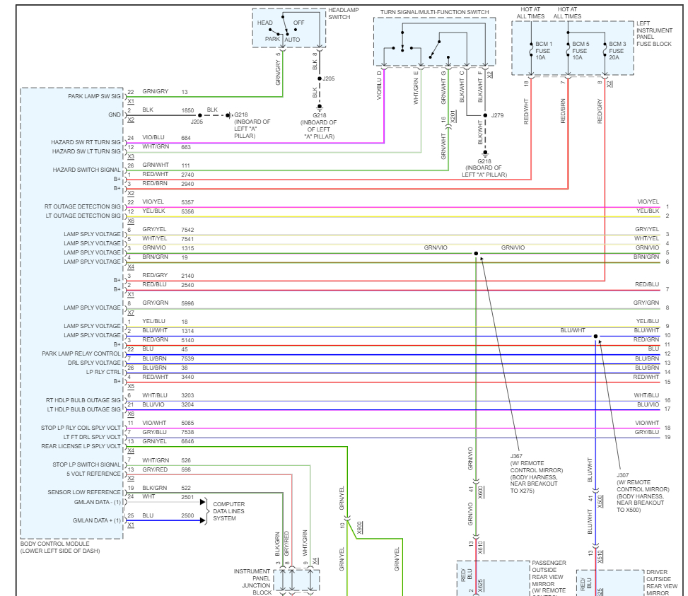

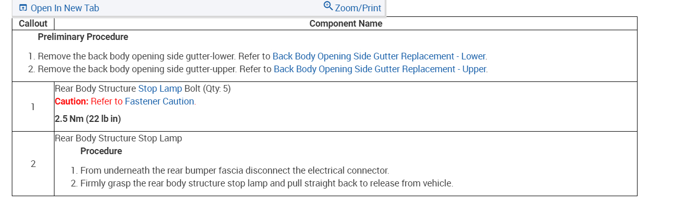

With the blinkers going can you check to see if the front and rear directional LEDs are working? Chances are you have a right rear LED control module that is out and needs to be replaced. Here are the blinker wiring diagrams so you can see how the system works. Here is how the LED module is replaced in the images below. Check out the images (below). Please let us know what happens.
Apr 16, 2023 at 11:12 AM
JAUTO1
Thank you for the quick reply. All the LEDs are working. I'm getting the vehicle back this week. I'll stay in contact.
Thank you
Apr 16, 2023 at 11:32 PM
  • 55,710 POSTS
Sounds good, it might be the BCM that is going out.
